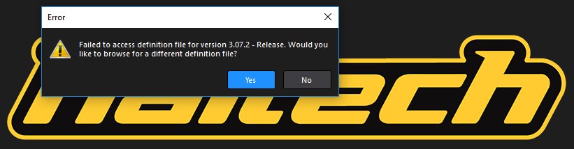

    On another note, I found some Haltech tunes in this thread to compare against. What do I need to do about this error when trying to open them?

    Usually when it's missing the definition file it's because they removed that version because it had errors in it and they didn't want people putting the firmware back on that ECU. But sometimes it's just because your install of NSP is so fresh it hasn't reached out to pull down all the definitions yet. Make sure you're connected to the internet and then do the NSP update option and wait like 30 minutes

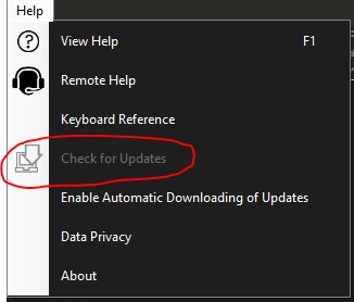

    Hmmm... for some reason the update option is greyed out.

    That's a pretty old tune if it was on 3.07 anyway, chances are it wasn't very nailed down. Try to find something 3.10 and up and be wary that everything you see posted in here is about sharing knowledge and experimenting and we're all always iterating and changing what we've done. A lot of the maps posted in here from a long time ago had too much timing and we've since discovered on the dyno with knock monitoring the 5VZ reaches MBT much lower and subsequently removed a lot of it.

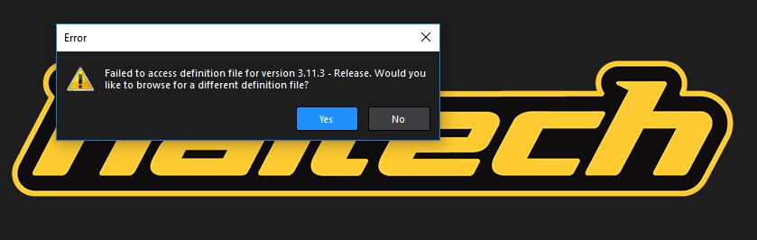

    I still seem to be getting the same error with a 3.11.3 that was uploaded by Trey a few months ago.

    Never mind, I completely uninstalled the NSP software and reinstalled it, and that seems to have fixed it.
