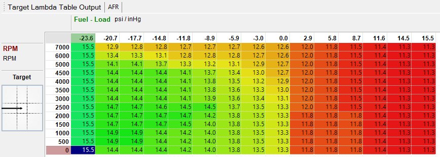

    Damn that is a rich map.

    It's less Tacoma and more mod
    Yes it is, that's why it is the safe map. Good starting point to clean up yourself in your cruising ranges though, wouldn't take but a couple drives with a passenger to take it out and make it your own.

    Care to post a dialed in map?
    I hesitate to since everyones situation is different. I'll post a map that's still rich (because leaning it out further resulted in poor behavior) but different due to differing setup and forced induction. But I'm in the shop right now, so remind me if I forget.

    If you think that's rich.....
    Mines even worse. 11.7 at 0-2 psi rn.
    Purely because I have a ping I'm chasing in that range, but still.
    Every ones situation is different, different motor, different forced injection, etc..

    Stock computer is excellent about retarding ignition angle when any knock is heard, that's its only method of fighting spark knock. It has no knock enrichment logic.

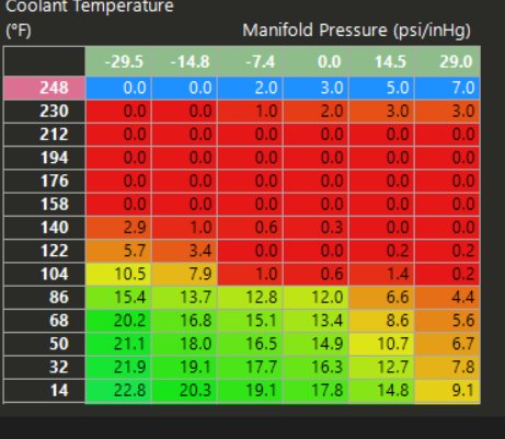

    This works for this build because of the slow boost ramp and there is a correction table for lambda that biases engine and intake temp to make a percentage change to this table so it cannot be used as an absolute on its own

    No I am not running this map, this from another truck I have worked on. Again, this map isn't absolute, it changes depending on temps due to the applied correction table. This map would work fine on an NA truck though, it just wouldn't use any of the positive pressure cells.

    I'm not using the air temp correction table though. Just coolant tempt correction.

    Are these percentage increases or..?
    Sorry, haven't dipped into my Haltech yet
