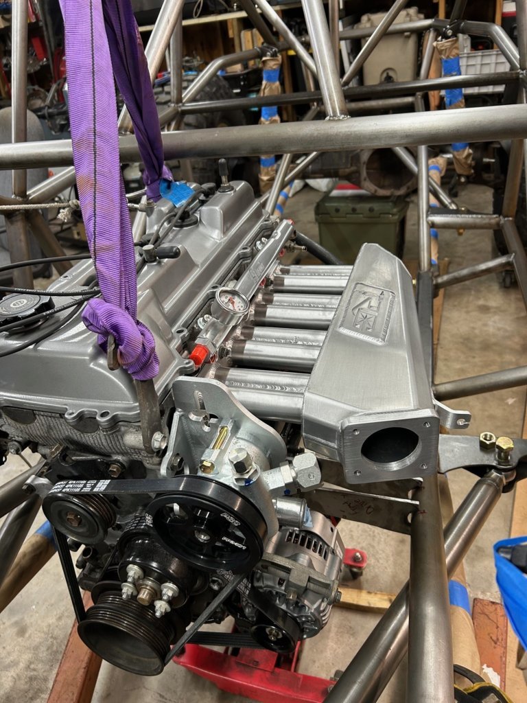

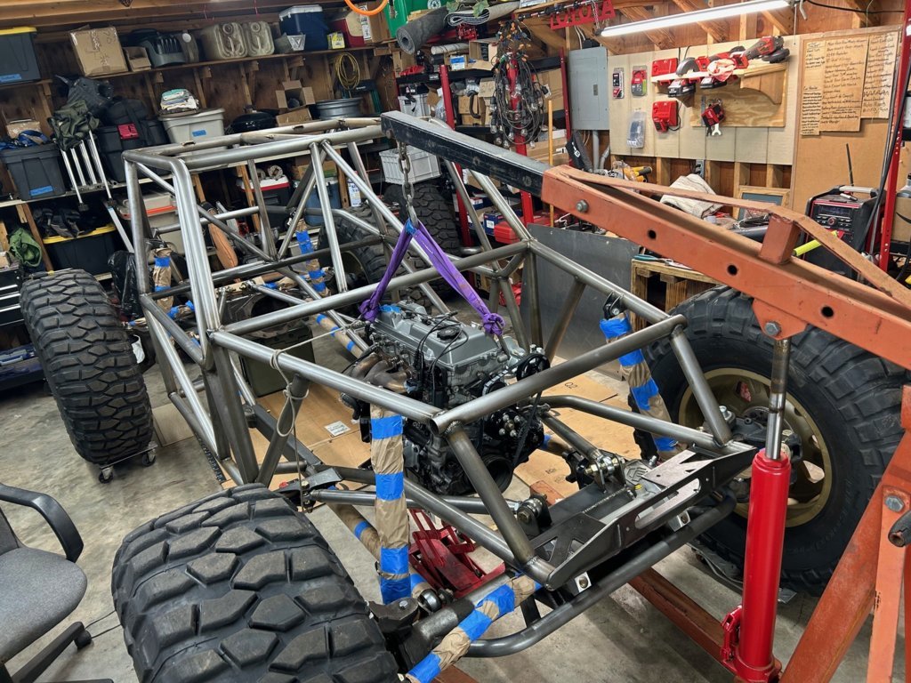

    Id like to thank all of y'all for contributing to this thread. I have been slowly soaking a lot of this in.
    I recently picked up an Elite 750, IC-7, WB-1 and SNP stand alone harness for the 3RZ I'm cramming into my new rear steer buggy build.
    Goal is to run some boost with a GLFab turbo manifold, 3076 Pulsar Turbo, 750cc injectors.
    Just getting the 3RZ and A340 mocked up now. I may have some tuning and newb questions in the coming months.
    Pics of the project:
    treyus30, unstpible, Jon64l and 2 others like this.

    FCQM+VG Cheney, Washington
    It's less Tacoma and more mod
    Looks fun! We have that exact same setup (minus the SNP harness and snazzy intake) so if you need anything let me or @2RZNoShi1 know and we can certainly help you get it all setup and dialed. We've seen some other folks with SNP full harnesses be miswired unfortunately and in some cases poorly crimped as well. If you have the pinout and wiring allocation sheet you should verify continuity now so there are no surprises later.

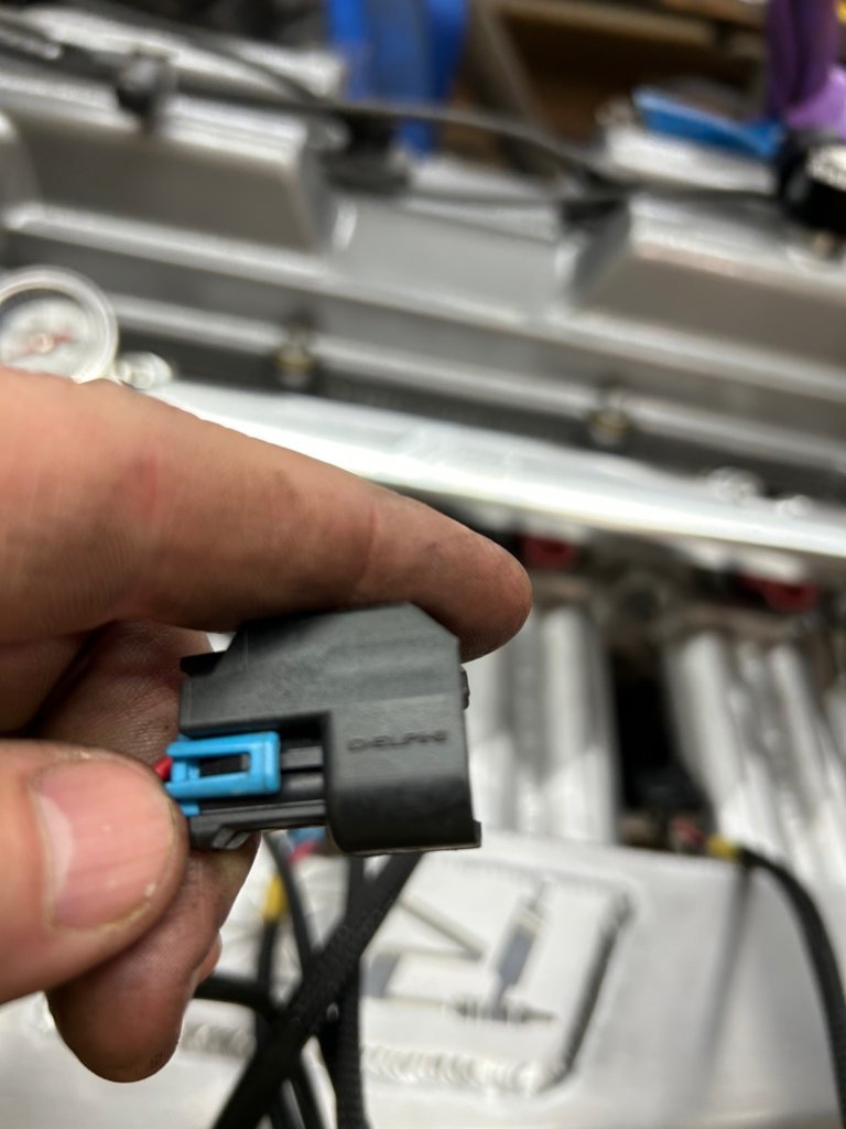

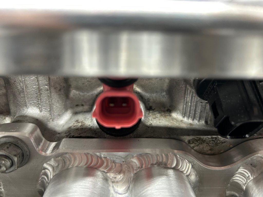

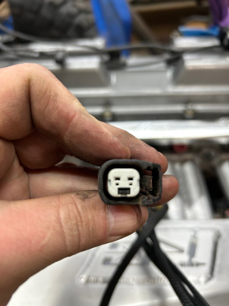

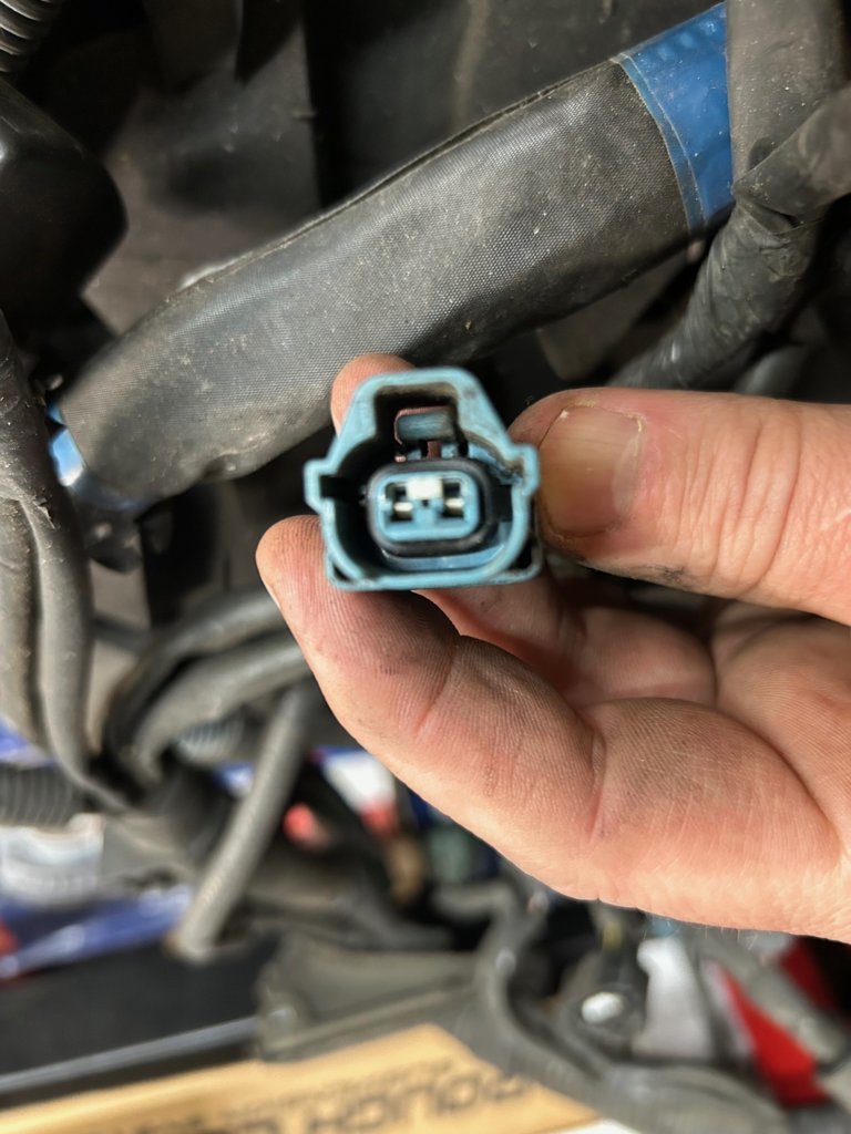

    I picked up the 750, WB1, and IC7 harness second hand just ever so slightly used and working according to the seller. The fuel injector plugs look to be an EV6 connection. The 750cc injectors I want to order from SNP are the ND/Toyota type (standard pink top or the brown OEM version). It looks like the outer covers on the SNP harness can be unclipped and swapped to the correct ND slot type. Guess I need to call SNP and ask or maybe some of y'all may have an answer.
    OEM Harness injector plug
    Fits this Pink top
    Injector connector on SNP harness

    Speedytech7
    Feb 20, 2014
    #123587
    57,808
    Ah yeah there's plenty of conversion harnesses to go from EV6 to ND if you wanted to do that I think you can get 4 adapters for like $5 on eBay. But you could also just splice in new ND connectors with flying leads if you don't have the crimp tool for their pins. I would skip ordering those injectors from SNP, you can get appropriate ones from FiveO motorsports and they'll come with all the data needed to configure them as well in the Haltech.
