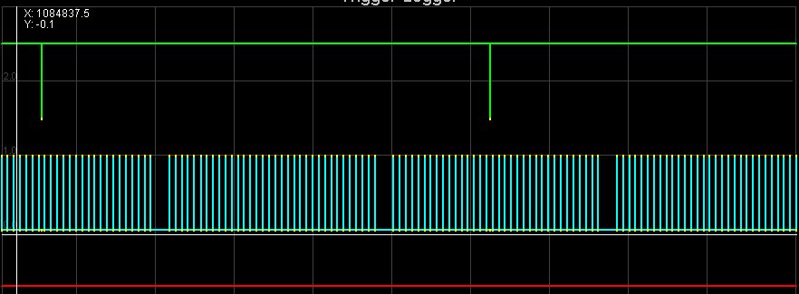

    Hey guys, just wanted to circle back on some of these points for some updates now that I've been running the rusEFI unit for several weeks now.
    I've been running sequential injection with no problem. The onboard MAX9924 VR conditioner doesn't seem to have an issue with the shared grounds between the crank and cam sensors. I had to do no modifications to the stock sensors or any splitting of grounds. Just enabled cam sync in the trigger settings and switched to sequential injection no problem.
    Trigger log
    Green is cam
    Teal is crank
    Red is trigger error, which is flatlined at 0 errors
    I have yet to experience this. The guy who is having this issue I'm quite certain is being caused by some wiring issue on his end.
    Closed loop fueling using the 0-5v output from the AEM into an aux input on the rusEFI has been working great. I made sure that my AEM wideband is grounded to the same location as the stock ECU and the standalone (at the plenum) to hopefully prevent voltage drift issues. I'm toying with the idea of adding another wideband sensor for the rusEFI controller to use, and keep the analog output from my AEM sensor as a backup in case a sensor goes bad. For redundancy sake.
