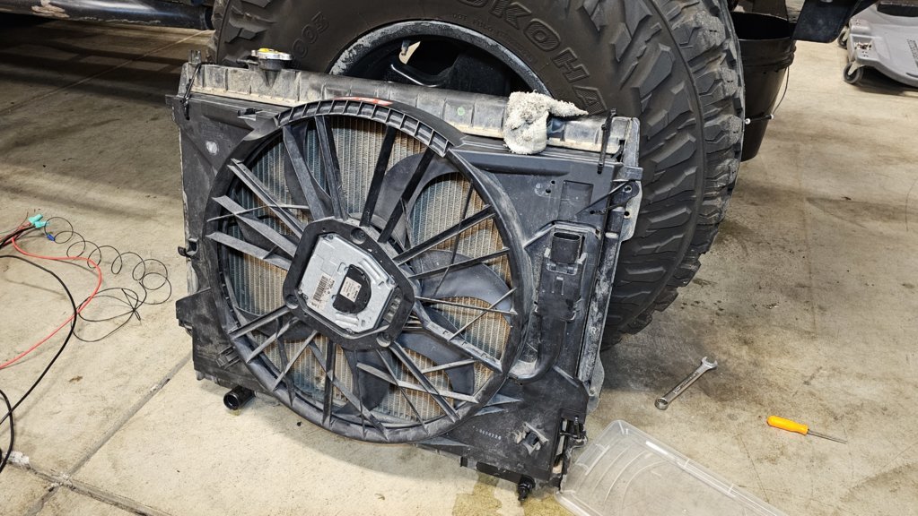

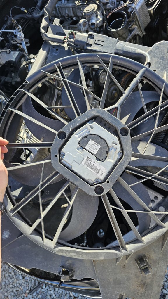

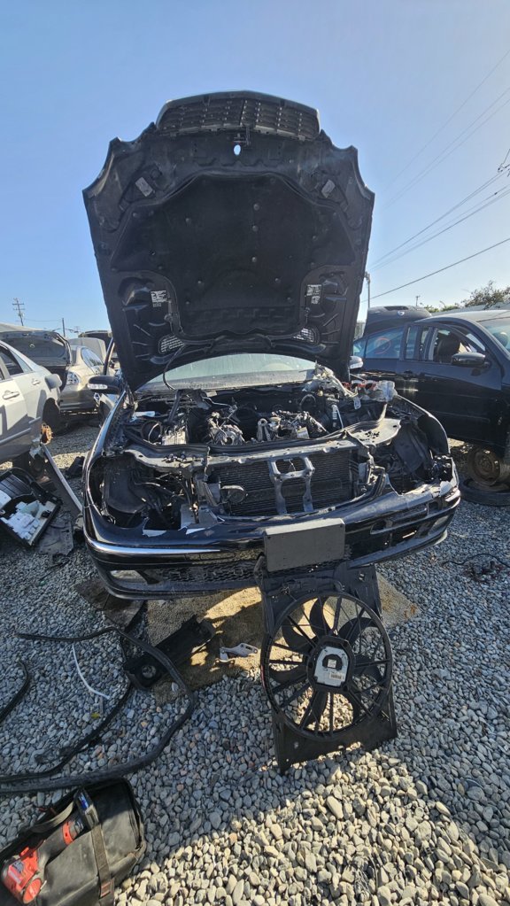

    Picked up an efan off a 2006 e350 that I'm gonna try and retrofit to work with my 3rz. Sizing worked out to be pretty close to stock core size and has integrated bosch pmw module.

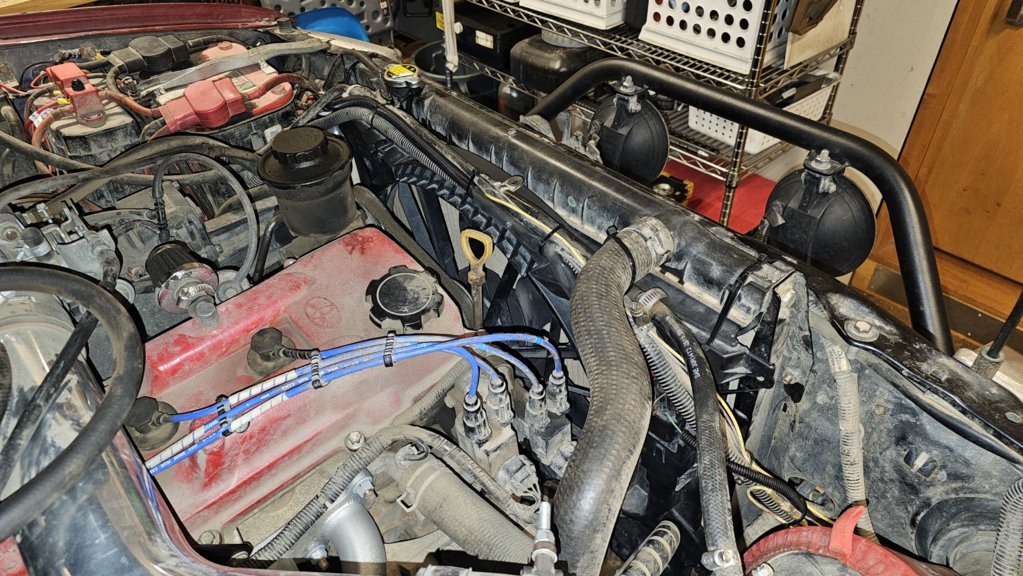

    Well didn't expect to get it installed and running tonight, but it went together pretty easy.
    Can't believe how good of a fit it ended up being.
    Pulsing at 128hz. The duty cycle settings are backwards from normal, but in reading around online that seems to be the norm for these. 10 is full speed and any more than 85 is off.
    Need to give it some drive time and see how it handles the coming summer temps.

    oh no! it's backwards!
    jkjk
    Is 85% actually off, or is the actualized current just not enough to get it spinning? If the latter, you's save some parasitic draw by just making it 100.

    That would be a pretty hilarious fail if I got it installed and it was blowing air out the front of the truck.
    I believe it's just not enough to get it spinning because when I had in on the bench you could see the blade just barely twitching at that DC. I should add another column below 180 to scale up from 100
