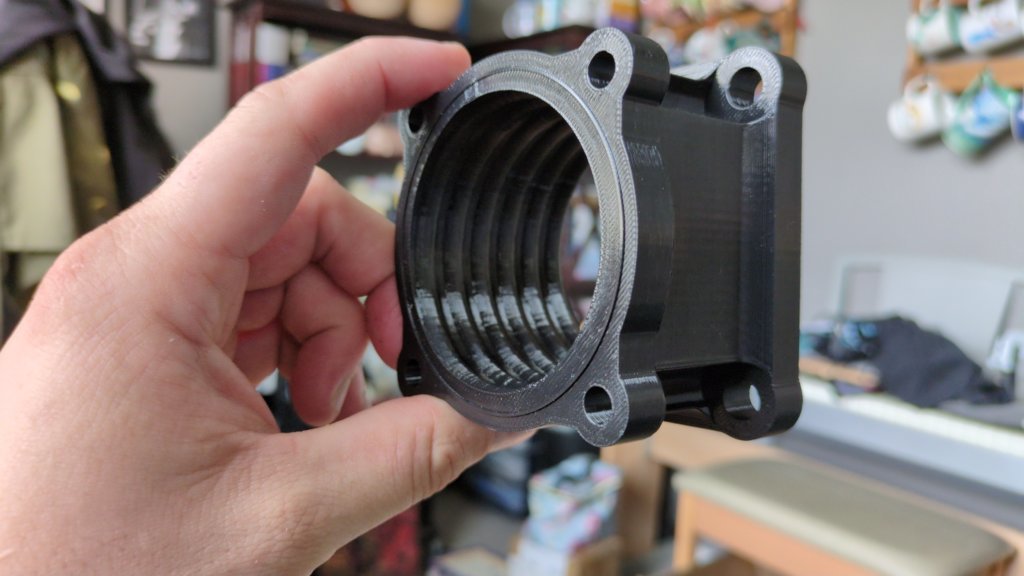

    I have some vacuum leaks from the sandwiched spacer-adapter I had made for converting the Bosch 60mm e-throttle to the factory intake manifold, and I just acquired a new P1S 3D printer the other week, so threw this together from the template I already had and thinking I'll grab some PA6-CF if this PETG prototype lines up and run it instead. Threw a large thread on the inside because why not try to add a bit of turbulence since the entry point right before it is a 90* turn.
    unstpible and Speedytech7[OP] like this.

    Ribbed for its pleasure. If you're gonna run an abrasive filament like PA6-CF be prepared with spare parts for your machine just a heads up.

    I got the 6mm hardened steel nozzle as an add-on so I'm ready to go :thumbsup:

    Kills your feed gearset too, try your hardest to dial the feed and retract amount perfectly if its a long print because knocking on those filaments dulls the brass pretty bad
