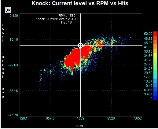

    Hey Trey, where did you land with knock monitoring? You get the thresholds dialed in? Are you using stock Toyota sensors, beefier GM ones, something else like an external Bosch?
    I've just started playing around with logging the feedback from my stock Toyota ones. Looking to start diving into this a little more soon.

    Wow you dug up an ancient post haha
    I ended up putting in wideband Boschs a few months ago and just let it go with the map defaults. I was just telling Zane I really need to figure out the proper thresholds and this question of timing being the issue put to bed

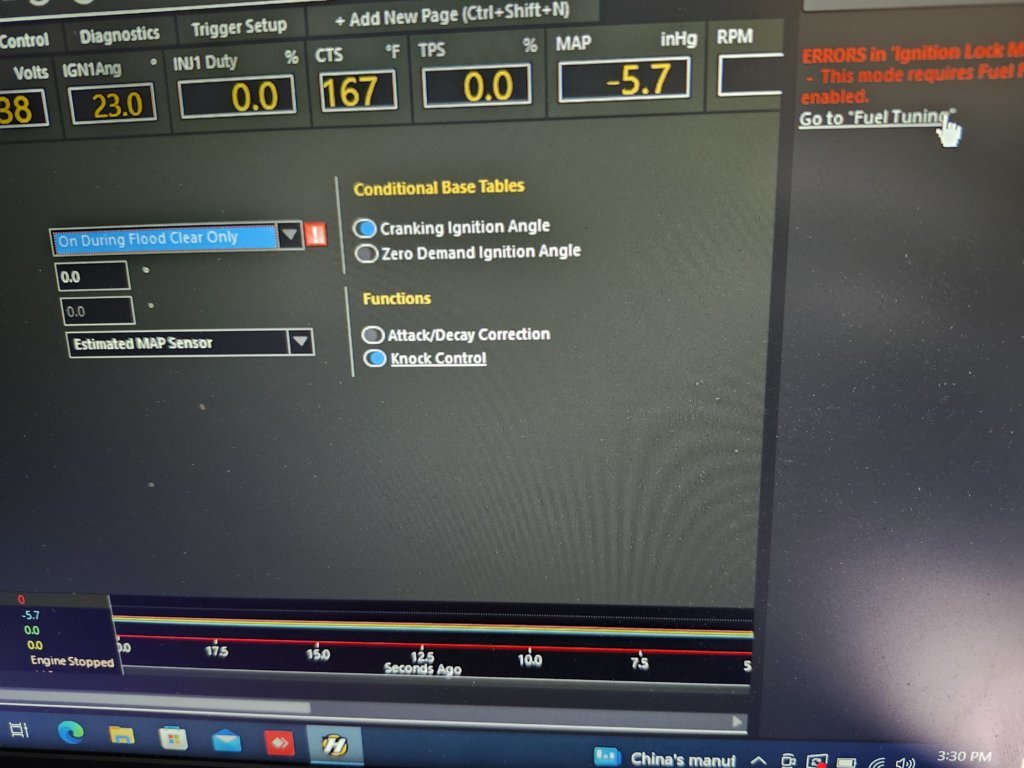

    V6 5sp,RegCab,TVS1320 Supercharger, 56mm pulley, methanol injected Haltech ECU, AC Tvs1320 supercharger,(MUST DO) every 125,000- 150,000 needs rebuild Projector headlights HID 5 speed manual Amsoil for all drive train Smaller 56mm custom pulley, (MUST DO) 2004 DESNO fuel injectors, zero ping ping, 2004 side door mirrors Dick Cepek Rims, Michelin tires LTX, ATM Pathfinders Dynopro ATM ( that last 100,000 miles) Now running Dynopro ATM mud and snow tires KN cold air intake Cat back dual exhaust with ss exhaust tip, Raised exhaust tail pipe to 2" below body line Optima*dry cell battery,red top Alpine sirius radio, 200 watt amp, focal is165 split door pod speakers Focal door speakers Subwoffer behind seat Viper alarm, Electric Locks Dark tinted windows, bucket seats corbeau lg1 Tacoma Rubber floor mats TRD fender extenders, Bilstien shocks, King shocks JBA UCA trailer iv hitch, electric brake control, Drilled slotted brakes, High carbon steel (MUST DO) EBS green stuff 7000 series pads(MUST DO) TRD engine oil cap TRD stick shift, Marlin crawl shift kit. Rear sliding window 2002 4Runner functional hood scoop cut into Tacoma hood, 4Runner dual overhead map light Gentex Auto dim + Compass + Temp, garage,rearview mirror Snow Methonal kit stage 2 Custom 3 core aluminum radiator Linex bed liner Haltech stand alone ECU, Intake supercharger gauge. Stainless steel brake lines, Custom leather wrapped steering wheel, Haltech stand-alone ECU,

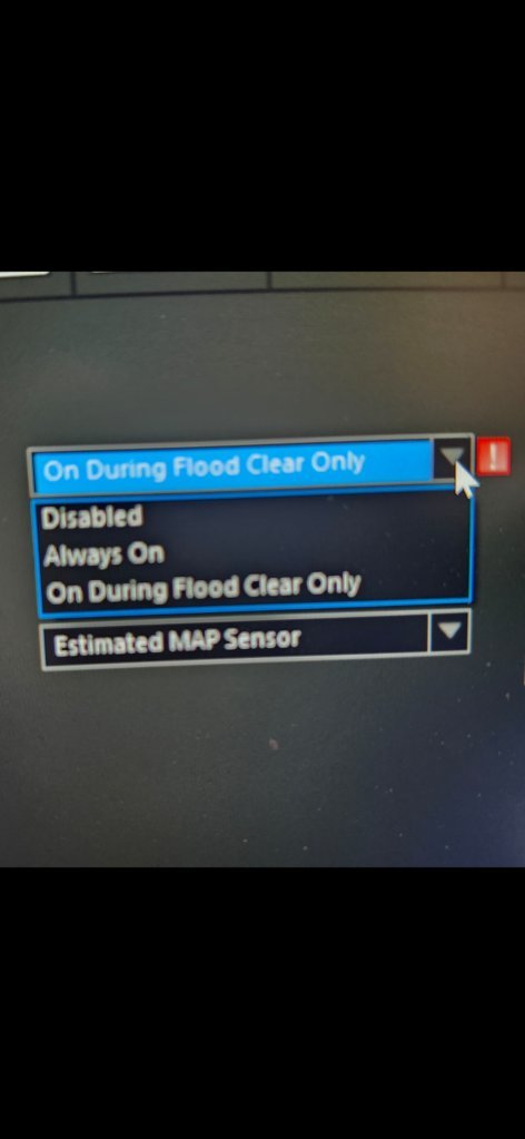

    Question if anyone can chime in,

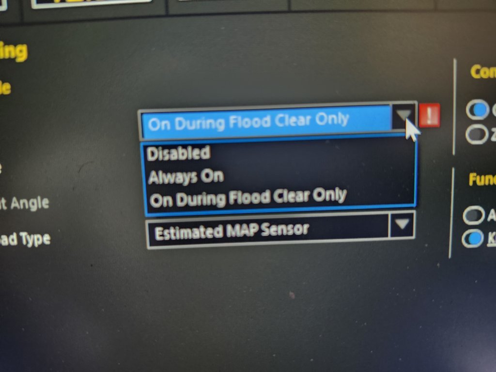

    I have an error coded in the trigger voltage section, it's referring me to the, it's saying to change the on during flood clear only, what drop down should be tagged?
    1)disable
    2)always on?
    3) on during flood clear only = throws a error at the top of the page as shown ,
    It's having a random trigger error at 4900rpms inconsistently,
    And or what drop down is being used ?
    Thanks in advance

    I have that set for disabled in mine. Not sure why you would want to lock the ignition angle like that. How was it previously configured?
    I doubt the trigger error is related to that. How old are your sensors? Do you have your trigger ground wires separated?

    You can usually just leave ignition lock mode set to disabled. As far as the trigger error at 4900, it's likely due to the cam and crank wiring and the combo of settings "some people" like to use to bandaid the cam and crank ground splice in the factory harness.

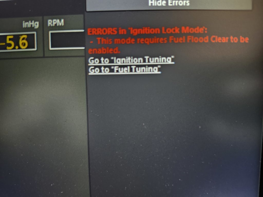

    The error on your ECU is because the fuel flood clear mode needs to be on in order to have it on for the ignition, you can't have ignition set to on while the fuel flood clear is off.

    I have flood clear mode on, but dunno what ignition lock is

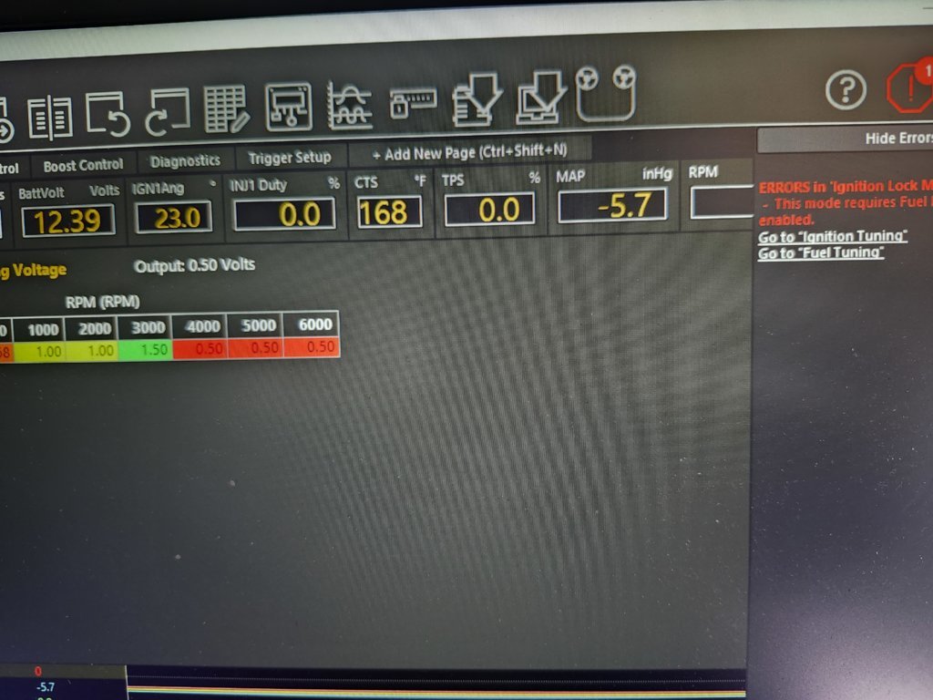

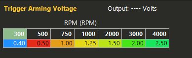

    Also..why are his trigger voltages going the wrong way? A Gabening?

    I’ve been having trigger errors off and on for a while, new OEM sensors = no change , I’m sure my issue is related somehow to the stock wiring.
    Trigger wires grounded separately? No,
    How is this done? Or a write up?
    Will switch the default to disabled thx

    Definitely gabe. that's how mine was

    I would recommend separating the grounds. I did and it helped. Settings will have to change to accomodate though.
    Disconnect the ECU plugs and pull the harness through the firewall into the engine bay. Easier to work in there. Strip back the sheathing to expose it and then just remove the splice, reconnecting the respective colored wires.
    I would leave the ignition lock to disabled. Like @2RZNoShi1 said you don't need it. That won't have any affect on trigger errors or signals.

    Here are my voltages without separated grounds (been running without trigger CELs for a while now):

    I think it’s all related to the wire harness or grounds, that voltage going the other way sets off triggers everywhere, this setting was the closest with little to no triggers, going to have to address the grounds or wire harness next when I can find some time

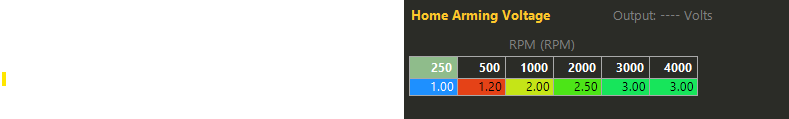

    Sounds similar to the behavior I was having before I separated mine. I had similar voltages that were sort of all of the place.
    Once you make that wiring change, turn both trigger and home to ground reference on and then home signal to falling edge.
    1997tacomav6[QUOTED] likes this.

    Thx, did you set the home voltage adjustment 1st and then trigger voltage? And fine tune the voltage off the trigger section?

    They're independent so not sure I did either first, but the onboard oscilloscope works wonders for determining the noise floor at various RPMs. Set the trigger to maybe 1/4 to 1/3 between the noise floor and peak voltage to start.

    You are one of the lucky ones. Some rigs run with the splice and cam and crank run into their respective grounds with no issues. Its not the correct way to do it at all, and usually hits a point where it no longer works. Can either run cam and crank grounds to sensor ground, and set the settings accordingly, or take out the splice and run them to their own grounds. Those are the two correct ways to set it up.

    Would it be wiser to have new camshaft and crankshaft wires made that run directly to the sensors from the haltech then?
