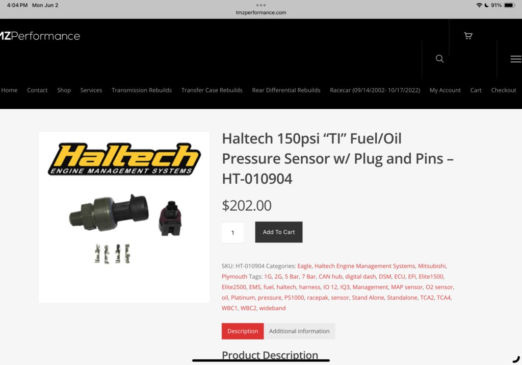

    Oil Pressure Sensor
    Has anyone here installed an oil pressure sensor and run it off the haltech can gauge?
    And if so where did you tap into the block for the sensor?
    And what sensor did you use?
    I know haltech makes a universal fuel/oil gauge that goes to 150 psi
  9. Jun 2, 2025 at 3:11 PM
    #2769
    Speedytech7
    Feb 20, 2014
    #123587
    58,147
    FCQM+VG Cheney, Washington
    It's less Tacoma and more mod
    Yeah installed one on a 3RZ, same principal applies. Use the stock oil pressure sensor hole, unscrew it and screw in a 1/8npt brass street tee and screw your new sensor in the other port. I just used a 0-100psi sensor from low dollar Motorsports, but since I now know they can get over 100psi on cold starts I'd use this 0-150 in the future
    https://lowdoller-motorsports.com/c...products/copy-of-0-100-psi-5v-pressure-sensor
    1997tacomav6[QUOTED] likes this.
  10. Jun 2, 2025 at 3:15 PM
    #2770
    Speedytech7
    Feb 20, 2014
    #123587
    58,147
    Also technically the stock oil pressure sensor hole is a 1/8bspt but like zero sensors exist for that thread minus the stock ones. So if you'd rather use the right fittings you can order this...
    https://www.amazon.com/Stainless-Pr...E0LTVS3&gPromoCode=18226656654608789705&gQT=1

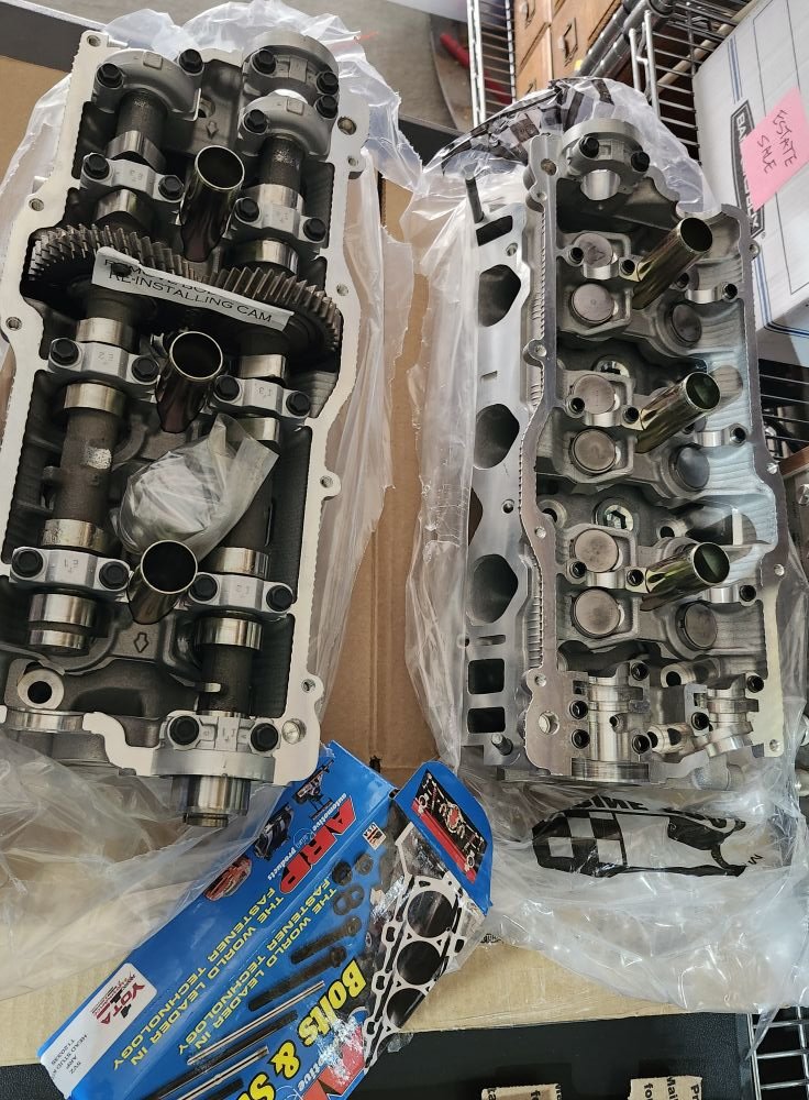

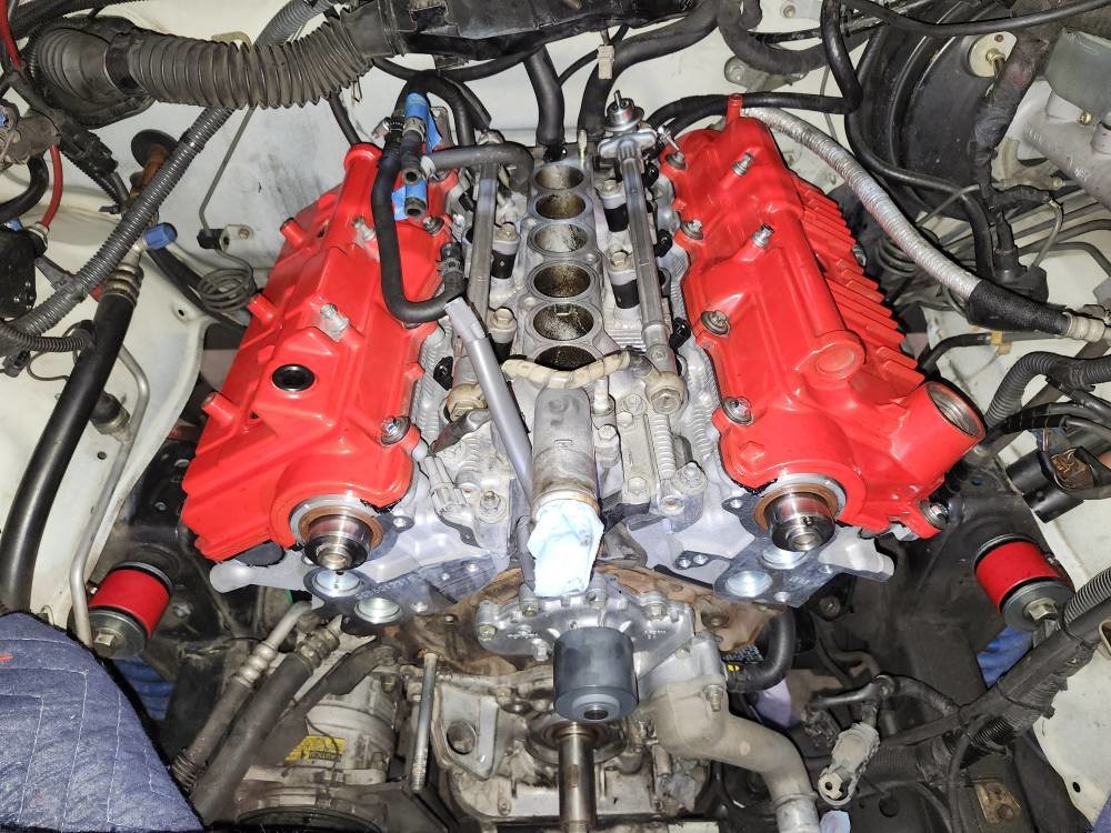

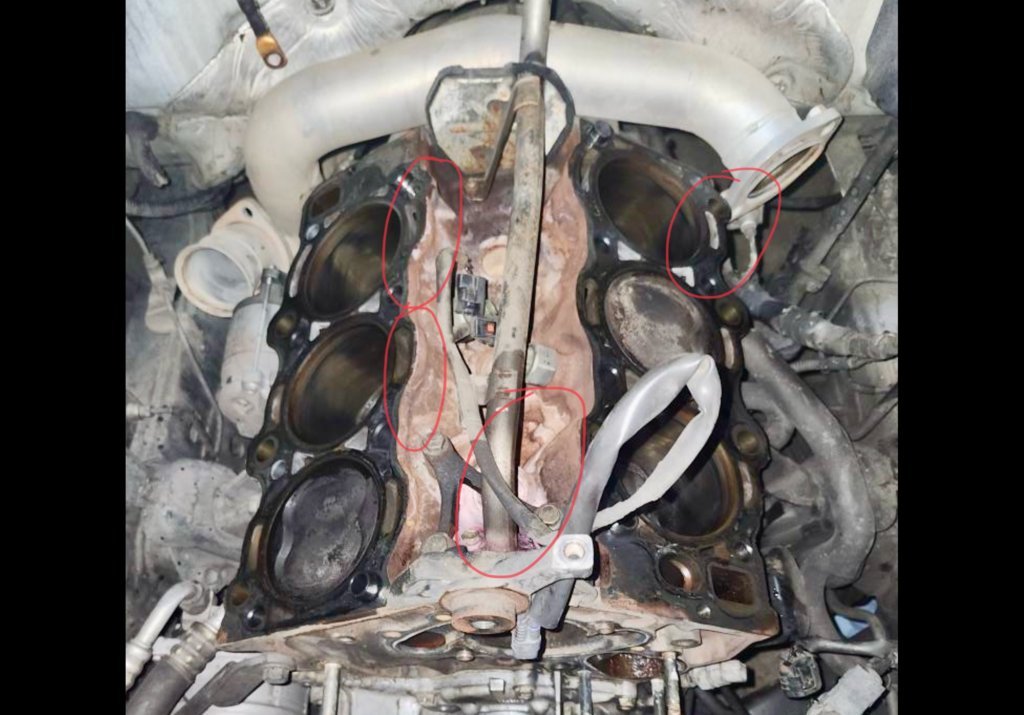

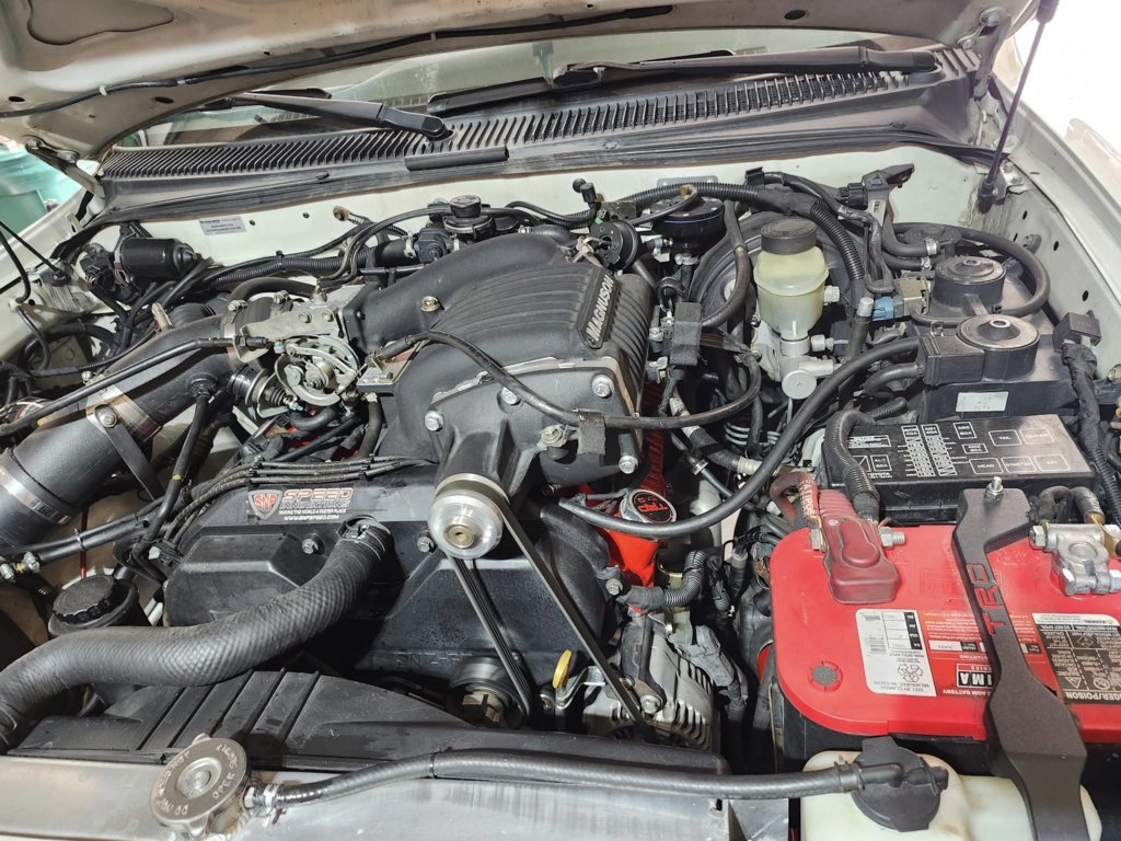

    just a follow up, you asked where the heads were leaking,
    I got new heads and ARP studs installed,
    1) The drivers side head was leaking in between the block and head by firewall.
    2) The passenger heads was leaking at the top seam by the intake in two places. Very small leaks.
    3) The coolant pipe was leaking at the junction, was easy fix with gasket maker and wire brush on the drill for cleaning.
    The ARP I torqued to 75 pounds each compared to the 25 pounds that the stock bolts call for,
    So hopefully this will eliminate any more head gasket leaks and used the copper spray on the head gaskets.
    Got the heads and ARP from yota1 performance ,
    I gain 1.5 pounds of boost with the new heads heads and compression when from 150psi to 180psi per cylinder give or take.
    10,000 miles later running great :)
    and yes I know my radiator hose is on backwards haha
