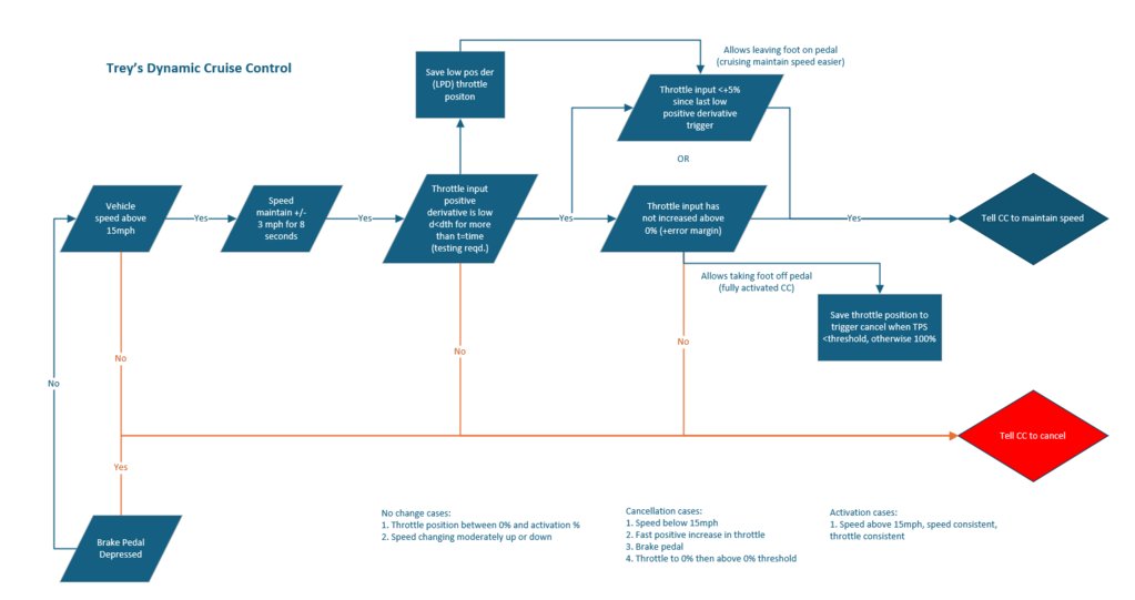

    Just a little thought experiment: cruise control using only the pedals. I'm not sure there are enough generics or timers on the HT yet to try it

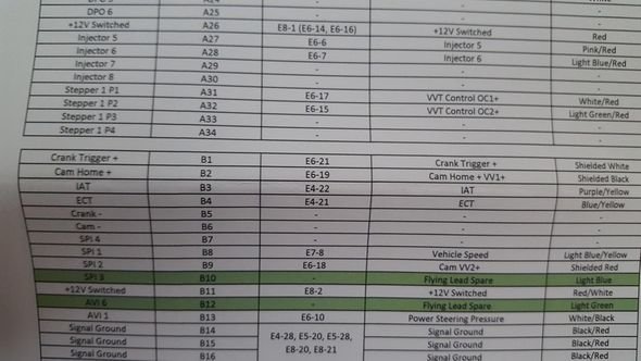

    Alright, so this was weird. With the laptop connected, but engine off and key on, I watched the MAP slowly drift across the screen, from roughly 23inHg, to ~1 psi. Then, engine still off, I pressed the accelerator pedal a few times. The psi raised to roughly 7psi. Started the engine, and sure enough the MAP reading was still around 7psi while at idle. Thus adding a lot of fuel, while at idle. My turbo isn't that small. Lol. Turned the key to off, then back to ON, and watched the MAP raise again to around 1psi.
    Ohm'd out the driver and passenger OCV wires. Good.
    Swapped the passenger vvt cam wire from Stepper P1, to the unused Stepper P3, and reassigned. No passenger cam phasing change to match the target. Basically is stayed at 0 degrees.

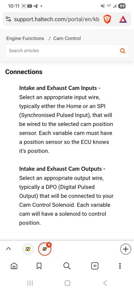

    This sentence got me thinking. Since I was looking at the Boomslang wiring chart last night, and then assigning things on the laptop. Then looking at Haltech's page this morning.
    Here you can see that they had it wired for the Stepper motors.
    But you had stated a DPO, which is also what Haltech says.
    I know it says "typically", but that may be the issue I've had with cam control this whole time.
    ChargedSHOTaco and unstpible like this.
