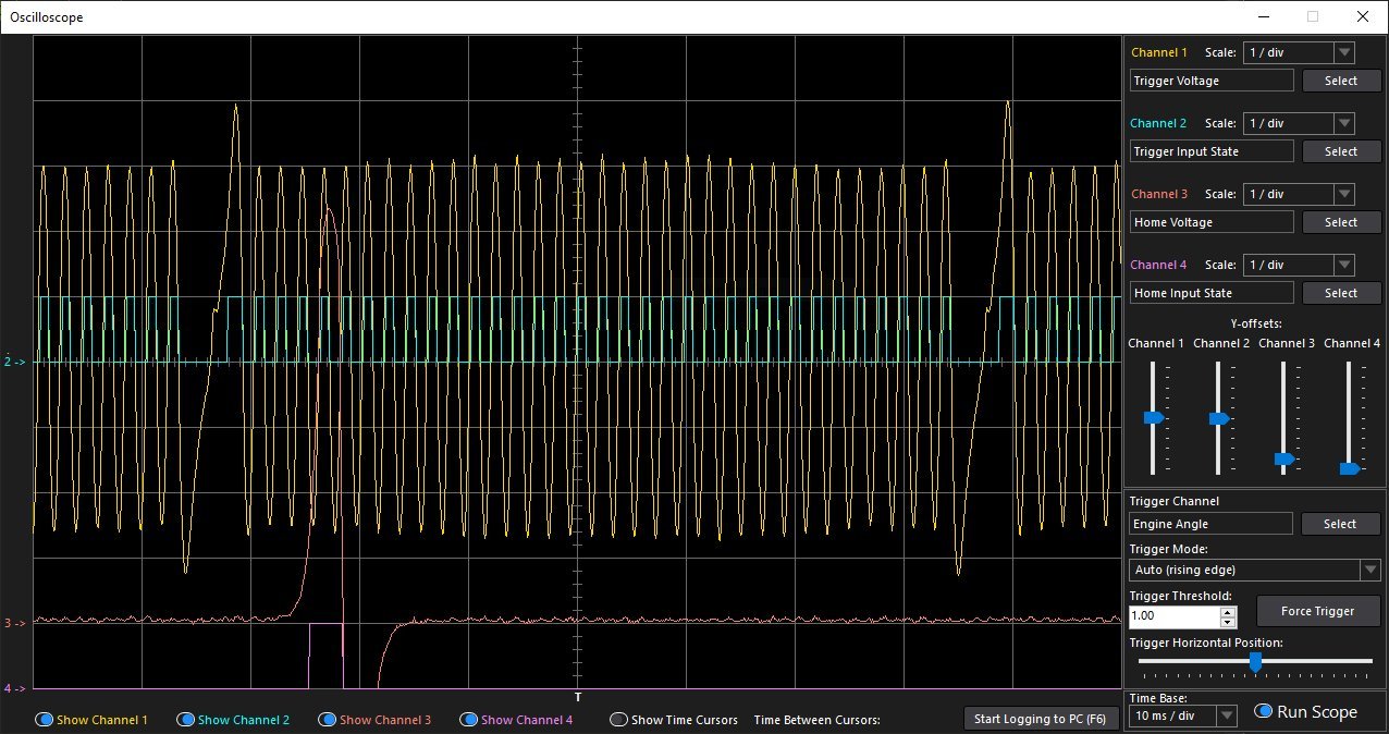

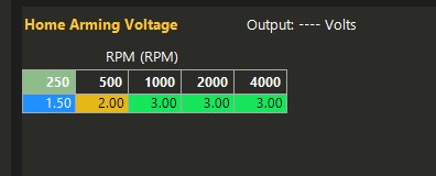

    Just seems really odd. There's no technical reason you couldn't ground to a Haltech ground. If I were rewiring all this though, I would go get an ethernet cable and just use two of the shielded pairs in my harness.
    Crank:
    Cam:
    Their outputs are that different, but the noise floor actually isn't that bad, so you can use fairly low voltages when necessary
    And this should be around 800RPM, for reference. Trigger shows peak about 2.5V, Home shows an astonishing >6V. Higher RPM = larger pulses.

    Even the Haltech separates its ground planes for different things internally. Anyway, you and I think alike, I was going to use some plenum rated CAT 6a if I couldn't find where the pairs were joined. I can take pics later but about 3" further down the harness you can see where the cam and crank signal cables enter into a shielded twisted pair jacketed cable so now I should be just as good as if I had run new cabling.

    It's crazy how much more voltage is generated by the home tooth. That's a nice clear o-scope view, mine had more noise.

    What's crazy to me is I think those little bumps near the 0V level are the timing belt ribs since they're so periodic

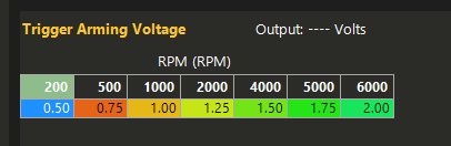

    I ran into that, replaced cam sensor and that helped and was able to up the limiter values. Was able to increase sensor voltage to better values.

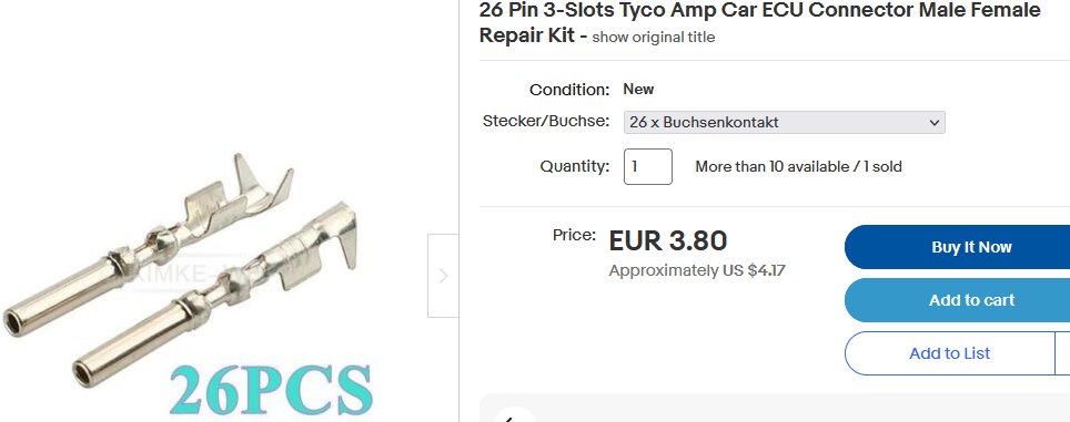

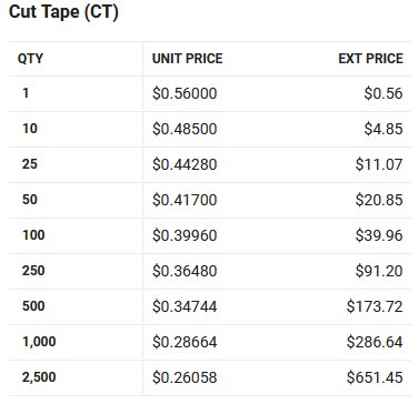

    I didn't look for single items, my digikey cart always has stuff waiting it in for other projects so when theres enough I buy.

    Digikey shipping is usually pretty reasonable. So is Mouser

    I love buying from Mouser but lately I feel like they've positioned themselves from an everything electronics shop to a niche specialty parts shop.

    It's never been cheaper than like $5.99 for me, and I'm pretty sure when I checked on this a few weeks ago it was closer to $10, for an order of 25. So a dollar a piece.. Not good, and that's the price per unit I was seeing everywhere until I found that ebay listing.
    That's my case anyways, the info is out there now..

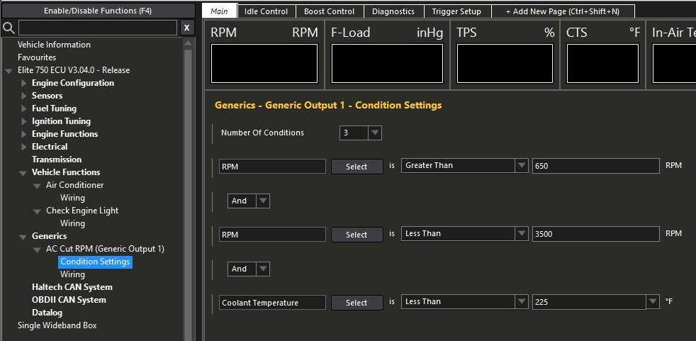

    Okay continuing my stream of consciousness on this one, I had my rules setup improperly but ACT does need to be an output on the ECU so I had that right at least.
    So this is the correct config of the rules, been a minute for me with binary logic, forgot I could just use "or" rules. This lets the Haltech turn the AC off using the ACT wire when there is higher RPM (ie during a pull or passing) and as a safety if the engine is heading for an overheat condition.
    Wiring on whatever output you chose to allocate to it should look like this...
    And the generic output main settings should be roughly like this, this keeps the AC from turning on and off too rapidly (from a rough idle condition perhaps)
