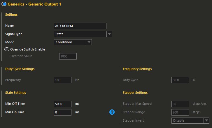

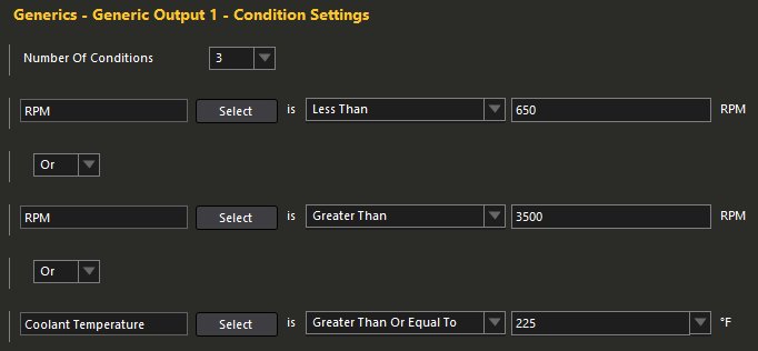

    AC systems dislike you running them at high RPM, causes pressure spikes and they cycle too frequently wearing out the clutch and reducing cold air output. Stock computer logic turns it off under high engine load and turns it off if the engine is headed for an overheat (ie pulling a tough grade in summer). Also made it so it would turn off if idle was super low for some reason to avoid a stall condition. I just mirrored the logic to my best ability so I didnt have to consciously turn my AC off in the summer.

    You know I don't know for sure, I could have done this rule with calculated load but I chose RPM since it's just easier.
    Oh, I don't know. I think it has a few conditions in which it turns off for "load". If I stabbed the throttle from a stop stock it would operate until around 2500rpm and then drop off if I didn't let off the throttle a little. At a certain lesser load it would stay on until I cross the 3500rpm threshold roughly. It is using RPM and calculated load but what that calculated load is I do not know, it seems to depend upon speed. I couldn't find any real info in the toyota EFI tech manual about hard and fast values.

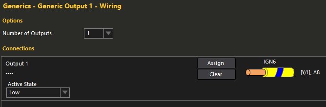

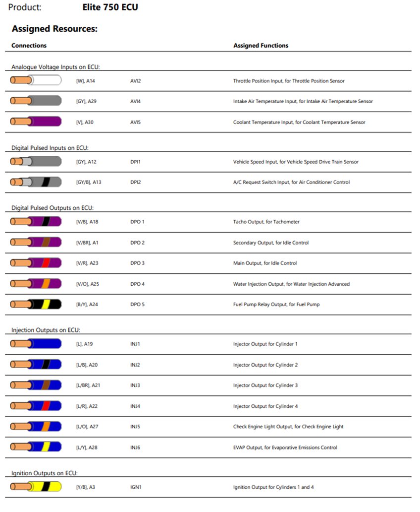

    I only have DPI2 set for A/C Request switch input, no output configured for AC. Or do you mean ACT as an output that doesn't run through the ECU?
    When you say high side switching, do you mean rising edge vs falling edge? Mine is configured to falling edge, but still have no voltage change upon switch state change.

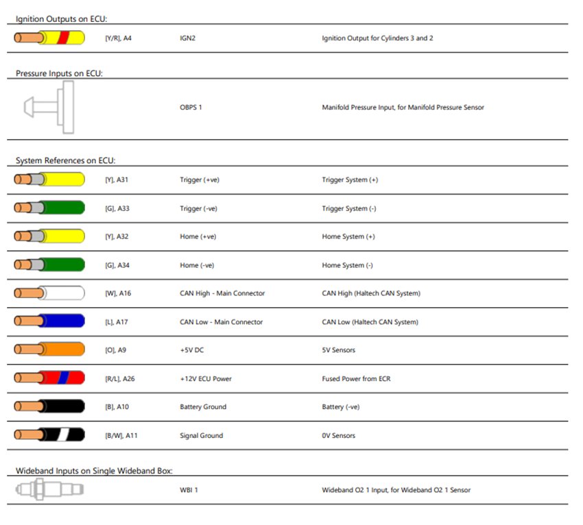

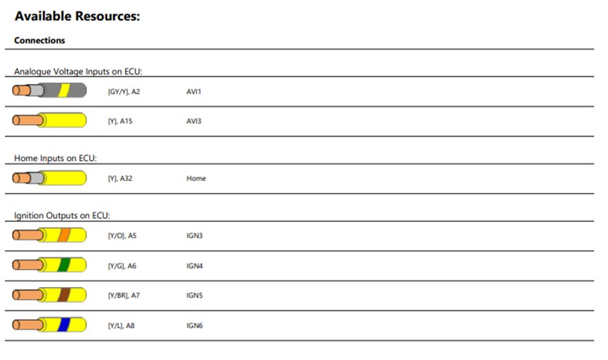

    In NSP can you generate a wiring allocation chart so I can see what I/O you have avail?

    Okay now I can answer your questions. So putting the AC Request to a DPI may be possible but it really is for sensing frequency inputs not constant state stuff and as such has no voltage sense/cutoff settings. So here is where the explanation becomes a bit muddy and I'm sorry it has to. Boomslang makes the patch harness for SNP, and when Boomslang makes a harness they make a nice little chart that marks the name of the wire in Toyota terms and where it is patched to in Haltech terms... SNP doesn't pass this piece of paper along to their customers and it leaves a black hole in knowledge for the next guy (or the customer who has features that still don't work) to figure out.
    It gets muddier still in that Boomslang, while super responsive and capable in customer service and wiring skill doesn't always know what every OEM wire does (I want to be clear I am not shaming them or calling them out at all, I love their customer support and they support so many vehicle makes and models it would be unreasonable to ask them to get everything right anyway) and doesn't always patch them to the proper Haltech I/O option... and in the case of the 750, doesn't pass along every bit of OEM I/O because there just aren't enough pins available. So in the case of my patch harness they only passed along the ACT pin but they wired it to an input... this problematic because it is not an input and it doesn't let the ECU know a damn thing as to the AC state. But that's the only AC pin they patched from the OEM harness so I had to wire up AC1 myself (which is the sense wire) as well.
    So here's where we are with yours, I don't know if the wire that's currently in DPI2 on your ECU is ACT or AC1... if it is AC1 I would suggest moving its pin from A13 to A15 and then I can show you how to set voltage thresholds on an AVI and get you going with AC sense. However if that pin they patched is ACT then it needs to go from A13 to A5 and we can configure the generic output as I showed above to get AC cutoff working for you and I can walk you through how to grab the AC1 signal and make a new pin to also have it so we can wire and configure AC sense as well. I'm sorry it has to be that convoluted but that's the downside of not having the paperwork from Boomslang.

    I just would have assumed the temperature would be the presiding condition, not high RPM...
  12. Apr 28, 2023 at 10:13 AM
    #352
    Speedytech7
    Feb 20, 2014
    #123587
    58,568
    FCQM+VG Cheney, Washington
    It's less Tacoma and more mod
    They're all "or" statements so order has no importance, order them as you please.
