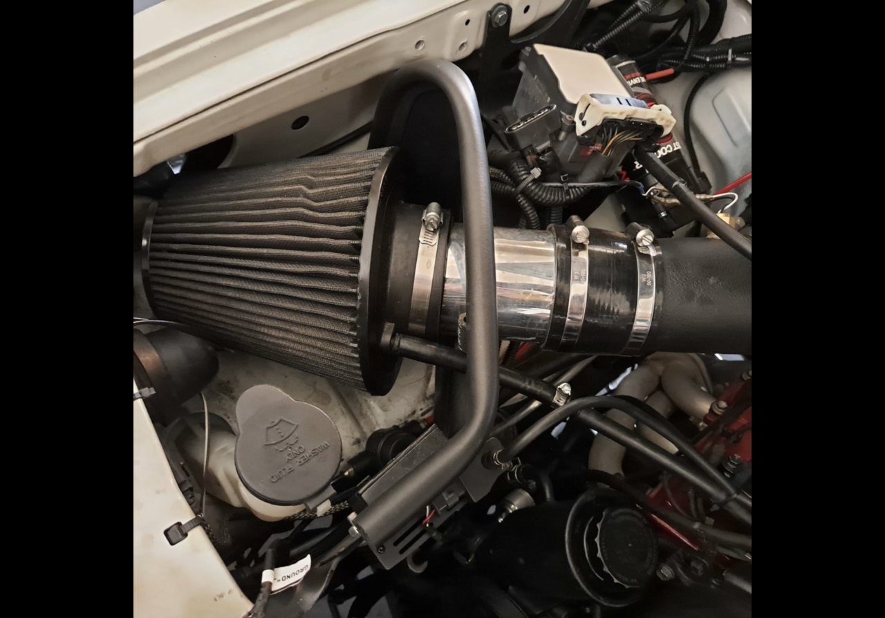

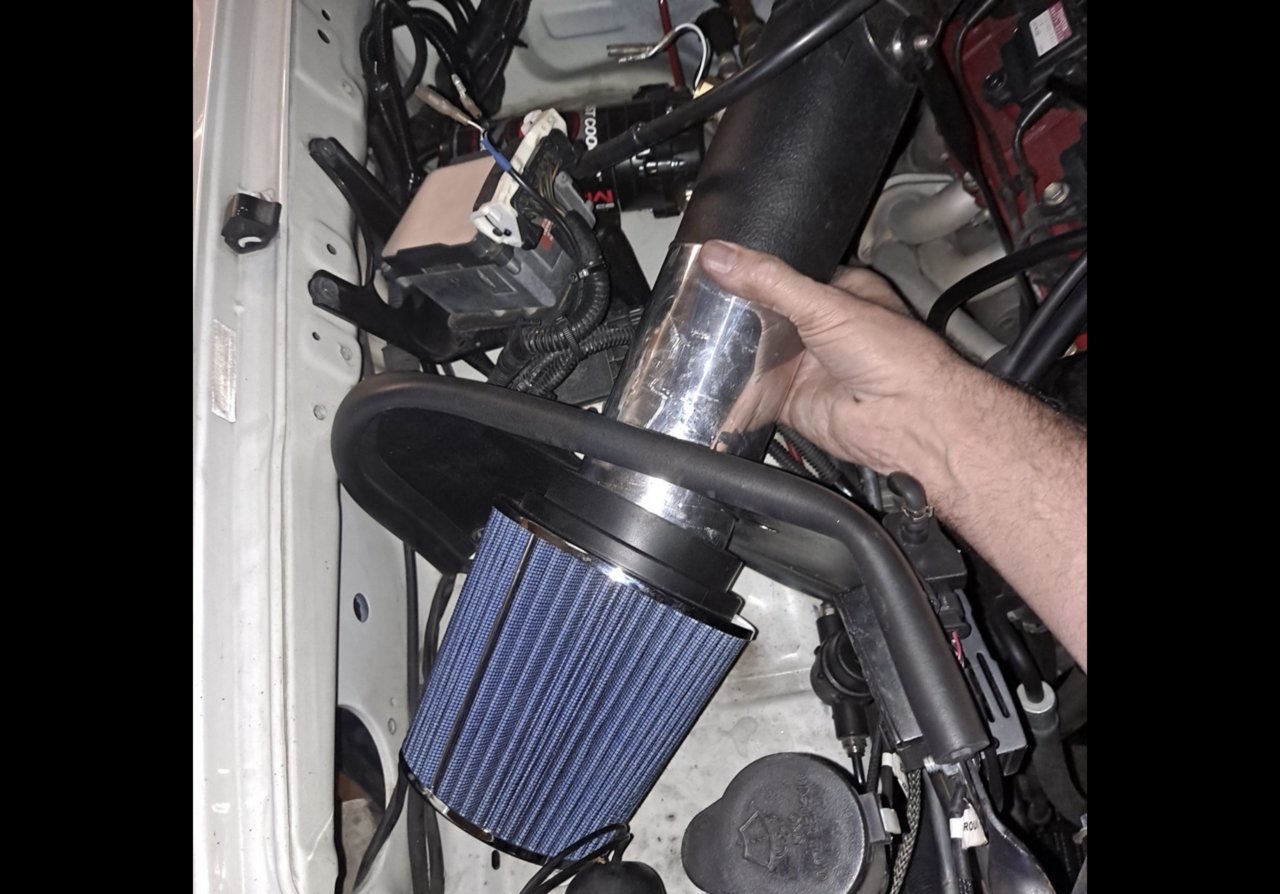

    I get what you are saying but unfortunately it's not quite that simple. Sure, it's possible to use a larger intake tube but by default, the Haltech still needs part of the MAF's functions. So as was mentioned earlier, an alternative IAT sensor would have to be added.
    There is also the vulnerability of the so called cold air intakes (K&N like cone filters) in the offroad environment. ATM I am inclined to keep the OEM airbox, even with all of it's flaws, for it's ability to use the Toyota paper filters and try to figure out how to best remove, or reduce it's inherent air flow restrictions.

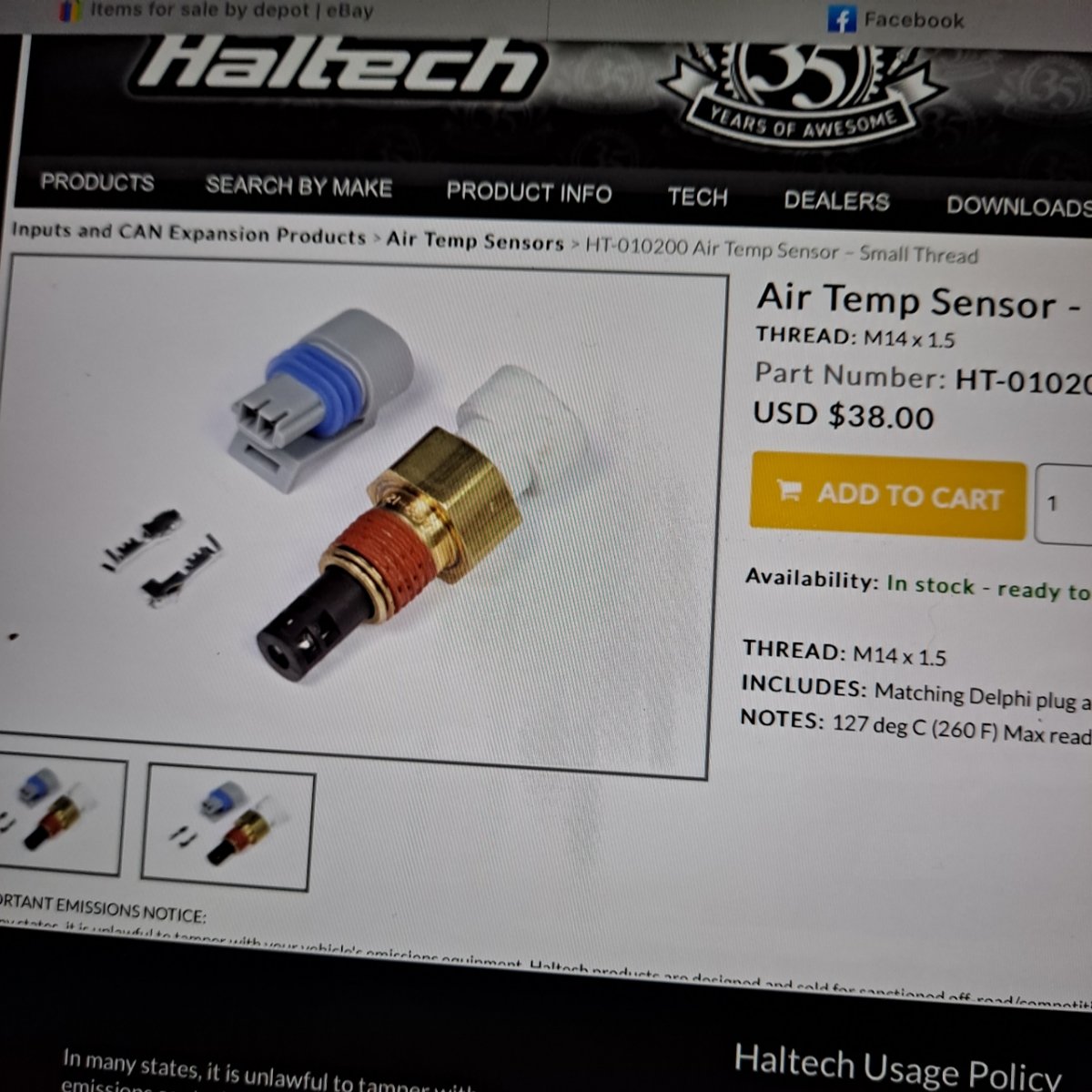

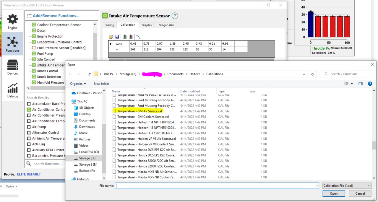

    Gotta love Haltech, they have the calibration for the GM IAT built right in, I don't even have to make a resistance plot for it. Be about 5 mins of wiring to have it functioning.

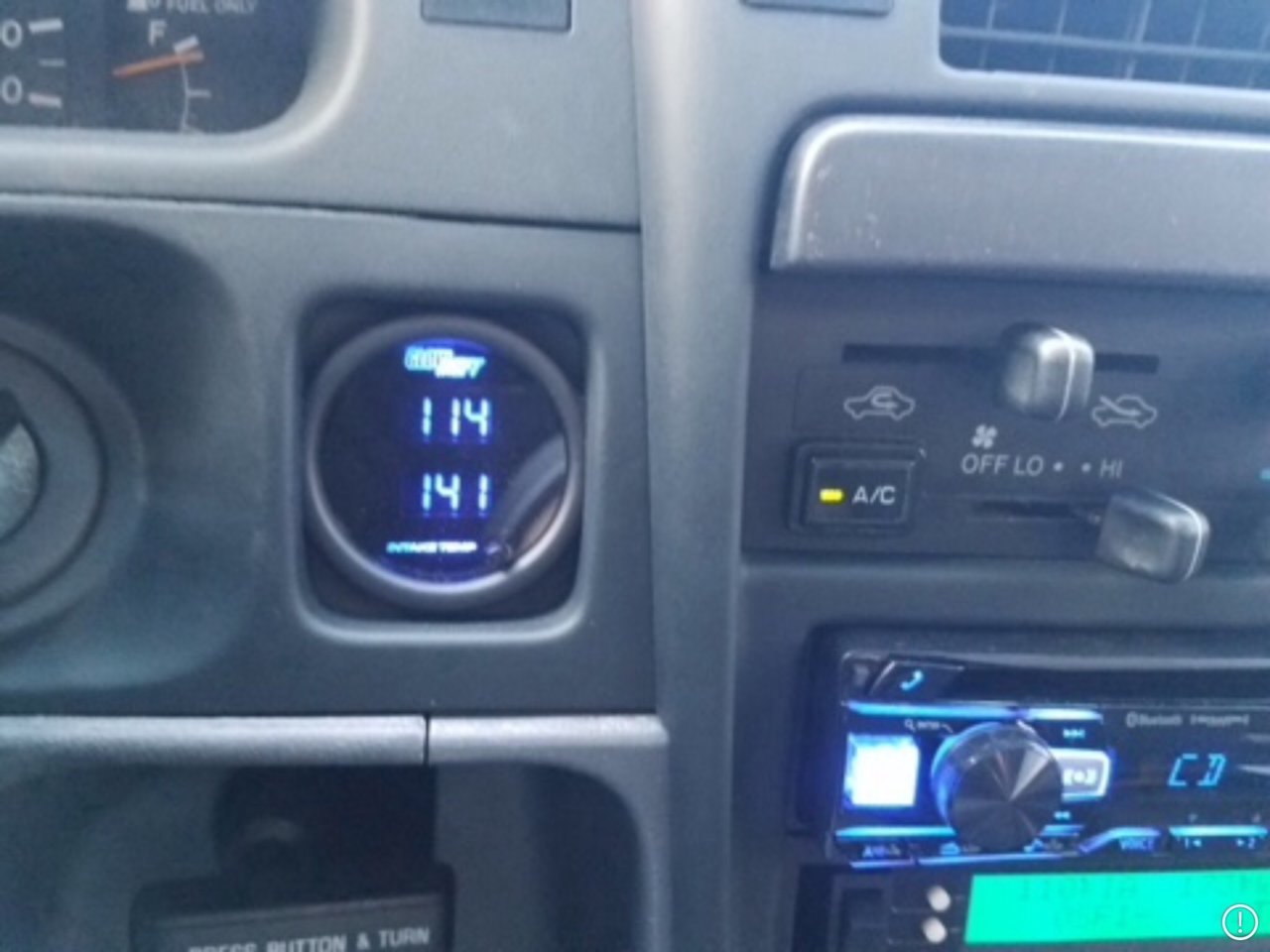

    You don’t need any part of the MAF if you wanted to delete it.
    I have a separate wire for the intake temperature from the haltech and haltech has its own temperature sensor.
    You can mount that sensor on the out put side of the supercharger for the real temperature going into the engine or the intake tube.
    The MAF temperature on a supercharger is completely different than the actually temperature going into the engine by as much as 50 degrees depending.
    If you have a temperature sensor on the output side of the supercharger you would see the difference.
    Sometimes the output side of the compressed air is as high as 200 degrees
    I have not added that sensor yet, my MAF is not used in my situation.
    here is a hot summer day around 100 degrees, intake temp at MAF is 114 and supercharger compressed output air is 141 degrees with no load.

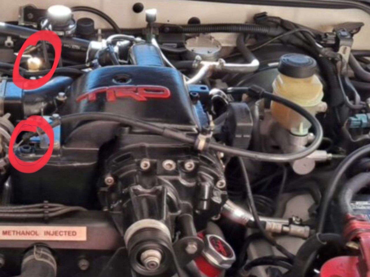

    The 1st gen has casting holes that are threaded that are after and super easy to get to and you can use the haltech sensor

    Oh the ones for getting to the bolts that hold it on? That makes sense. The Haltech sensor is the GM one haha, both made by delphi, theirs is just M14 instead of 3/8NPT.

    Not the hold down bolts no,
    Here, there are two casting screws block outs, holds nothing but plugs the holes.
    One on either side as shown in red, sensor is on the back side.
    This area is boosted hot air that can be tapped into IF you the correct temperature.
