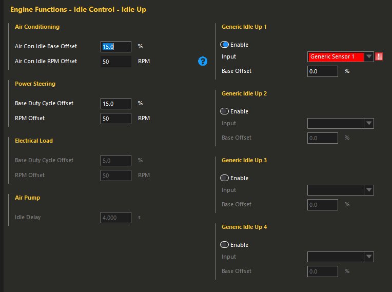

    Yea I'm referring to the electrical load idle up. Wasn't sure how that was triggered and if I needed to add some sort of wired input for that.
    The first thing that comes to mind for an "electrical load" idle up condition would be looking for a voltage drop in a certain range to trigger an added idle RPM offset. Guess I could setup a generic for that kind of condition, but don't know how effective that would be. Gonna need to test that
    Edit: so looks like I would wire in the same switch to my ARB to that generic sensor 1 on the ECU so that it offsets the idle at the same time the compressor is turned on.

    Ah, think this is what triggers it
    https://support.haltech.com/portal/en/kb/articles/electrical-load-switch
    I'd probably just tap my air compressor switch output into a generic since as far as I'm aware our trucks don't have a load sense output.

    Gotcha. So could theoretically tie that into the voltage sense circuit on our alts? Don't know if that circuit is analog or SPI or if that would even work.
    And yea that's what I think I'll do. Didn't think of the generics for idle up.

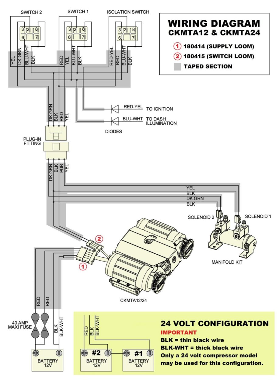

    good idea with the controller and current shunt. Although don't really think I need a system sensing function.
    Now that I thinking though, the winch is another high draw item that I would need the idle to compensate for. Even more so than the compressor since it's capable of pulling a lot more amperage. So maybe possible to tie both of those outputs into one with diodes?
    My compressor has two dedicated positive bat wires to supply it, and then an 18?ga or so wiring harness that goes into the cab for the switch and locker control. So I was thinking I'd just tap off of the positive output of the switch for the ECU switching signal.
    not really sure where the relay for the compressor is. I assume inside of it somewhere since it's not in the diagram but listed as a PN

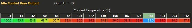

    Well honestly I've been having idle issues for quite some time now. That and cold start behavior. But I don't wanna go into too much detail about the different things it does in different situations for the sake of clarity. I can't quite seem to iron it out no matter what I try. Gabe was having a lot of trouble with it too.
    I have it set for 850 when warmed up, but it idles at around 1k. I have to bring the base output down way too low to get it to hit the target, and then it doesn't consistently come back to the target after some revs. Just overall not consistent behavior.
    I've been told it could be because of my IAC and deleted EGR, but the coolant lines to the tb are good and the IAC functions as it should

    What does your min output table look like?
    Speedytech7[OP] likes this.
  20. May 10, 2023 at 4:12 PM
    #400
    Speedytech7
    Feb 20, 2014
    #123587
    58,571
    FCQM+VG Cheney, Washington
    It's less Tacoma and more mod
    This looks extremely under defined. @treyus30 or myself could probably help you straighten this out. It doesn't appear that it's been tuned at all other than trying to put in some RPM goals, but that alone won't make it function. I don't think you have load based stall issues, I think you have a really poorly configured (not configured at all) idle control section. It doesn't have any reactivity to vacuum so it can't really self adjust.
