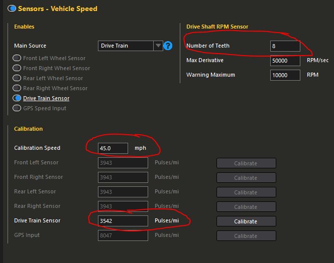

    @treyus30 Did you ever getting a working reading from your VSS that was usable, the system on my truck is different but if you didn't I thought we might be able to find something usable from Mike's tune since his is almost identical to your and appears to work (albeit not calibrated).
  4. May 11, 2023 at 7:24 AM
    #424
    treyus30
    treyus30 70% complete 70% of the time
    Jun 24, 2015
    #158054
    8,406
    Trey
    Mesa / AJ, AZ
    '99 5VZ-FE Twin K03s w/Haltech
    Historic plates and 2 bar
    Oh ya it works as an input, still haven't tried as an output though.

    Back into the factory ECU for tire size calibration. So intercepting the signal and resending it rather than tapping it
  7. May 11, 2023 at 7:31 AM
    #427
    Speedytech7
    Feb 20, 2014
    #123587
    58,582
    FCQM+VG Cheney, Washington
    It's less Tacoma and more mod
    Oh I see, that would be to help with trans shift points or just to correct the speedo?

    Both since Im basically waiting an extra 10mph for lockup

    Huh, yeah that's not ideal. Well it's a simple enough thing that the ECU should be able to do it but I don't think I've ever seen it done not over CAN.

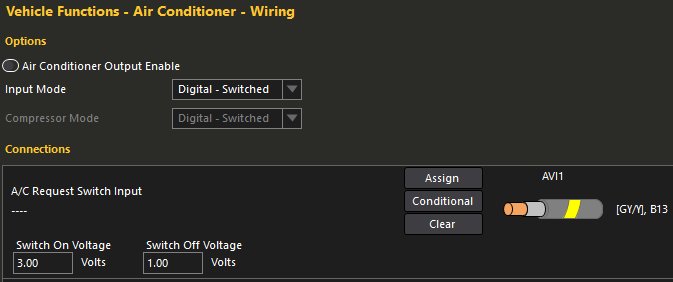

    I definitely still need to figure out the AC request switch wiring. That and tying the compressor relay into the HT because both of those still stall the motor at idle even with the improved idle control now
  16. May 11, 2023 at 9:12 AM
    #436
    Speedytech7
    Feb 20, 2014
    #123587
    58,582
    Whenever you want help tacking that I'm happy to work through it with you. Just need to know which wire you've got and to make sure that once we have AC1 we wire it to an AVI so you can have the switch threshold options like this :)
