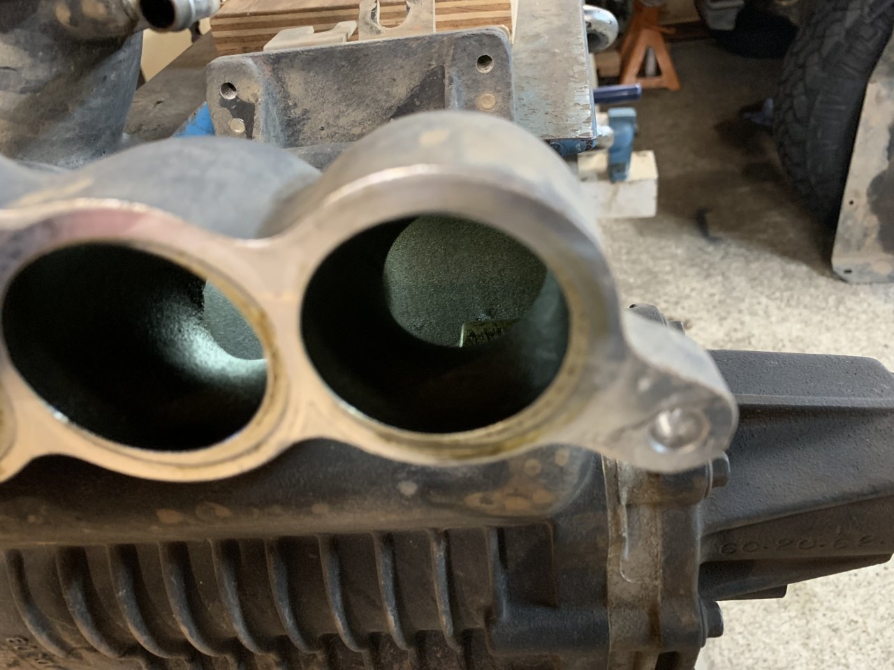

    @drr Is this spot a possibility or is it not open inside like i think

    Actually yes, there is an open chamber right behind that spot. For that matter, you could put the sensor right next to the TB and it would be centered in the chamber right before it splits into the individual runners.

    Bearing in mind the sensor+connector are kinda tall any place in that open area where it will see good constant flow but doesn't take up the limited space of an individual runner is probably good then. Also don't want it too hard to clean chips out of
