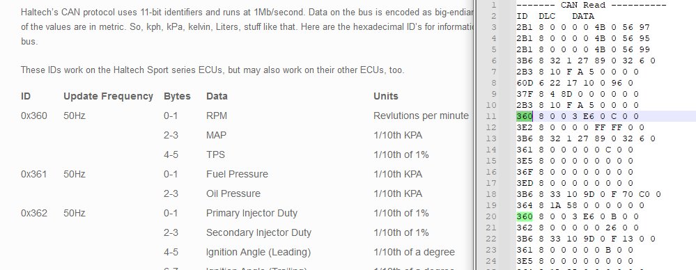

    And at least from what I understand from reading the io expander data sheet haltech can only fully refreshes data every half a second.

    I definitely get much faster readings than that from the CAN (and datalogging for that matter). Maybe that's just the IO Expander built-in limitation?

    that can't be right. it has to be faster than that. The IC7 needs to have fast refresh rates in order to function as a dash
