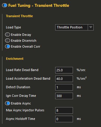

    Sounds similar to my issue. Although my tune started out in NSP.
    I've tried taking the enrich overall correction all the way up to 80% to no avail. along with increasing the load rate dead band and load accelerated dead band values.
    I'd start with seeing if it's because of the bug or not like what you're saying

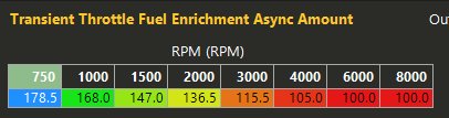

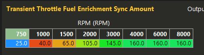

    Here's my sync, async, and settings fwiw

    Yeah I'm at a solid 60% on that one haha. It's not so much that I don't understand the math but more so how it arranges async vs sync when both are present since you can demand over 100% of function in the enrich map
