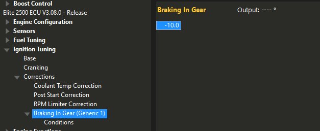

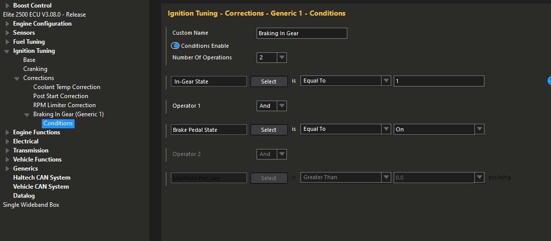

    Going to try an experiment in a couple days once I can pull the gauge cluster and finally tap the P/N wire: Timing retard to assist in braking

    Naw with 10deg I should still be in the positives BTDC in all relevant cells unless I start driving with 2 pedals

    Really just RPMs below decel. It's mainly coming up because my cold idle RPM produces enough torque that it wants to send me through intersections

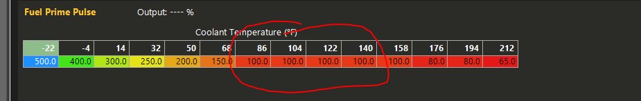

    Brought my fuel prime pulses wayyy down for my current cold start temps. Starts like a champ now
    Speedytech7[OP] likes this.
