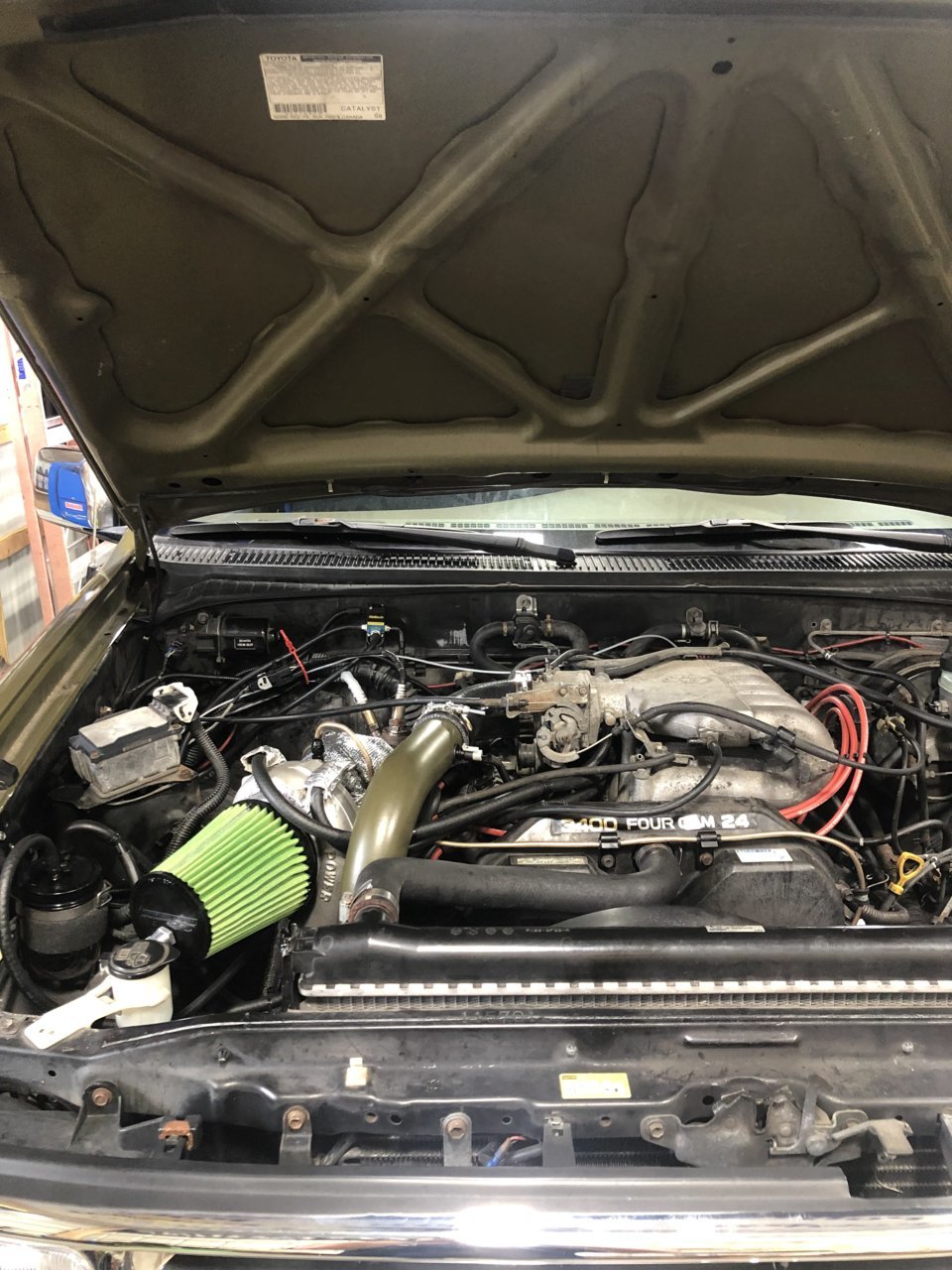

    I had an issue with the trigger signal while tuning. I have since replaced the crank sensor which was the problem but now I am waiting for injectors to come in before tuning again. It does idle and free rev nice but I don’t want to drive it until I have a proper tune. I just finished welding my exhaust system in and I really want to go for a run!
    Cool thread. My build:
    1997 T100
    174,000 miles
    1 inch balljoint spacers front
    Extended shackles rear
    285 75 16 tires
    Stock 5VZFE
    Stock 5 speed trans
    Stock transfer case
    650cc Injectors
    Denso fuel pump
    Stock replacement Denso ignition coils
    Denso plugs IK22 gap .028
    Magnecor ignition wires
    Master Power RB6762 turbo
    CX Racing manifolds and downpipe
    Turbosmart vee port pro 38mm bov
    Tial Sport 38mm wastegate, small yellow spring (3-4 psi)
    Ebay intercooler 28x7x2.5
    Haltech Elite 2000, homemade pnp harness
    Haltech WB1
    Haltech boost solenoid
    3in stainless exhaust with high flow cat
    Pypes M80 muffler

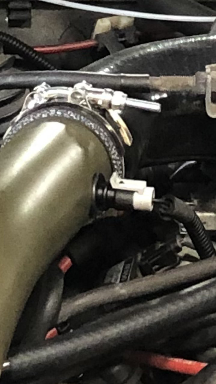

    I used a generic IAT sensor I bought online for less than $15 with a pigtail included. Drilled a hole in my charge pipe just before the throttle body and used a grommet to hold the sensor in place. So far so good. Obviously, I could have issues with any number of things down the road, but as far as doing little things on the cheap and spending where it counts has been my focus. I don’t have a lot of money to throw at this project and some of the aftermarket parts are just a ripoff. Look at catch cans for example. I made one using a ball mason jar, really hill billy but its a conversation starter at least

    That looks excellent! Giving me all sorts of motivation to get my turbo kit installed now rather than wait haha. Your generic IAT looks a lot like the push-in version of the GM one, if you drill the hole in the piping small enough I've seen them hold at least 15psi without boost leaks. How has the WB1 been reporting since you got it running without trigger, pretty steady? Can always use it to get the fuel side of your map in a good place with the long term trimming function.

    It does have a GM style connector, so you are probably correct. I did make the hole as small as possible to avoid blow out, the sensor fits tightly. I wont be pushing boost higher than 12 or so anyway. I haven’t really ran the engine with the data up since I put the new crank sensor in, but my gauge is reading 14.5-14.7. If you need any help locating parts or want to know more about my build, let me know

    I have a much smaller grille space since I have a 96, but how well does your intercooler fit. I am going to go with a water to air setups just for space saving

    The intercooler fits like it is supposed to be there, I was amazed. Remember my truck is a T100 though, not a Tacoma. I can take a photo and post later today.
