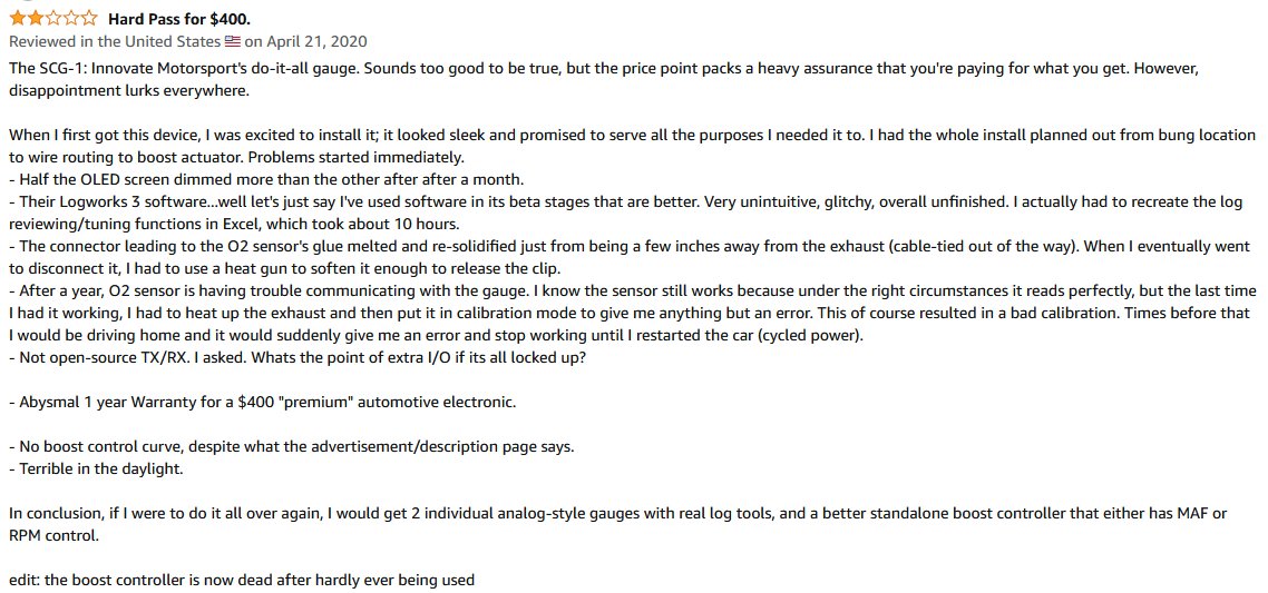

    fwiw Innovate is on my shit list

    Sweet, that's great news. Yeah, I was getting DTC's for the Wideband Raw voltage and it was limiting my RPMs to 2k, had to restart truck to get it out of limp.. just annoying stuff.
  14. May 30, 2023 at 7:44 AM
    #594
    garetcurry
    garetcurry Well-Known Member
    Dec 12, 2010
    #47615
    207
    I had an Innovate gauge prior to this one and the LSU 4.2 (?) sensors would last 3 months. Then 'tHeY' said "aw, we fixed all that with the newer models." So, I buys their next model gauge and the sensors don't completely take a crap (LSU 4.9 now), but does this slow boot-up, never heats-up crap.
    So yeah, I'm done Innovate too.
    treyus30[QUOTED] likes this.

    My Amazon review heh...
