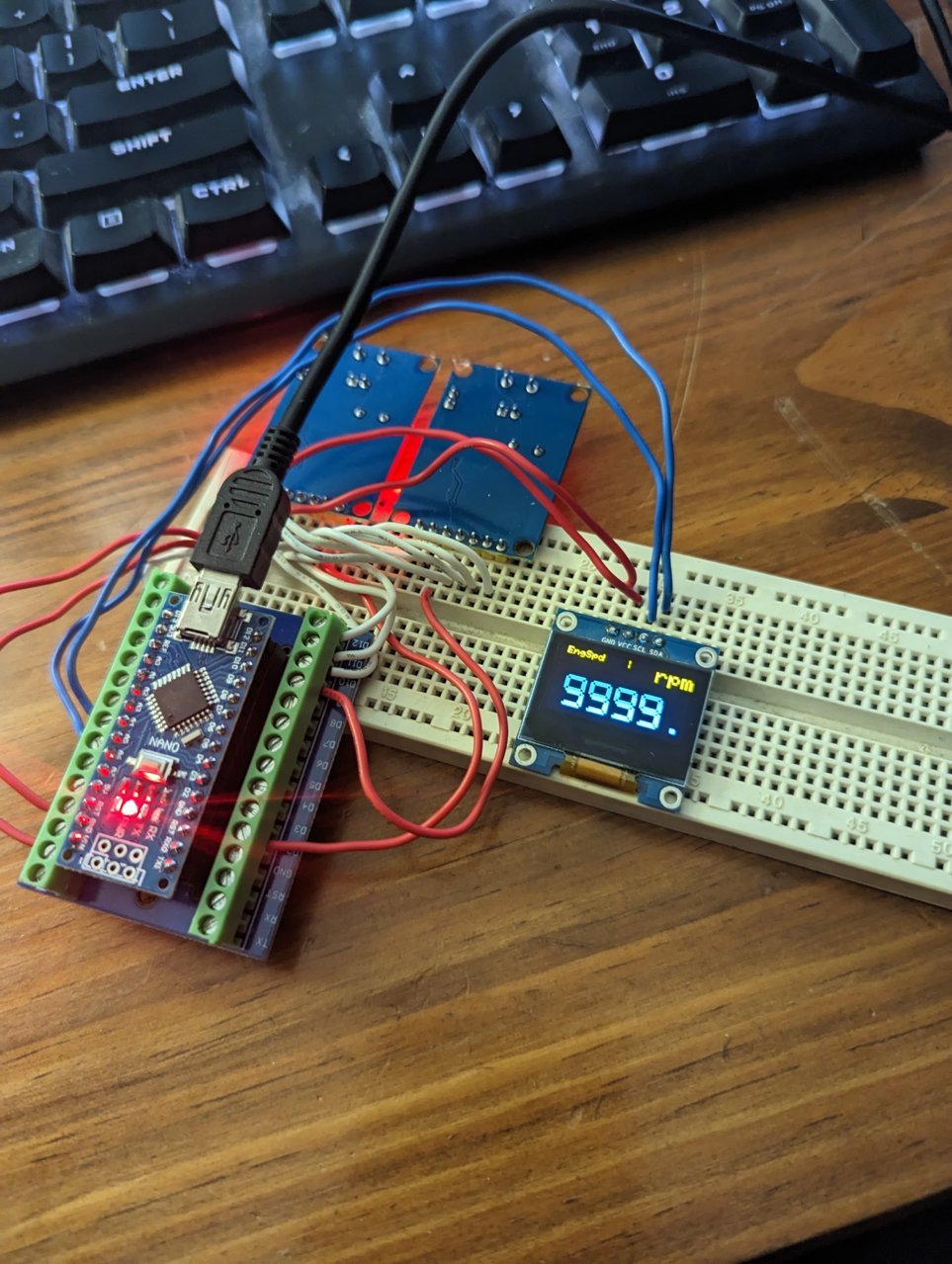

    After having two boards go bad, and spending an extreme amount of time trying to keep memory usage tiny, I think I might be better off basing this around an rpi pico for just a little bit higher hardware cost.
    It works rn, but I'm at basically 80% capacity and have a good chunk more I want to add, and the ascii display library I'm using absolutely sucks for large format letters. Memory issues will get even worse when I move to a 240x240px display

    Rpi is a great platform and the picos are a nice small size. Always good to have more headroom than be at the limit

    I definitely think I'll prefer that - just ordered 5. I've only used the big boards before though - with the full OS, which is not what I want and why I think the Pico is better than the Zero in this case
