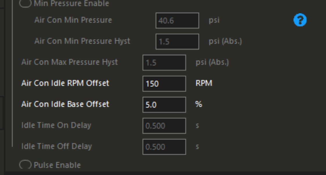

    Here's my Air Conditioning setup w/Haltech 2500 Elite:
    https://youtu.be/XX6N9O41jl8

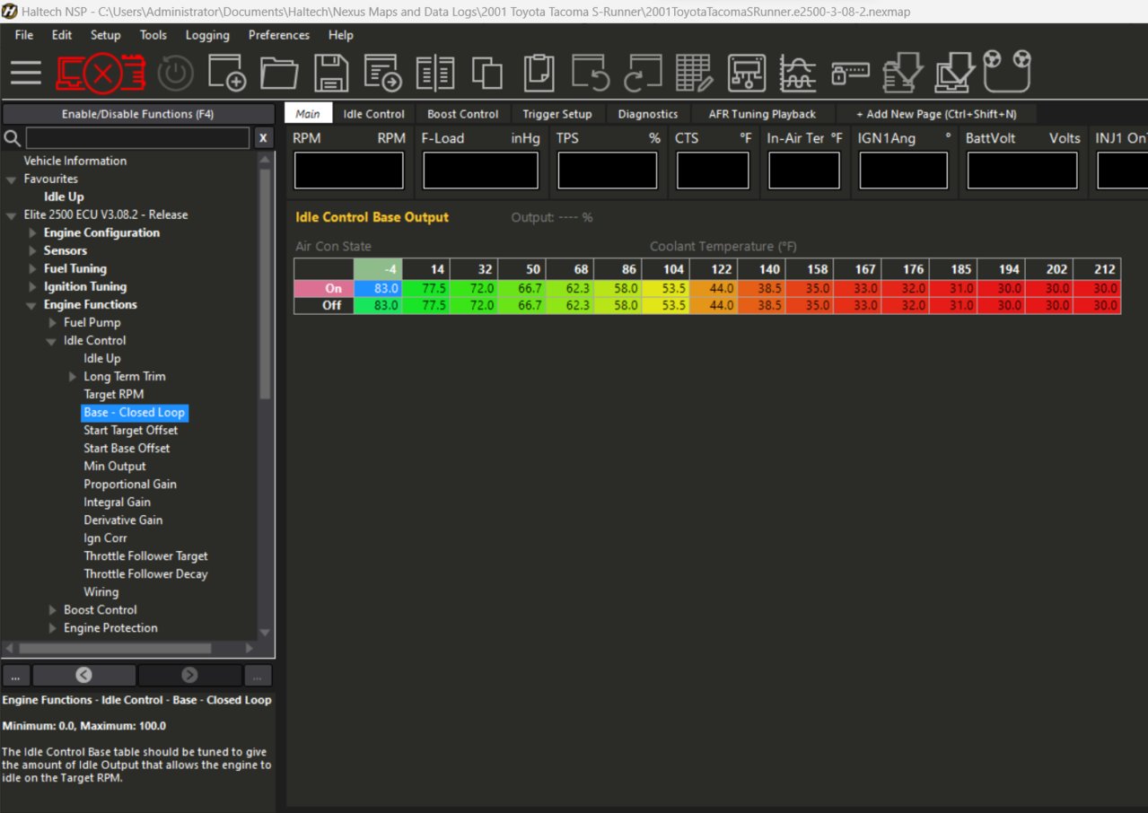

    I also have this going on for Idle:

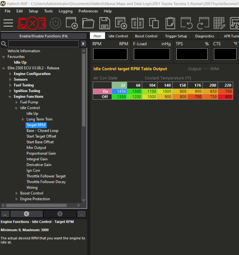

    And this for Idle (needs better tuning, but works):

    Why not just configure the air con idle offset rather than use another axis on the main idle output and RPM target tables?

    Not sure how you wired it but mine responds to the actual clutch engaging which is what you want

    Mine responds to the AC amplifier engaging the clutch too

    Offset wasn't working for me. Maybe it will work now, since I have the button setup working.
    At the end of the video, there's a moment where it's not responding, but then (I feel) the clutch on the AC let go and it shows Off when that happens. I would say mine is reacting to the clutch as well.

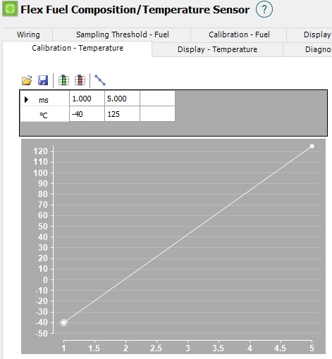

    Also fuel temp seems to have a bad calibration... says it was 66*F from the HT analog fuel temp cal file and that was after switching the trigger edge, but at least it's not reading 250F anymore. Thinking this might be the correct setting, though it's not what's included with NSP (it would put me around 120*F which is what I'd expect).
