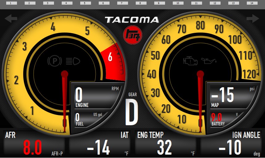

    Slowly making progress on my tune, something went a little haywire at some point and I started running oddly lean, so I did a bit of work there.
    But I'd like some gauges, so I started working on modifying the IC7 layouts for some personal touches. It reminds me of reskinning a video game haha
    unstpible, treyus30 and Jon64l like this.

    How are you porting over the fuel level? Do you have that wired into the HT?
  9. Jun 14, 2023 at 8:19 AM
    #669

    You can wire it directly to the IC7 and tell it what the resistance sweep is
