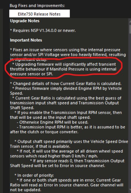

    has anyone upgraded to 3.09.2 firmware?
    Saw this in the release notes. Not sure how to interpret this.

    Sounds like they reduced the base filter level of the internal sensor that was applied after they patched them to become 4bar sensors. This is good news because I've still had a fast throttle stab lean spot I couldn't tune out entirely. Maybe I can have less ridiculous async transient numbers now.

    In relation to the patch notes, I want to say the lean blip in the throttle coming out of idle has subsided, but I was doing a lot of idle control stuff over last week.

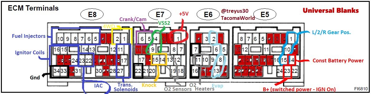

    Got sick of going all over the place to trace functions, so here's everything on a 5VZ non-cali edition ECM if it helps anyone else (pic highlights blocks, everything else is in the spreadsheet):

    Funny, I just downloaded the pdf with all the ecu pinouts.
    Did you end up swapping pin locations for AC-T and AC-1 in your harness? Seems they were pinned wrong apparently. I need to check mine, Idle is poor when Ac is on, I don't think HT is getting the signal.

    I had to do that for mine. Seems to be the case on most all harnesses. Just check if you're getting a voltage change on the AC input

    I did not have an issue with AC but my power steering and CAN were backwards
