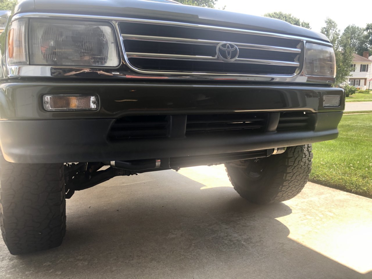

    You won’t be able to see much since the intercooler is black, but that was my intent. If you blow up the photo you can see some of it. Its nicely hidden
