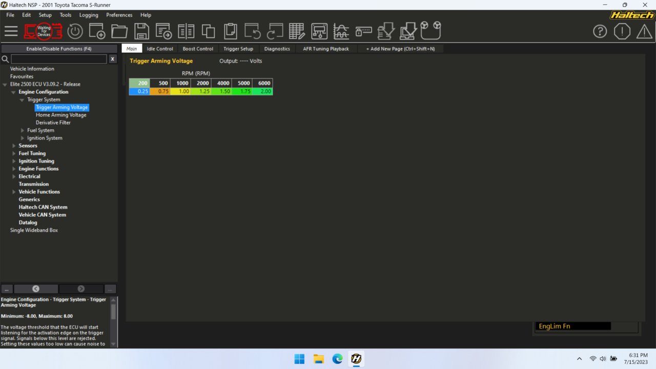

    Make a new column with higher value? Say 6500, heck 6100. Just so you are not clipping the cell. Or lower rev limit to 5900 and try that.

    Higher will just cap at the lower cell

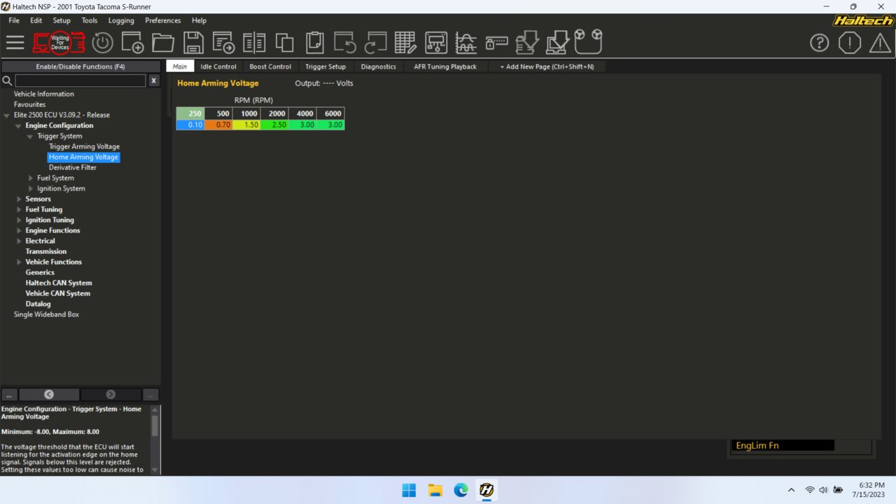

    Wouldn't that not matter? Bouncing off the limiter has the potential to go 1 rpm over 6000 into a new voltage threshold.
    Also bouncing the limiter could have a bit of timing belt slap, throwing things out of sync.
    Just ideas.

    Hmm bouncing the limiter could change the reference but usually that just causes the home % of travel to change. It only throws the trigger error if it misses reading the tooth entirely in a cycle.

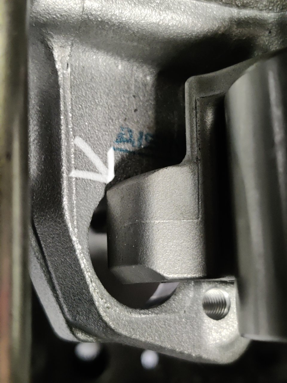

    I've been wanting to see if anyone else had issues with the timing belt constant tensioner rubbing the ring it goes through on the oil pump housing.
    When removed the old one I noticed it felt funny. I don't think the tentioner was doing it's job and thought that could cause timing belt issue if other 3.4's had the same fitment.
