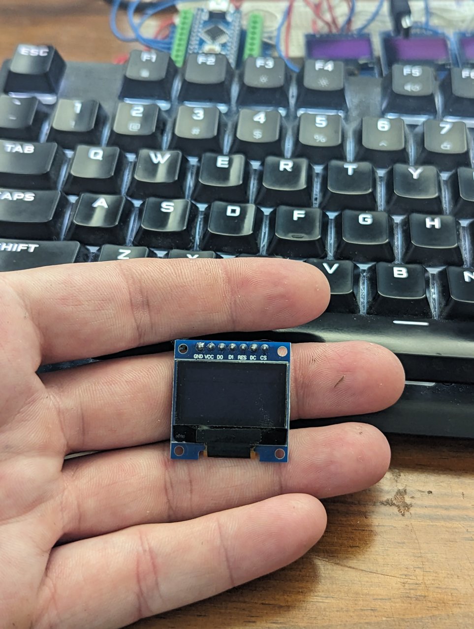

    This is what the 0.96" SSD1308s look like so just lmk what you guys would like. I just wanted to provide a solution that have you adequate sensor space for multiple sensor readouts, but if I don't need to do all the work I planned on for multiple sensors/displays simultaneously that's great

    Dimming was a thought that supposedly is supported to an extent, which I can implement - just a matter of how. I can do a headlight switch input which auto-dims it like most gauges, I can do a button, and/or I can add it to the "terminal" programming (USB) but that would require a computer to change the brightness every time.
    I went OLED over LCD for visibility in sun so don't think anyone could ask for more on that front.
    Everyone probably has a different idea of where they want to place the displays, but if you guys give me dimensions I can easily make just front facing bezels. I felt it's a bit scary to make any permanent changes to your vehicle which is why I was designing these as something you could rest on a surface and link together in a 2D way.
    I think what I'll do is go ahead and make this stuff available as I continue to work on the 3D prints. That's where I intend on making a little profit anyway if I can. But if people want to get the hardware and cobble something together on their own that's possible very soon, I'll just provide the flash file, parts list, and wiring diagram.

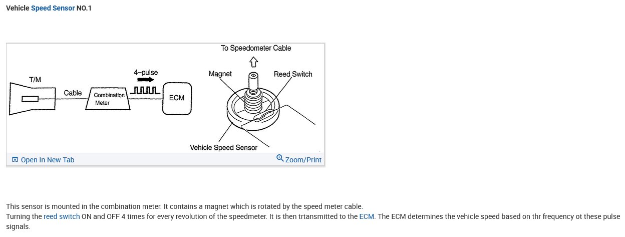

    I need to configure boost by gear... I've become a danger to 1st and 2nd gear and to a lesser extent 3rd. But first I need a speed signal that works, the feed from my speed sensor in the cluster never reads right for the haltech.

    The sensor can be calibrated by the Haltech if the signal is clean, but the issue is the signal is entirely unclean it has zero rhyme or reason in how it registers voltage wise. That said my speedo is dead on so even if I couldn't calibrate it after it would be right. I'm probably going to convert to a mazda speed sensor though.

    It's not like the 2WD auto sensor or the 4WD t-case sensors... which are VR or hall effect respectively... it's a rotating magnet closing a circuit with a reed switch inside the cluster. My truck has a cable drive speedo cause 95-97 are cool like that

    Does your speedo at least have an output to the ECU like mine? I'm still meaning to probe that

    That's the only output mine has. Issue is a 4 pulse should be easy to zero in on and this one is not.

    Huh. I wonder if it's half-byte encoded or something more digital than a simple counter
