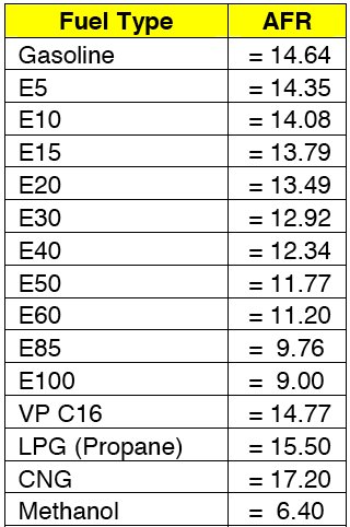

    In other news, I guess I'll be theoretically using up to 4% more fuel now that I'm running a flex fuel sensor in lambda 1.0 regions lol
    Gas over here is reading between 6-8% ethanol though, so a bit less
