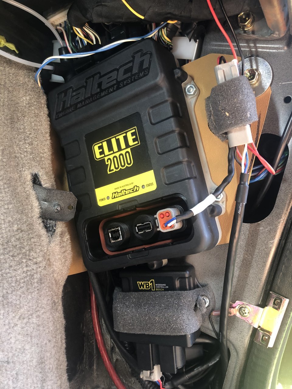

    It's less Tacoma and more mod
    750 Cost about the same as a MS3 Goldbox (had one of those before), Haltech just has better support and a larger built in feature set. Depends on what your time is worth too, not having to cobble a harness together is worth the chunk of coin to me

    '99 5VZ-FE Twin K03s w/Haltech
    Historic plates and 2 bar
    Ya the "MS3 Pro" as they call them are a lot more (like $1500, still 1/2). But ya more features that we don't really need though. That link I posted seems to be the only hardware you need and it gets you access to the same tables as the 750. It might be a little jenky in some areas, and soldering is time-consuming but kinda therapeutic, but ultimately it's not like I'm doing this to make money or win drag races here.

    How much do you think a 750 costs? They're $1150

    Hmm not once you factor in the PnP harness, but ok I was looking at a bit of an inflated one that was specific to the 5VZ
    http://snpspeed.com/SNP-5VZ-750-A.html

    Yeah I wasn't sold on the guy who markets that kit so I opted to avoid it. I just got a harness patch, 750, and WB1. The WB1 and 750 came from MAPerformance and the harness was from boomslang (awesome guys BTW, seriously excellent customer service and knowledge). I came out ready to run from that at just shy of $2100 after shipping and taxes

    Alright I'll correct my thinking to $600 vs $2100 ;)
    ...until they get back to me with 5 other things I need

    If you think the spending stops at $600 I think you'll find yourself dissapointed if you want a feature set commensurate with even the stock ECU. You'll need a controller or kit for wideband at the very least and you'll have to make the harness still (I get it, its not hard, but it is tedious and MS isn't as refined internally so you'll have to do filtering for some circuits manually)
