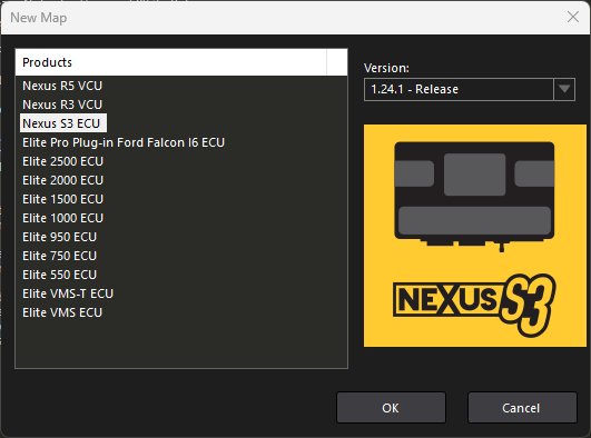

    Looks like Haltech is going to release a new Nexus ECU, it slipped in the NSP update...
