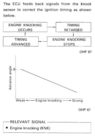

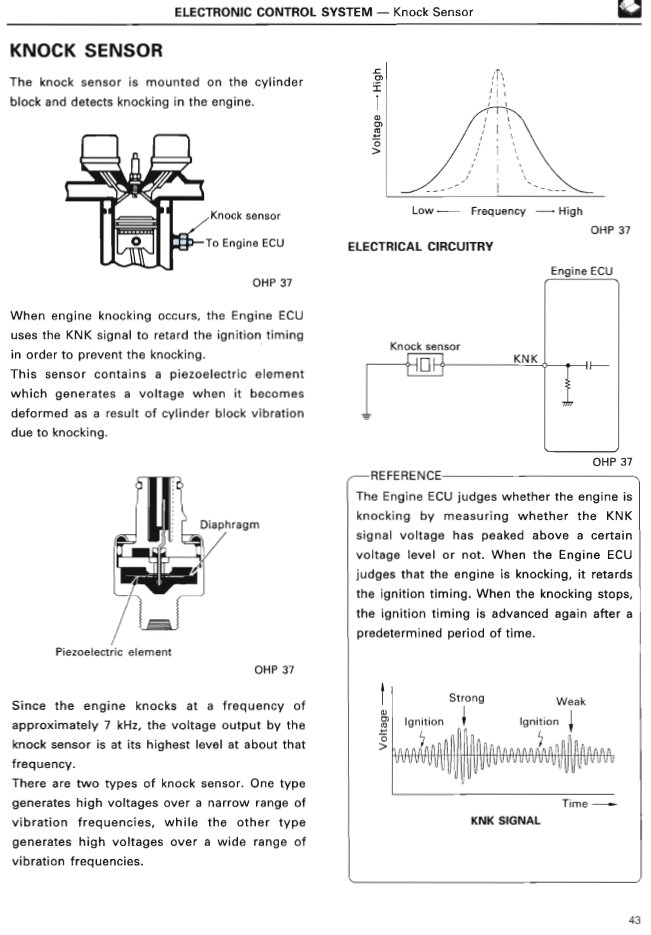

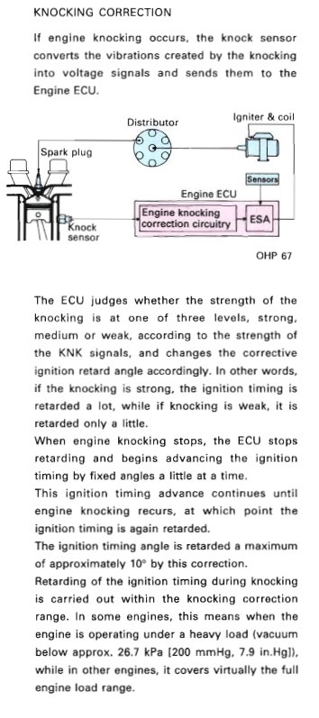

    upload_2023-10-6_11-30-34.pngupload_2023-10-6_11-31-27.pngupload_2023-10-6_11-33-9.png
    That's all i can find in regards to the Knock sensor duties, there could be more but I didn't find any specific misfire logic section...
    You're welcome to check the document yourself, it's very handy

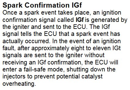

    Hope it helps, I missed this earlier... but this is basically what I outline with the collapsing field.
    So I'd say they only have ignition based misfire detection.

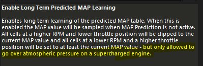

    I have the day off, so I went poking around the new settings....
    So let's say I want to keep using Transient Throttle until the MAP Prediction has some time to learn cells. You guys think we should set this value as high as it goes so it's not accidentally correcting to bad data during that process?
    I'm also kinda surprised you can't disable Fuel Film separately from MAP prediction. I have no idea how to estimate pooling percentages or time constants.
