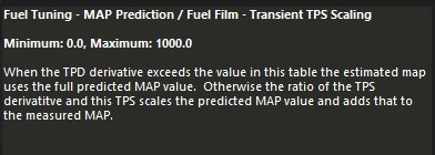

    Absolutely, Haltech created a little bit of magic with this update. I'm not really sure how the learning occurs but I can see that values do adjust and I haven't had a single hiccup since rolling the version forward. Once you're on the newest firmware it is easy to disable the classic transient throttle and enable map predication in its stead from the Fuel Tuning tab. Other than changing your engine details to reflect if you're NA/Turbocharged/Supercharged that's all that needs to be done.

    RE This... when you upgrade your current map using NSP it seems to generate very accurate MAP Prediction/Fuel Film maps of its own based off of your tune (minus transient). I wouldn't leave both transient on and map prediction, you're just going to feed the MAP prediction garbage information and with its scale turned down it would think it isn't affecting anything and continue to trim until it was useless when you finally scaled it properly. Also I'm fairly confident this feature couldn't smoothly start and stop if it was divorced from it's fuel film modeling. It would have a delay like opening the secondaries of a carb with too small of jetting if the fuel film was gone, but I don't think they intend you to mess with it much unless there's a specific issue you need to hunt down.
