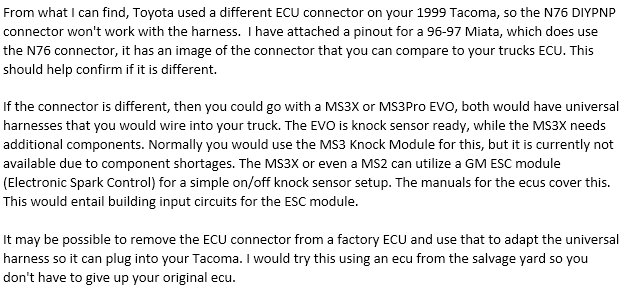

    FYI, the reason the MS kit states '95-97 model years for the 5VZ-FE is that they changed the ECU connectors. So there is no plug and play after all for most of us.
    From their tech support:

    Must be a Denso 122 pin connector
