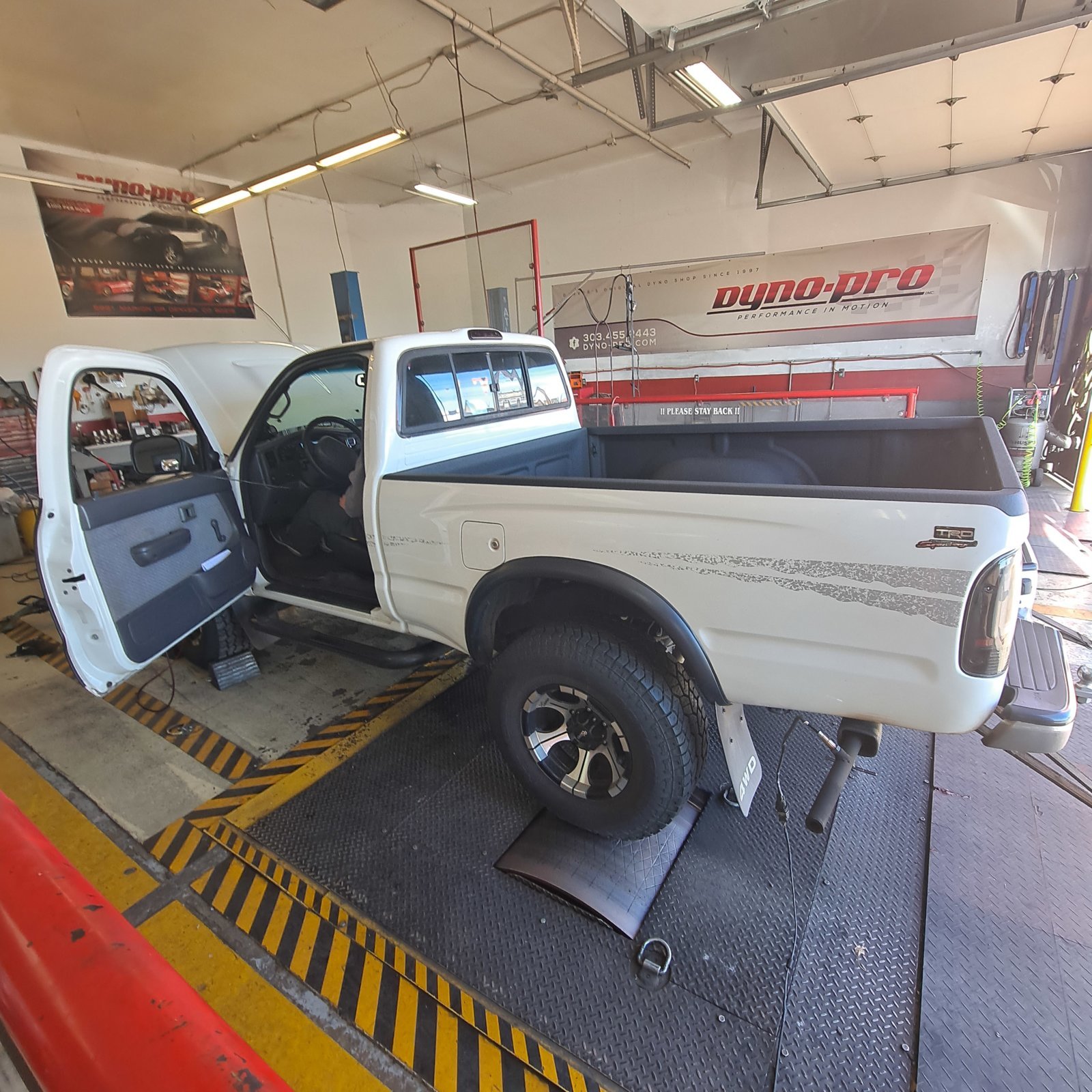

    Spent an hour on the dyno with Gabe fine tuning the haltech with the new 1320 and the new 60mm pulley On a remote tune.
    Was a good day with good results.
    304HP-326TQ with a nice power graph

    Ooo nice, roller dyno at altitude. Definitely good numbers to the wheels. How much boost was it making before and after pulley? How do you like the new SC vs original unit?

    thats a really nice curve...

    Looks like the 1320 is a much better supercharger than the original, cool.

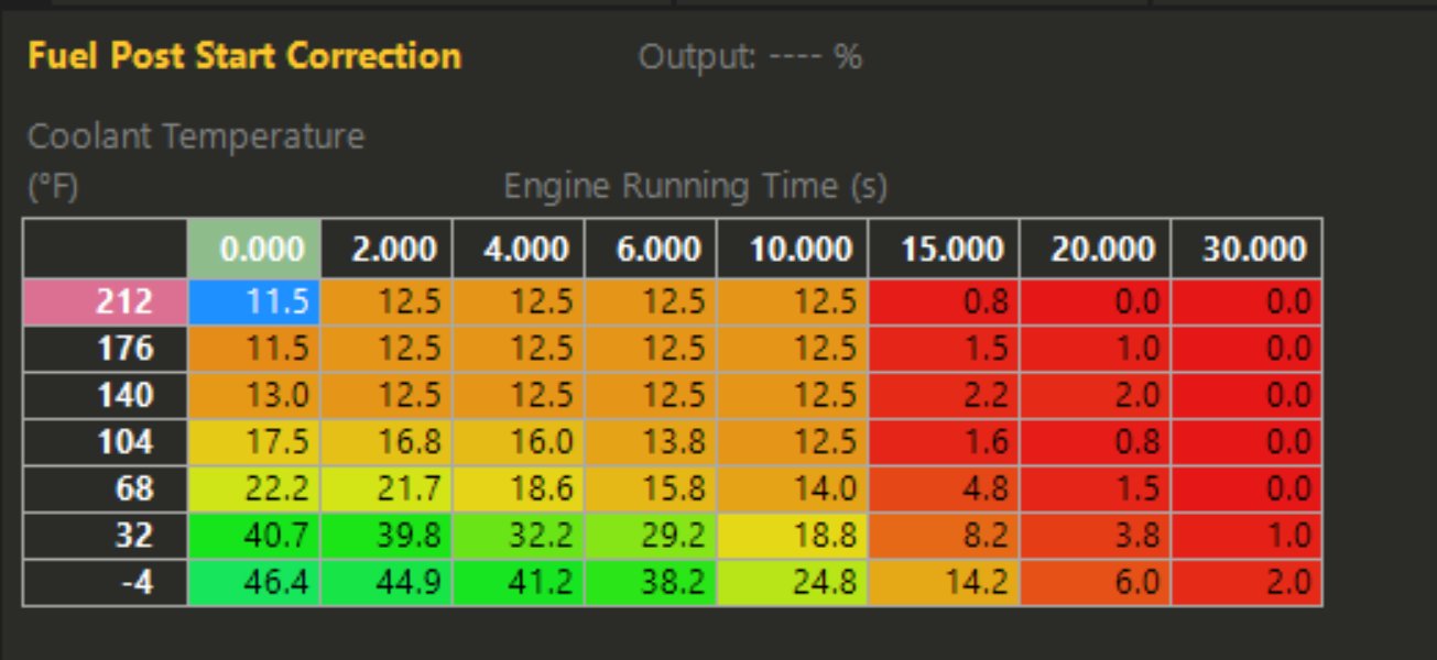

    So far the MAP has been good, but the only hiccup I've encountered is during cold starts. Once it starts and gets to idle, if I give it a blip of throttle it will stumble. It only does it like once or twice though right after the start and then behaves like normal. Assuming the values in the last two tables would be applicable since those are the only two with coolant temp as one of the axes.

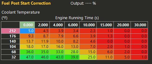

    Ever since this update I have been able to take fuel out of warm starts but my prviosuly bad cold starts are now perfect... Might need to add fuel to those on yours haha, the afterstart has a decay period that's what I changed.

    So you mean you made the changes in the post start correction table in your case?

    Yup, just a wee bit, how long is your decay rate though, might not make a difference if it is already really short.

    What decay rate are you referring to? There is an enrich and disenrich decay rate setting in transient, but those are no longer applicable with MAP

    Your post start map x-axis is time in seconds... unless you're increasing fuel over time (you shouldn't be) this is the time over which the post start added fueling will decay and your values set the rate based on temperature.

    Ah got it. That's what you meant by decay.
    Here's mine:
    looking at it now, not sure what's going on in the upper range there. Probably a leftover byproduct of when I was having idle issues in the initial tuning stage. I need to mess around with this table some more to try and finetune things.

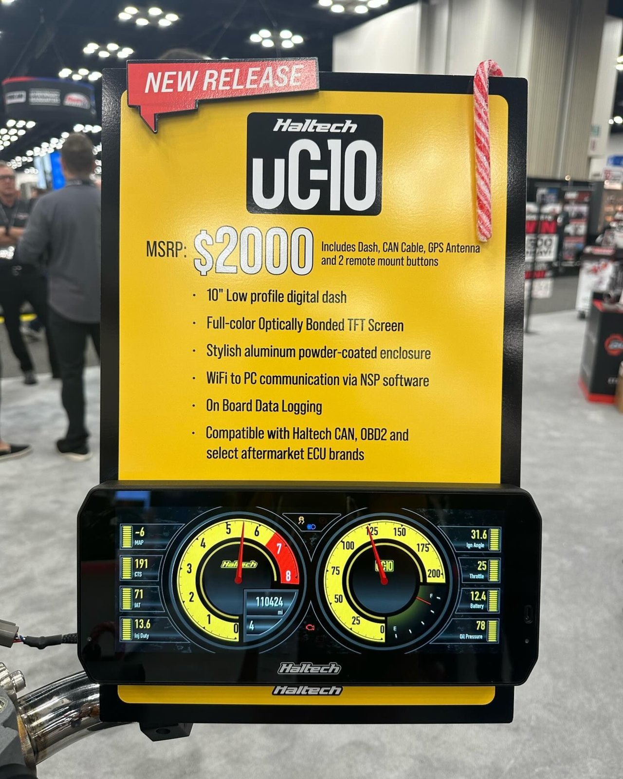

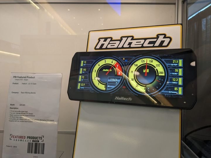

    Ah yeah there it is, called it!
    Looks like they contracted it out to AIM so it may not be as fully featured in IO and buttons as a IC7 tho
