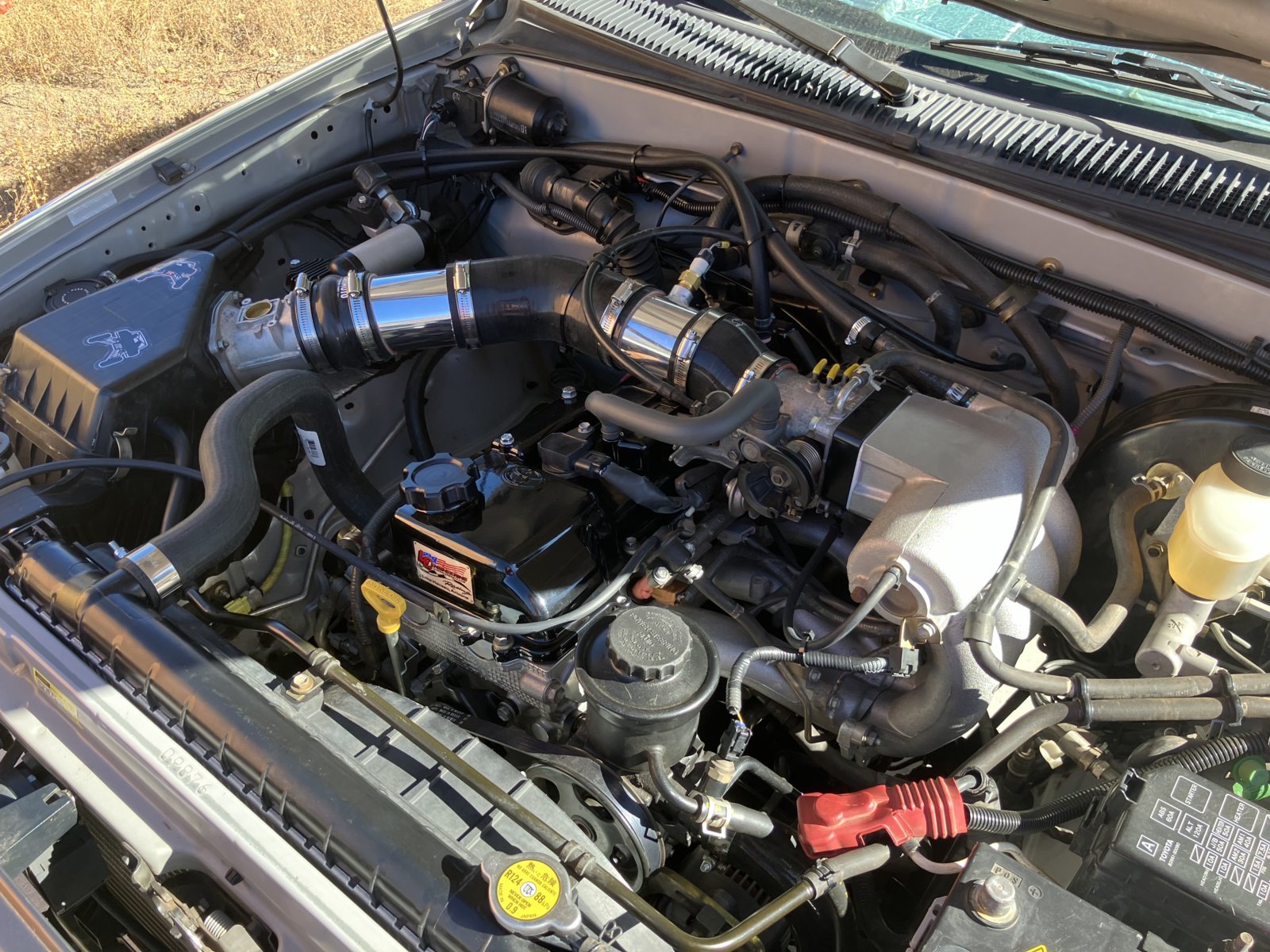

    For your idle surging, I fought a lot with that as well. IAC won't affect that. Gabe told me the same thing as far as it being something "mechanical". Similar to you; a lot of the vacuum and egr deleted.
    Eventually he gave me the suggestion to try a richer target idle AFR. I changed the idle target from 14.7 to 14.2 and that helped a lot after then dialing back in the idle base tables and base fueling. I started at 13.9 and then worked my way as lean as I could get it at idle before the surging came back.
    Not sure if your air intake is stock or not, but I have a 3" cold air intake with a 6in cone filter to let my SC breathe as much as possible. Can't say if it would have been the same with an OEM intake, but I would imagine it being a contributing factor.

    IMG_0028.jpg Thanks Ian! Im using the stock air box but i made a 3” inlet from the box to TB. Ill look at those numbers tomorrow and tinker around with that. Overall though, damn, different beast all together!
