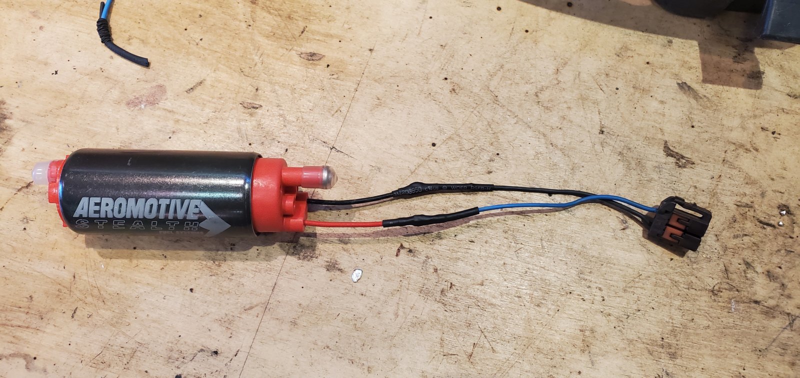

    Ya I'll bench test it once I have it out and contact them, but I need to get my hands on a replacement pump asap since I'm supposed to leave for KOH end of next week.
    Any suggestions? I'd order one online but good ole' California doesn't let you do that.
  10. Jan 15, 2024 at 7:10 PM
    #1250
    Speedytech7
    Feb 20, 2014
    #123587
    58,572
    FCQM+VG Cheney, Washington
    It's less Tacoma and more mod
    You can ship it here and I'll forward it on if that helps, I wasn't aware you can't get a pump sent to CA, it's not emissions equip. I usually get em on Summit Racing since everything usually comes from Sparks, NV it'll get here in a day. The 11542 I know fits well, I believe some of the guys on here run the AEM 340 pump too.

    Ah looks like it's just Amazon. I can get one from Summit.
    I think I'll go the AEM route since I didn't have great luck with that Aeromotive one.
    I wonder if it shorted out or something weird. I've seen talk on FB groups about the 340 pumps overloading the fueling circuit and overworking the FPR.
