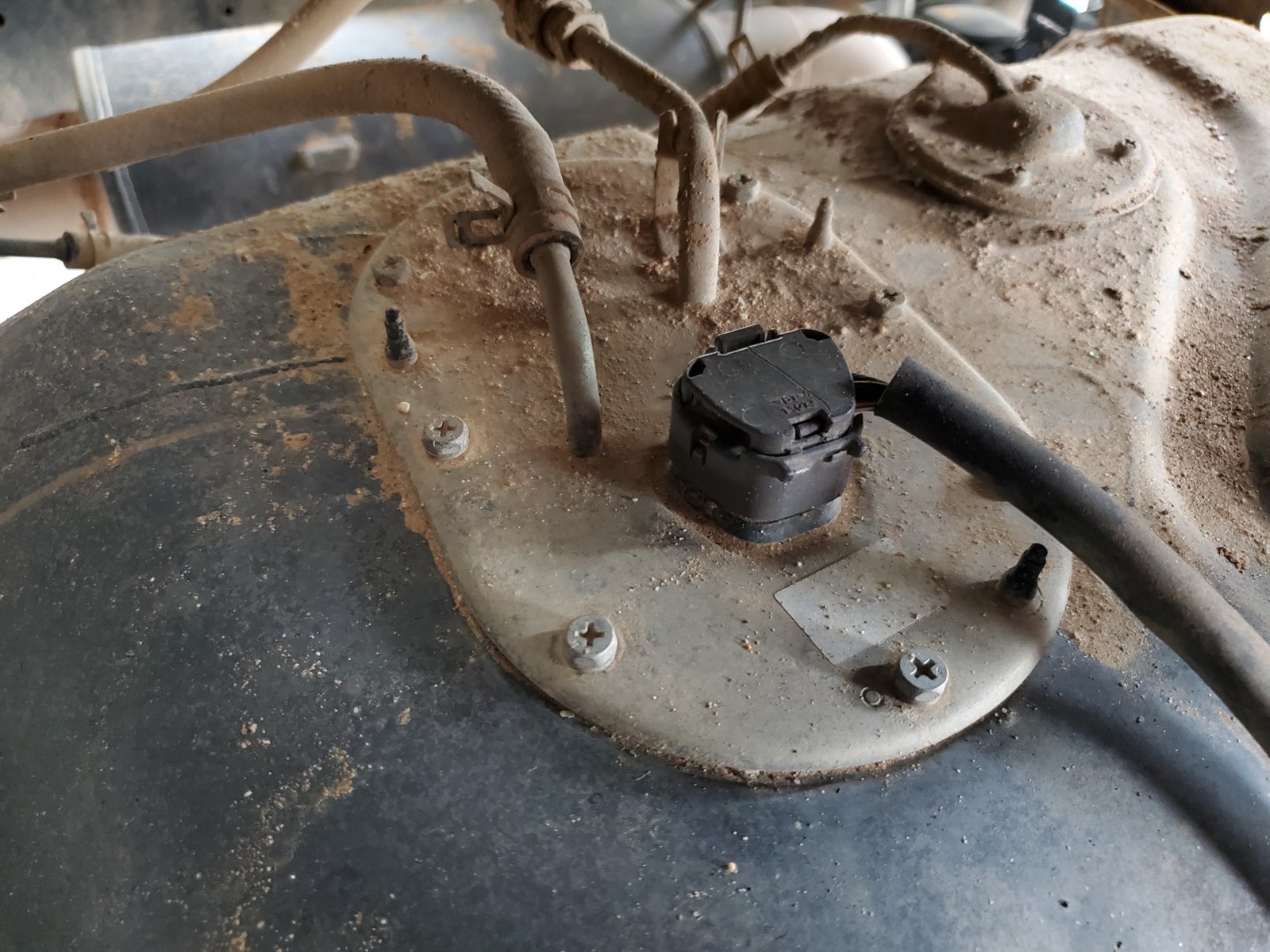

    Anywhere there's soft lines in the fuel system needs to be replaced with E85 compatible lines. that and of course an e85 compatible pump, but if you've already upgraded most are good to go.

    We only have one section of rubber line in the feed portion of the fuel system. I can't comment on whether or not it would last although it is designed for at least e10.... The return section is low pressure and you can replace the line super cheap so I would just do it, there a few sections of rubber line in that. I know you stated that you're not too worried about the price difference. But you do know that you have to burn more e85 then gasoline... Is the price of e85 more than 30% lower than regular gas
