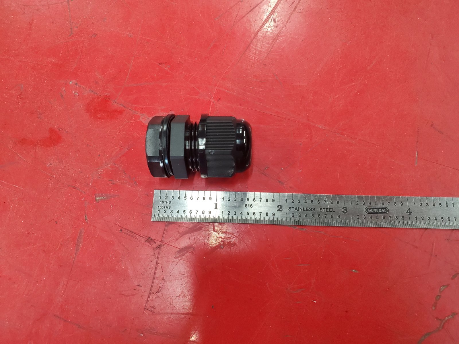

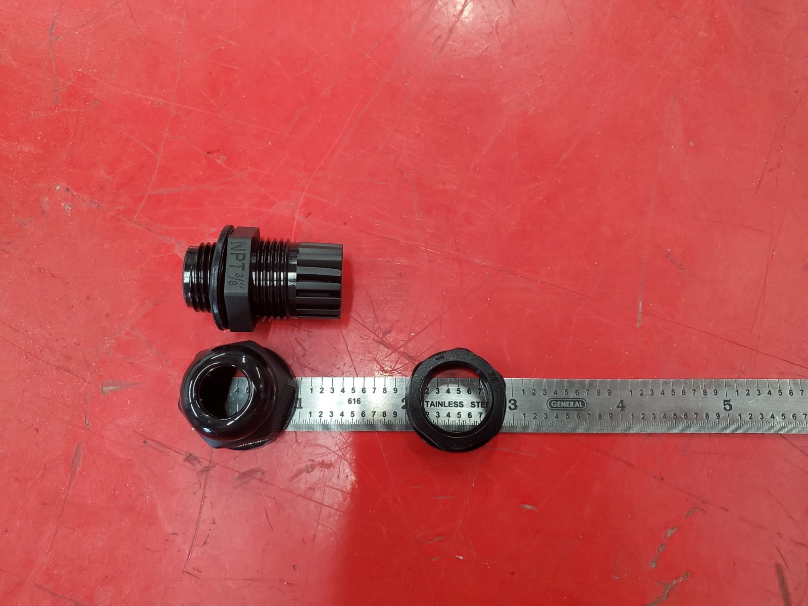

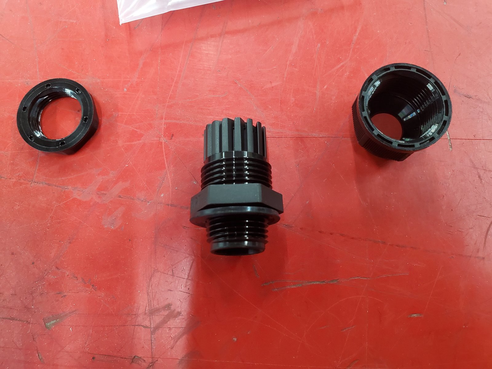

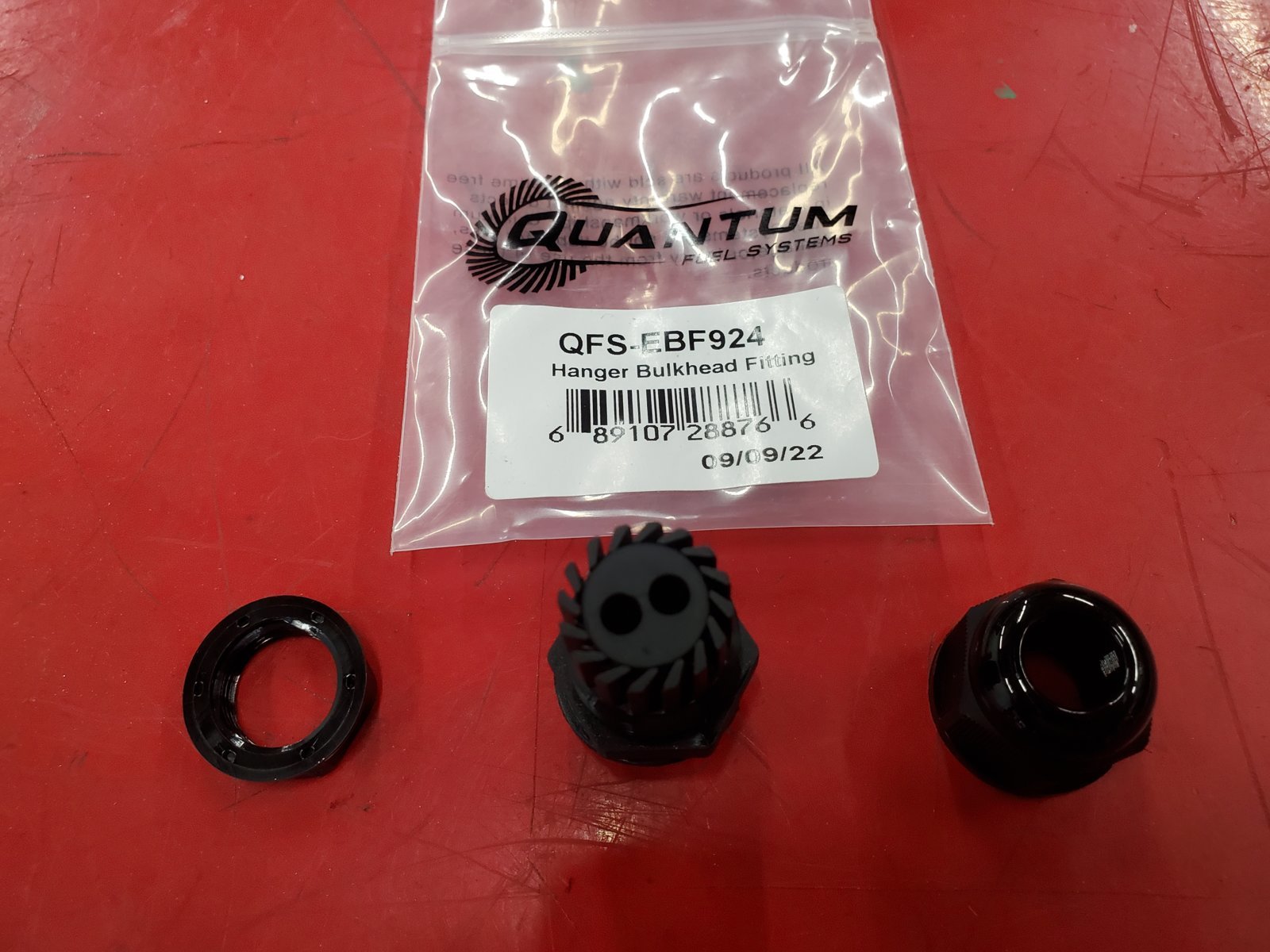

    Quick shipping on the Quantum bulkhead fitting.
    Largest diameter is 1". Overall length 1.5". Height above tank mount is approx 1.25" plus wire. Plastic is the material.20240129_095508.jpg 20240129_095520.jpg 20240129_095733.jpg 20240129_095806.jpg
