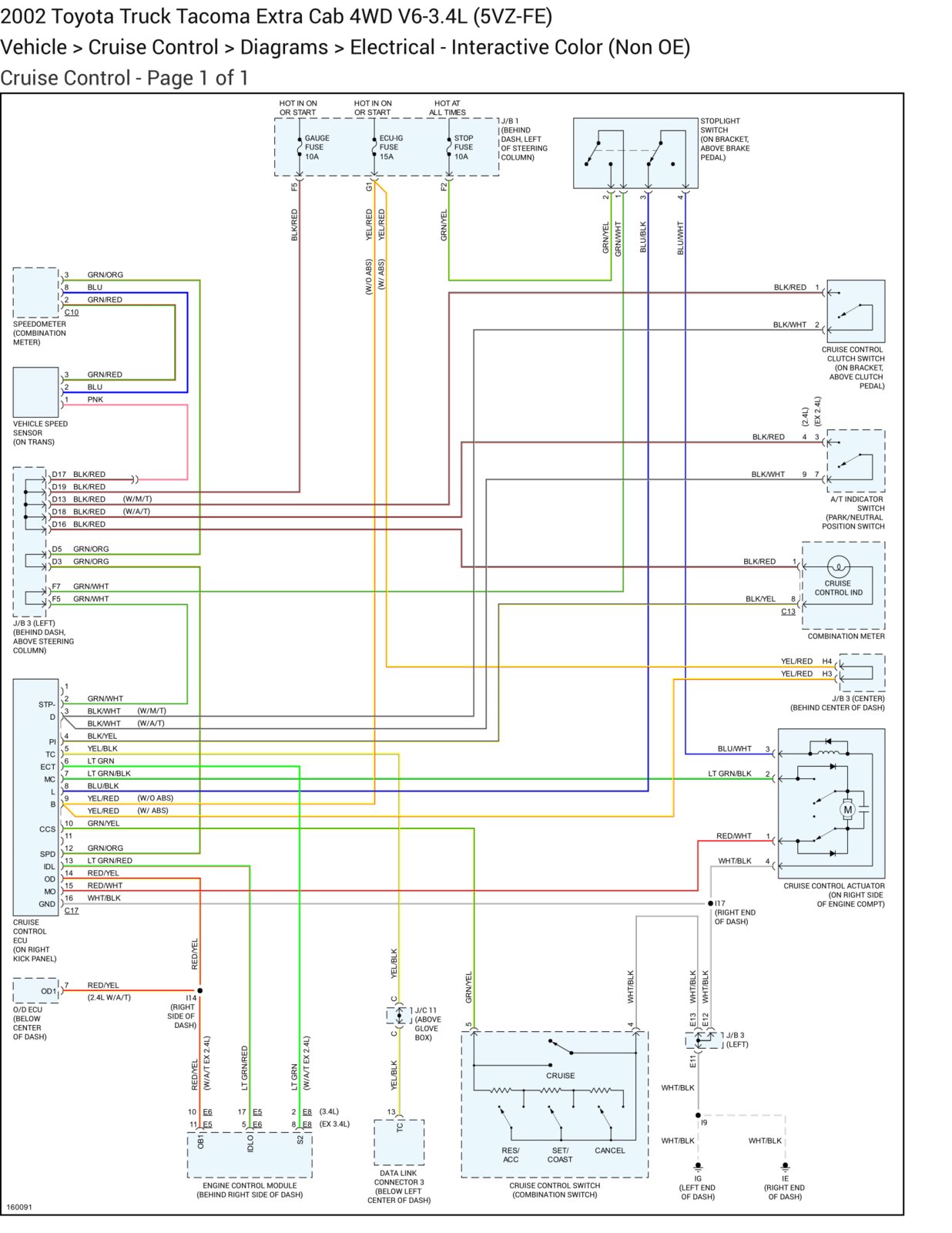

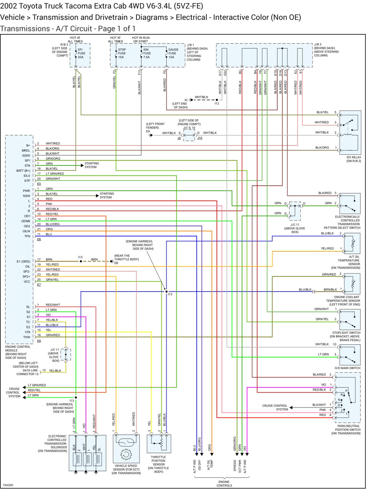

    Maybe you can figure it out, it isn't a problem on my radar other than this one truck because everyone else has a manual or no CC or both already. Here's the whole CC and auto diagrams, I suppose there could be a direct to trans connection or something, Toyota has been known to be weird like that.
    Transmissions - A_T Circuit (Transmission and Drivetrain) - ALLDATA Repair-1.png

    Ya between these, I can't see any reason it would impact lockup. You're 100% sure it's lockup?

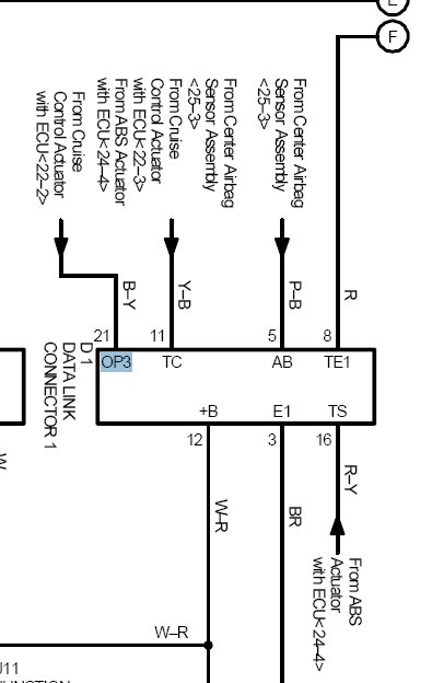

    I'm 100% sure it's lockup and I wonder if they're communicating on the data line. The CC and trans share the Yel/Blk line to the datalink connector...

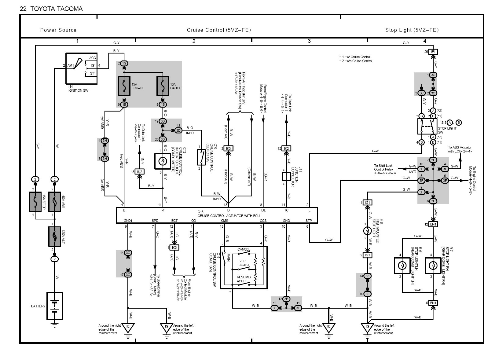

    I see what you're saying now.... hmm quite a mystery. To add to that, it looks like the different years change the data link connector reference (mine shows D1 vs yours shows D3)
    Data link connector 1's I/O seems to be TE1 to the ECU, with feeds from OP3 (CC), TC (ABS,CC,airbag, others?), AB (airbag), and TS (ABS). OP3 has no appearance on the CC diagram though :confused:
    That's crazy though, I had no idea there were other communication buses onboard. So you think there's a mismatch in speed reporting and the TCU side is probably interpreting that as an accel/decel and not allowing lockup?
    Edit: didn't 01 implement some sort of CANBUS? I notice you have TC on your ECU and I don't on mine. Now I'm curious if my '99s lockup might work if this bus comm theory is correct
