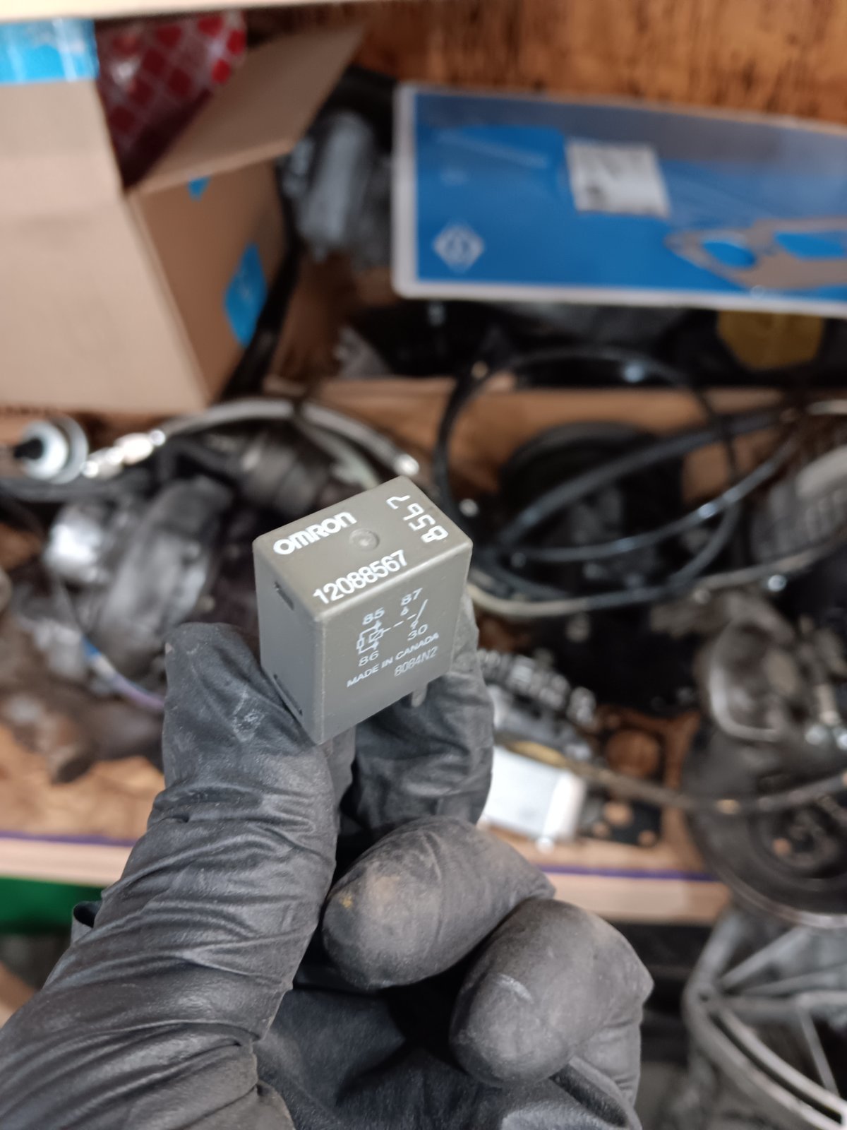

    I was wondering about this, but the guide I have saved says using 1A DPOs are ok?
    Also, our lockup solenoids aren't PWM right? Just on or off?

    I was told a lot of people ended up burning up their dpos. Because the sustained current can be higher that 1a and the inrush current is much higher. All the guides I've seen show using a relay pack instead. There's a guy that just did it to an a442 on mud and had to use relays as well. He used solid state relay so he can pwm the engagement of lockup and in the case of that one the accumulator solenoid.

    You won't have any problem just controlling it with a relay though you don't have to use pwm.

    Very good to know.
    I was thinking I'd use SSRs as well, just to avoid the constant clicking noise lol

    Just keep in mind they get kind of weird they need pull-downs. I'm not going to pwm lock up cuz it just doesn't matter on this application that much and there's no accumulator solenoid so I'm going to use omron minis and I'll probably just insulate the box so nobody has to listen to it though they should be much quieter anyway than a typical Bosch style automotive relay.

    I might just make a little PMOS perf board. 3x 5A each or so, low drive activate, throw it all in a little box and call it a day. Not really any need for an actual relay since there's no AC
