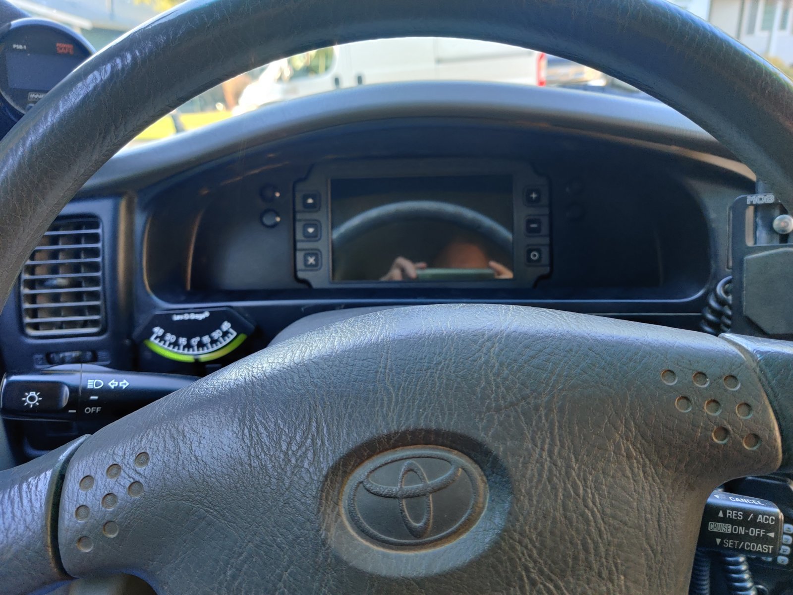

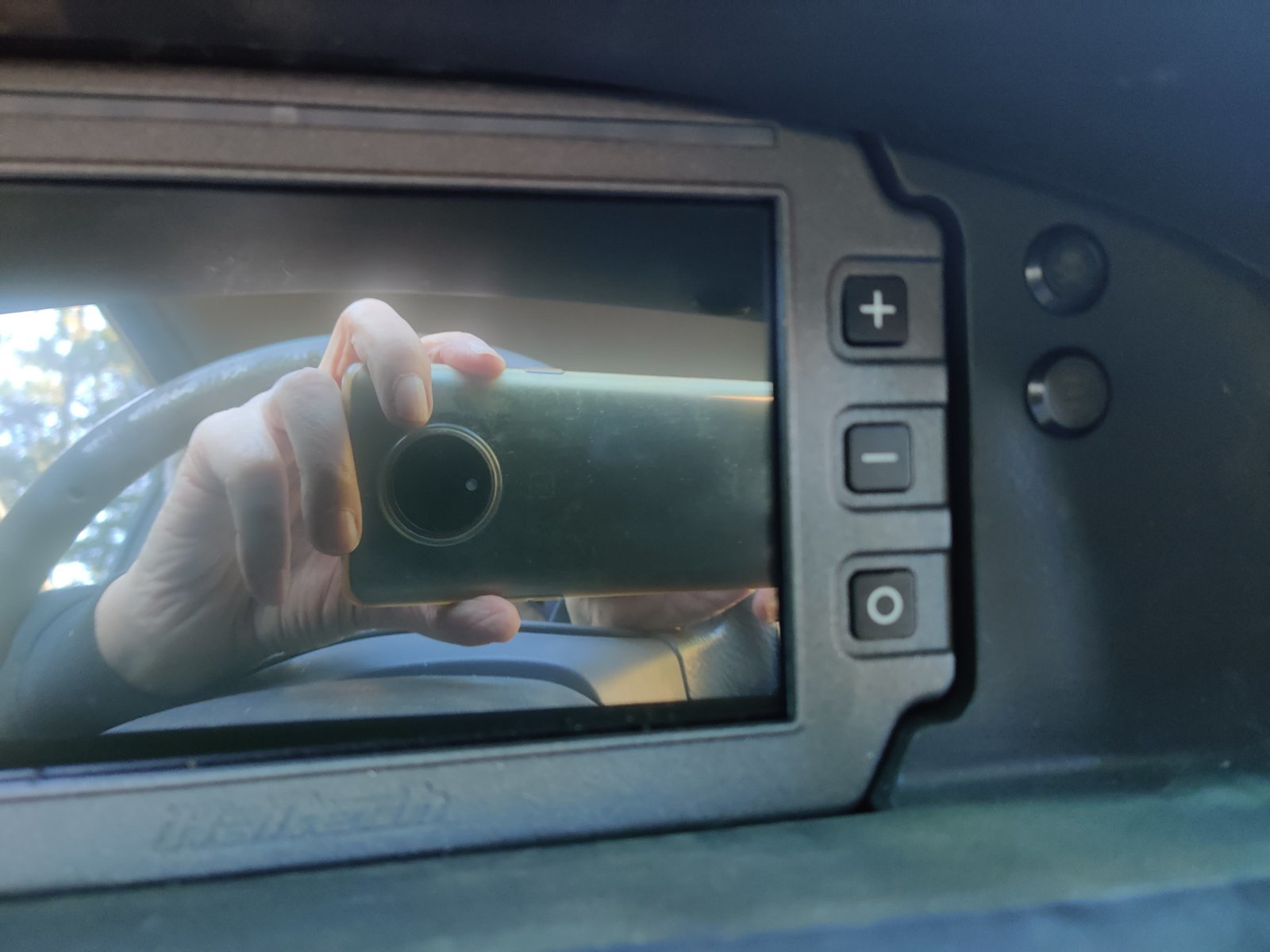

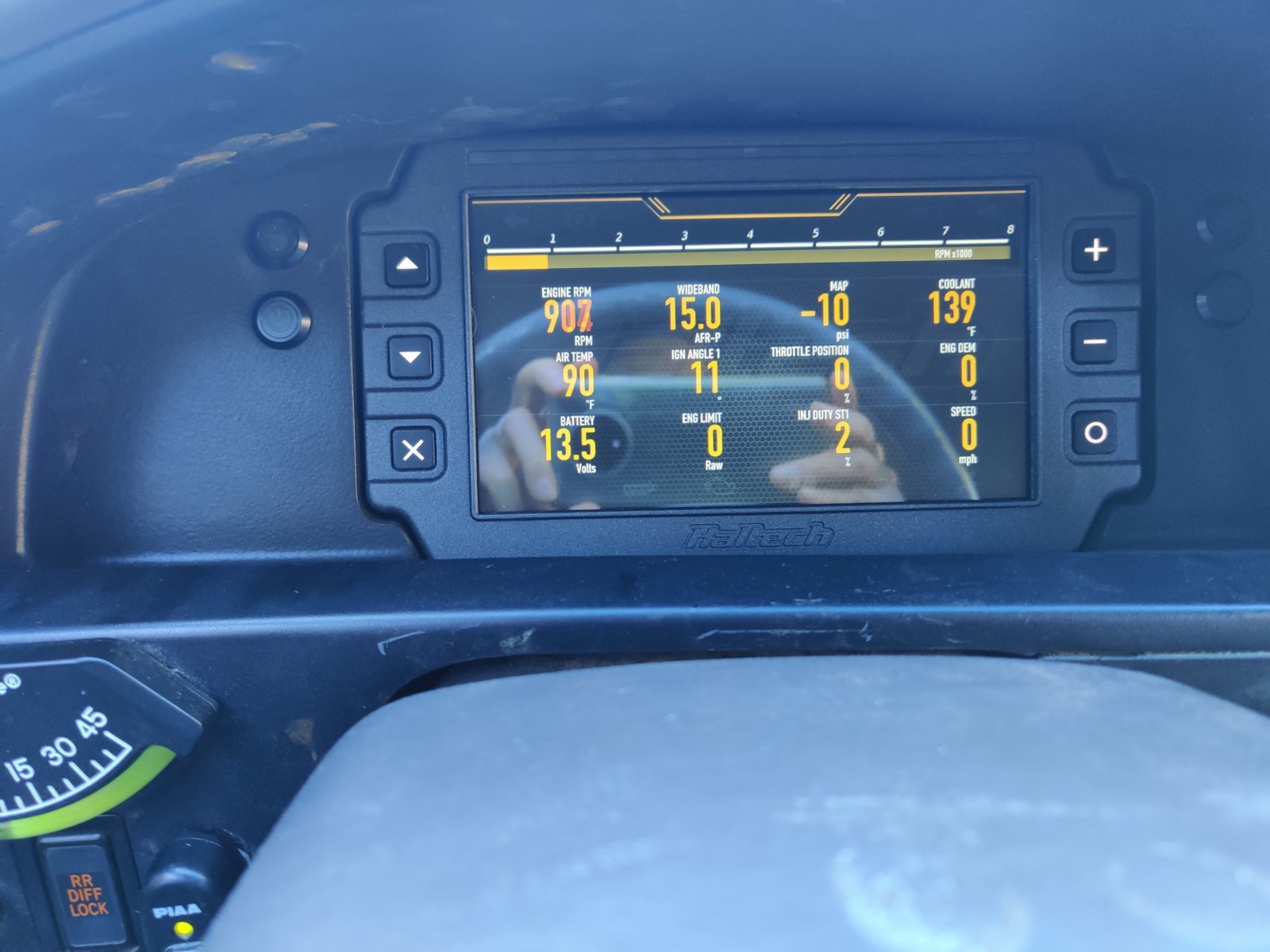

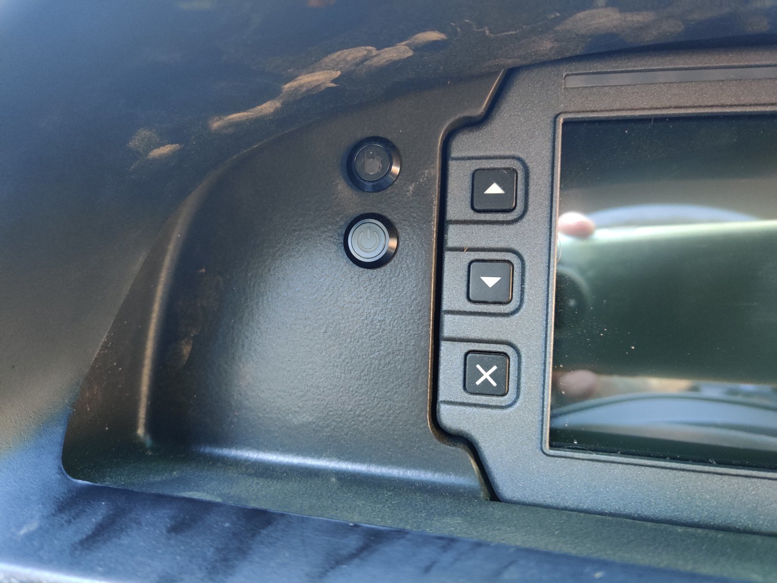

    I can do that.
    The IC7 is mounted in a Mako dash insert.
    IMG_20240315_173743.jpg IMG_20240315_173822.jpg IMG_20240315_173828.jpg IMG_20240315_174030.jpg

    That looks great. I'm assuming the LED lamps on the right are for the 4x4 and Rear Diff Lock indicators? What are the LED lamps on the left tied to?

    Correct. Good guess on the diff lock indicator. Mako did not have one for that so I improvised. :D On the left, one is a low fuel indicator and the other is a cruise control indicator which does not function ATM and was also an improv.

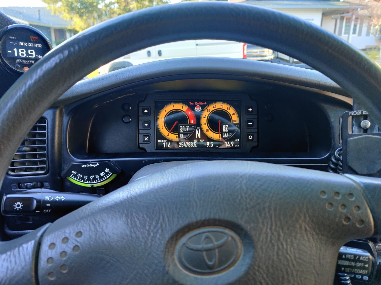

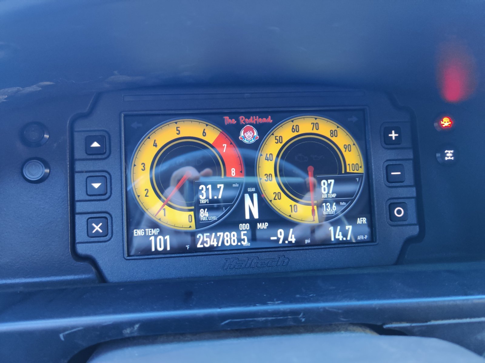

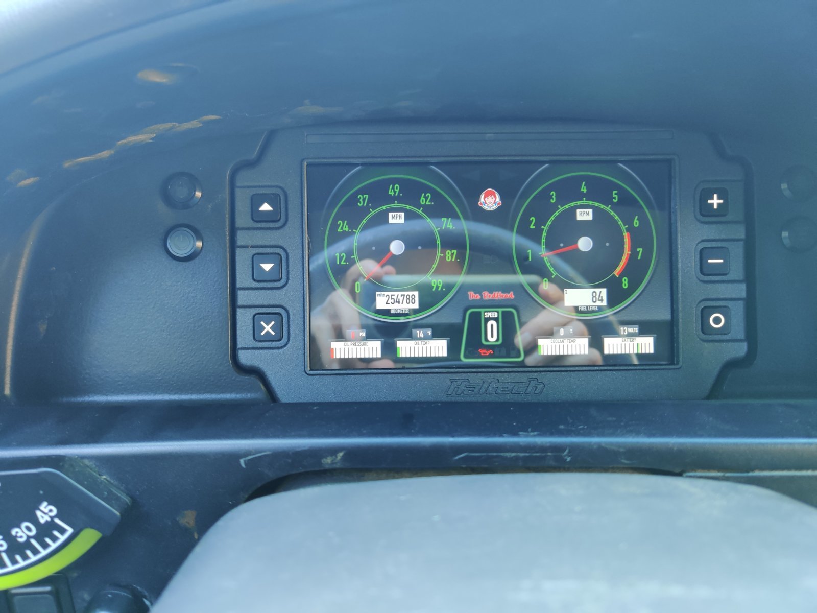

    Here are some of the available layouts.
    IMG_20240315_173948.jpg IMG_20240315_174106.jpg IMG_20240315_174129.jpg IMG_20240315_174200.jpg IMG_20240315_174208.jpg IMG_20240315_174226.jpg

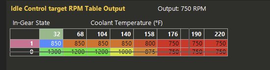

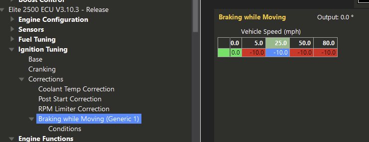

    Implemented this custom feature today, triggered by brake switch. I think I mentioned wanting to try it a few months ago. Noticeable improvement on slowing down at speeds, as your brakes are fighting the engine less. I might try more aggressive retard after a while depending on long term testing...
    Also changed the Idle RPM targets based on In-Gear state to stop the truck from trying to jump into intersections when cold (RPM targets noted from my Golf between the two states):

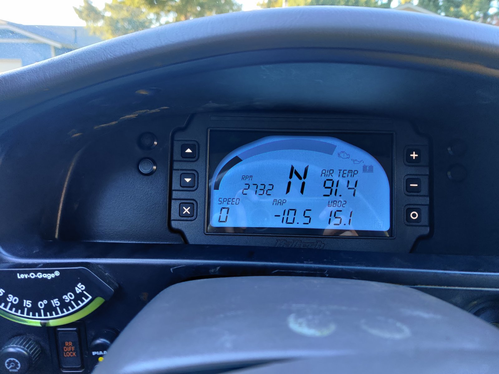

    Does anyone track their Home and Trigger misses? I'm still getting some hesitation around 2-3krpm at around -5inHg (light acceleration from stop). Wondering if the 3 Trigger misses I logged is what that was...

    I haven't had any other the the occasional single miss during cranking. My error count is only ever 0 or 1

    I figured it out - the brake sensor is being triggered randomly while driving. Probably because it was pre-wired to SPI2 and didn't follow the instructions of having a pull down resistor.
