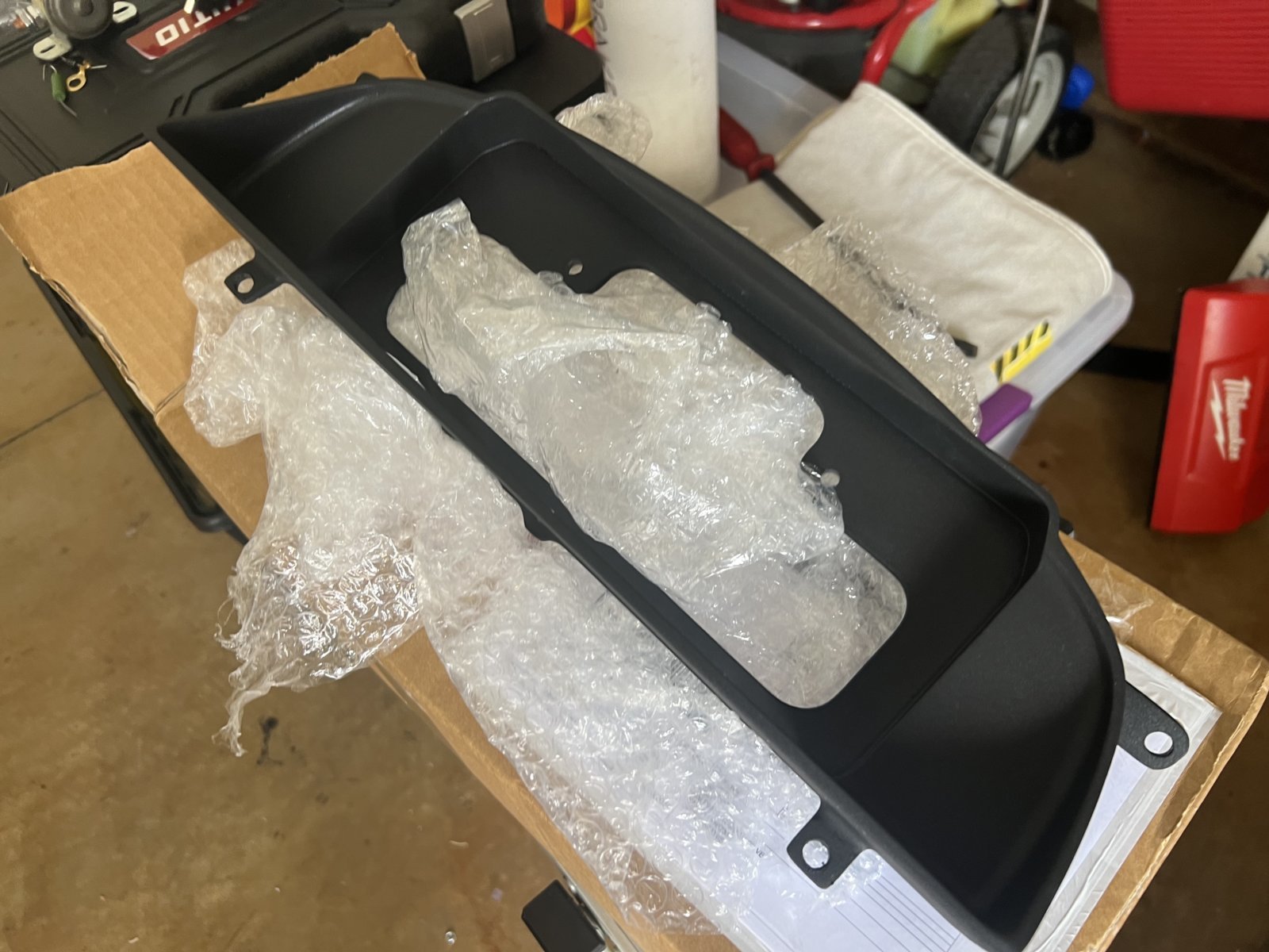

    Anyone interested in a Makosport Dash Kit for the Haltech UC-10? I ordered one thinking I would wait for the UC-10, but I ordered an IC-7 last week so I no longer need a UC-10 mount.
    Paid $300 shipped. I’ll sell it for $200 shipped to my fellow 1st gen Haltech user. Just arrived in the mail this afternoon.
