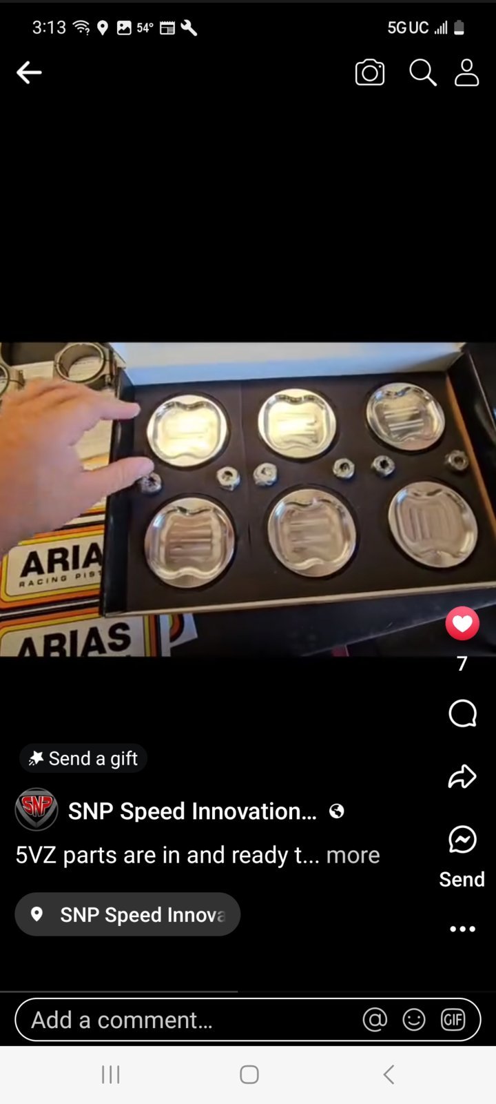

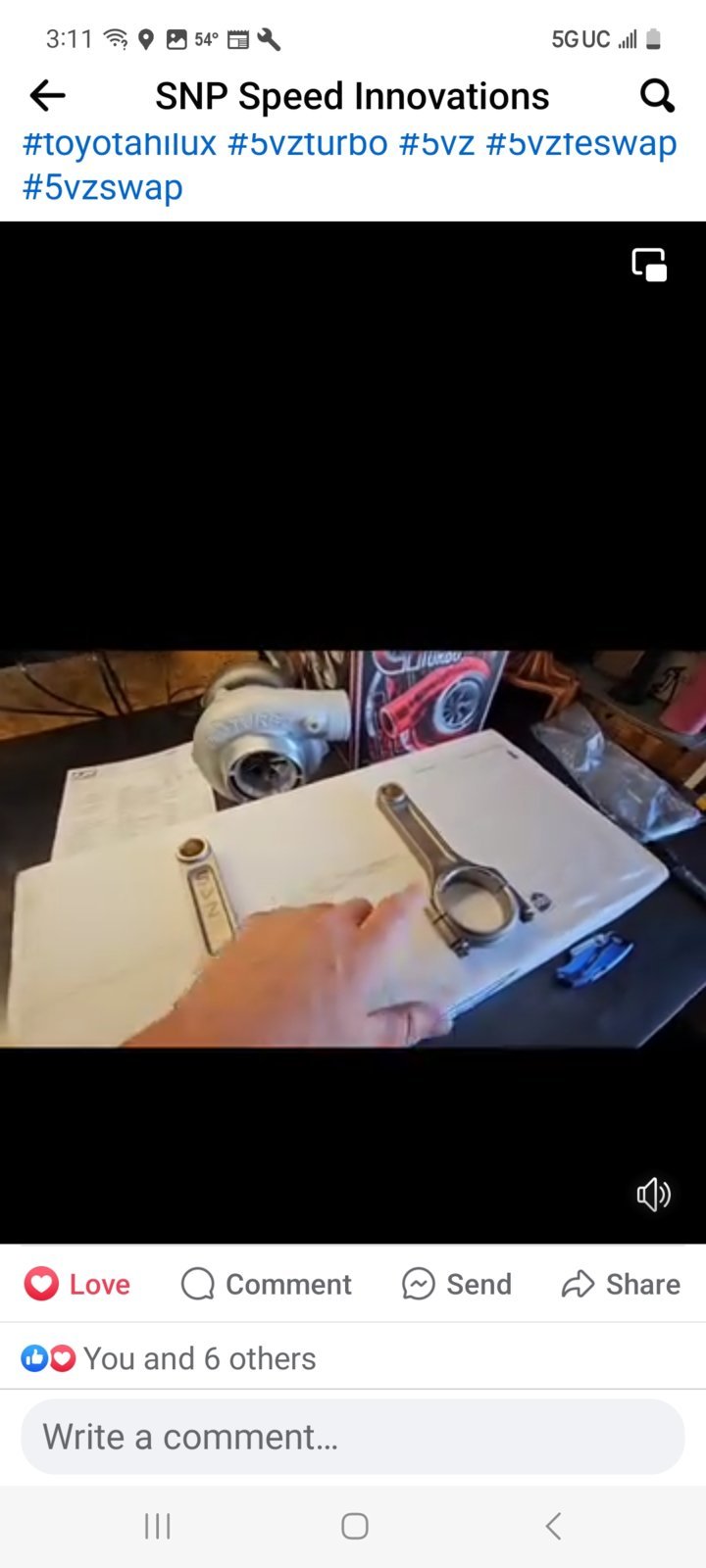

    What rods is he using?
    I still have Chinese manufacturers reach out to me once a year seeing if I want to order a batch of them (I need 5 people in for a group buy for the min order)

    I was thinking they kind of look like the ones that are available on Alibaba. Honestly there's probably nothing wrong with those I have to imagine somebody requested them for an engine with similar dimensions and these guys are just selling them on the side.

    I'm assuming unless the company selling them specifically says "Made in US" like Pauter it's drop shipped, meaning 99% of guys putting forged rods in their cars are using rods from China. That said, the price I got was extremely competitive and I'd be happy to contact them again if I got payment up front from interested parties

    I'd order the China rods. I have a Camry forged crank already. The Pistons are actually a blank space that's filled now. Now that I know I can get them from Arias that gets me to a built engine pretty easily. We just need to find an overseas cam grinder now haha
