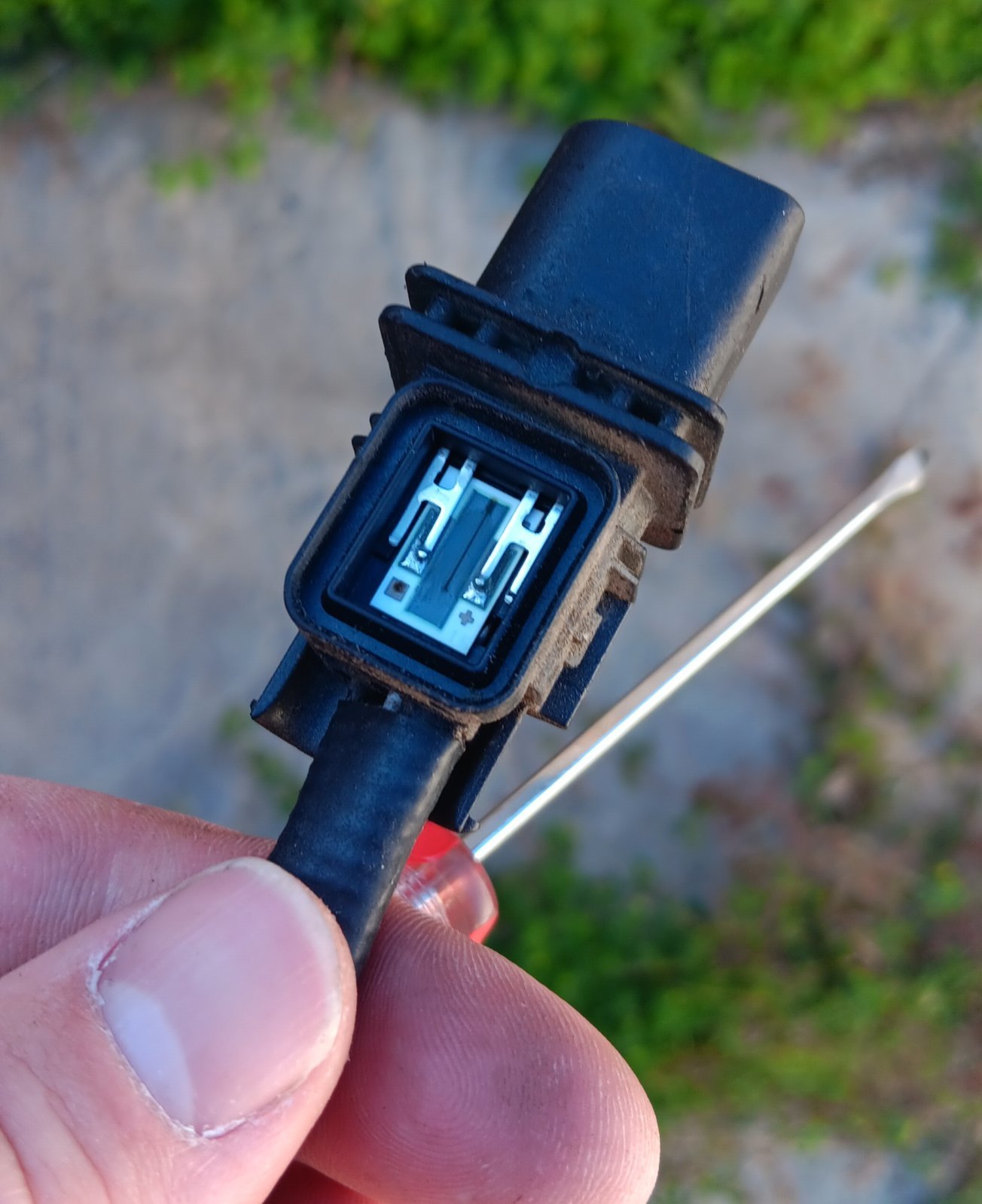

    For those of you who are having more frequent wideband failures maybe look at the placement of your wideband plug. Bosch style wideband sensors are calibrated at the factory and have a carbon resistor in the connector. Is the reason they don't need free air calibration like ntk sensors do but it also leaves an area for something to go wrong. This part of the connector is weather sealed with what looks to be a nice silicone o-ring but I don't doubt that it could get stuff in it if it's positioning was bad enough.
