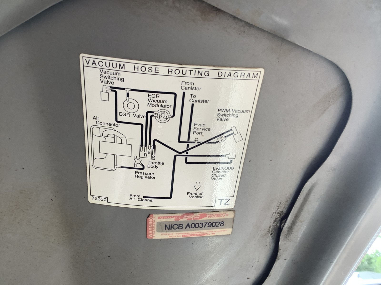

    I have a 2002 3RZ NA managed by a Haltech Elite 750. Non-emissions county and I have eliminated EGR and vacuum EXCEPT for the EVAP system. I don’t even know if the EVAP system is functioning at this point, but I get the feeling the tank isnt venting properly. Anyone eliminated the EVAP system here? If so how did you vent the fuel tank lines? There are two lines “To and From” the tank and I feel like just using diff check valves on each line, or some kind of check valve so I don’t lose fuel in case of a roll-over. Thoughts on this subjuct?

    Do you have an EVAP purge table in your haltech?

    Indeed. Duty Cycle (02 active and 02 inactive), Generic Correction, Coolant T Correction, Fuel Tank Pressure Correction and Wiring. Gabe @ SNP did the tune and all tables appear set-up.

    Should be able to add more duty, maybe based on pressure if you're smelling it since the charcoal can has a mechanical pressure purge that activates if the EVAP doesn't purge enough

    Thanks Speedy. Primarily I’m asking advice on eliminating the physical EVAP system and how to properly and responsibly vent the tank.
