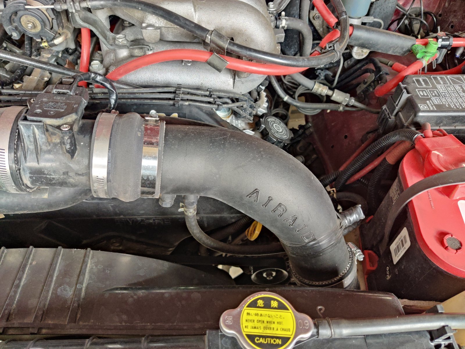

    I have 2 ports available in my reused Airaid intake tube but I don't know if I want to continue reusing it

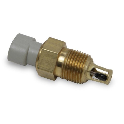

  17. Jun 26, 2024 at 12:55 PM
    #1717
    Speedytech7
    Feb 20, 2014
    #123587
    58,557
    FCQM+VG Cheney, Washington
    It's less Tacoma and more mod
    Open element one, like from AEM/GM has one that is commonly used/uh Haltech offers one, RIFE has some they claim are even faster than the traditional open element ones. Pretty much any one not entirely encased in plastic like typical 80s/90s era OEM ones are.

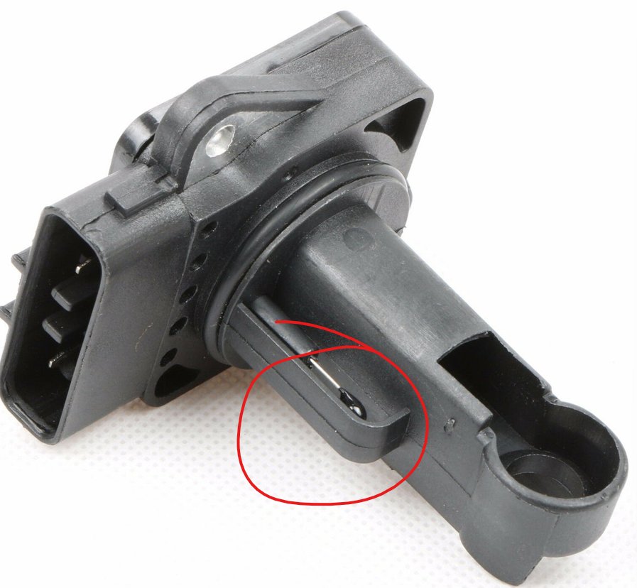

    Not seeing an open element AEM one - the one I do see says a 15 sec response time to 63% of the new value and has a visible bulb like the factory MAF
    The RIFE I'm not finding response data for comparison... it just says "ultra fast"
    I'll keep looking...
    edit: think the site I was on flipped the AEM description and images between the two
    unstpible likes this.
  19. Jun 26, 2024 at 1:32 PM
    #1719
    treyus30
    treyus30 70% complete 70% of the time
    Jun 24, 2015
    #158054
    8,406
    Trey
    Mesa / AJ, AZ
    '99 5VZ-FE Twin K03s w/Haltech
    Historic plates and 2 bar
    Wait, this is my MAF's style. This is the same style as the ones you listed excluding the RIFE....(?) I'm confused.
  20. Jun 26, 2024 at 1:35 PM
    #1720
    Speedytech7
    Feb 20, 2014
    #123587
    58,557
    Ooh that's interesting, you have a later style maf with a completely different thermistor than mine or the 4 banger one. Well that thing should register decent if you've got a good resistance curve for it
