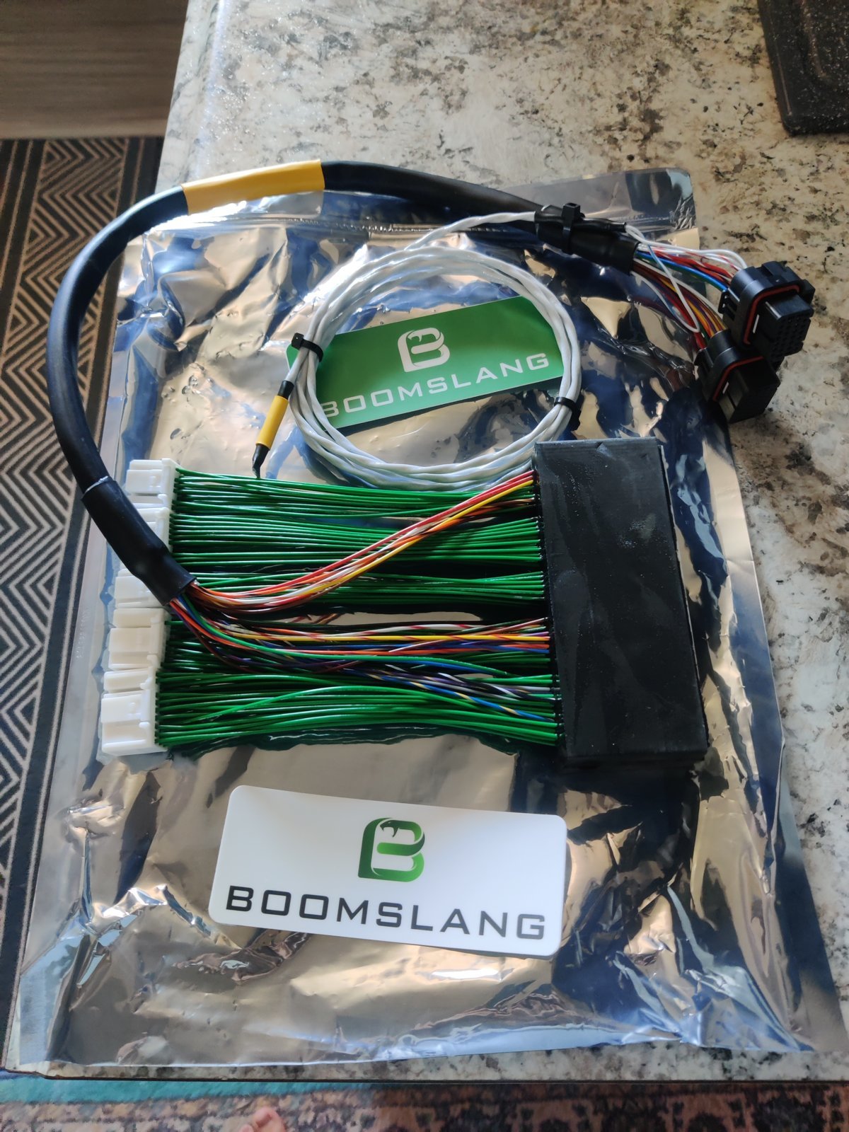

    I went for a quick 40 mile ish trip today and the O2 sensor wasn't reading on the Innovate guage again. It kept cycling the O2 heater on and being it's regular dumb self
    And then it came back but I don't know if I trust it at all. with that being said I did a small pull but stayed under 3psi of boost but while around 2 my AFR was showing around 14 still but it usually pretty good but being closer to 11 at that point. Maybe it's just not reading great.
    Then while parked in a drive through staring at the setting sun waiting for a hamburger and an obligatory oreo milkshake this evening my Intake temp hit 123°f at the same time the AFR was bouncing back and forth between mid 13's and 16's shortly after a got home I was watching the AFR and it was still bouncing back and forth between high 12's and low 17's. But the motor sounded like it was following the AFR so the sensor still seems like it's reading half decent.
    Don't the catalytic converter thrive from going rich and lean like that?
    I got the Haltech WB1 ordered just wish I would have remembered to order it at the same time as the ECU, I forgotten the 2500 didn't have it built in because of all the day dreaming about the R3.
    For those not following along my Little Red build the Boomslang harnesses arrived this afternoon
    Im starting to wonder if I could get it up and running on the haltech before the next Trail Hero event in Sand Hollow (early October).
    I've got a buddy who's been wanting to go for a couple years but it's not very wheelchair accessible so I'd like to take him and let the truck tires do the leg work

  16. Jul 10, 2024 at 7:57 AM
    #1796
    Jon64l
    Jon64l Well-Known Member
    Jan 12, 2016
    #174799
    1,691
    Jon
    2006 Tacoma, 2000 4runner, 1996 Tacoma
    You'll have it up and running in no time!
    I actually carried the stock ecu/piggy back with me on a couple trails incase I had any issue. Didn't need it thankfully.
    unstpible likes this.
