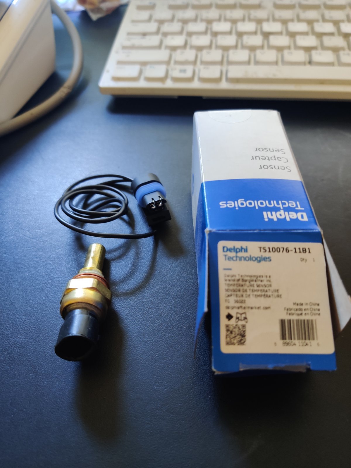

    I was also wonder how much one of those chevy LS coolant temp sensors for the Haltech might cost.
    Did you need to do anything with the smaller coolant temp sensor by the firewall? I think it's only for the guage

    For your specific application I would recommend leaving your MAF in place for the stock computer (trans controller) to get a load measurement and to leave the coolant sensor alone as well since your stock computer will still look to it as well. When it comes time for trans control, something I am admittedly short on time to work on right now, then moving the Haltech to a full standalone setup with differing sensors can be accomplished. The GM sensor is only like $13 by the way on rock auto and you can get the pigtail for it for another $3

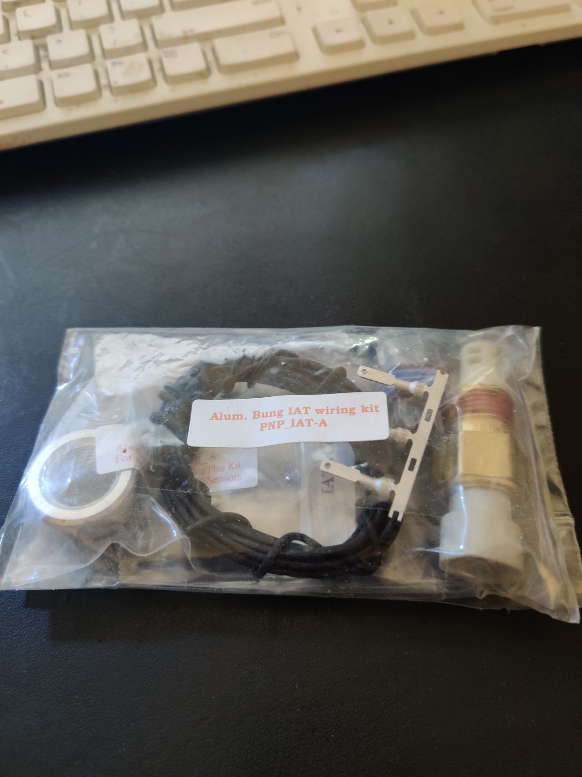

    Is either one of those one of these?

    It's the Delphi one
    Yeah but to use it effectively it would be worth wiring in a solid state relay to control the pump via PWM so it could produce a range of low rates and remove whatever controller/relay it has now. Just being binary would be tough at lower RPM, just too much spray.
