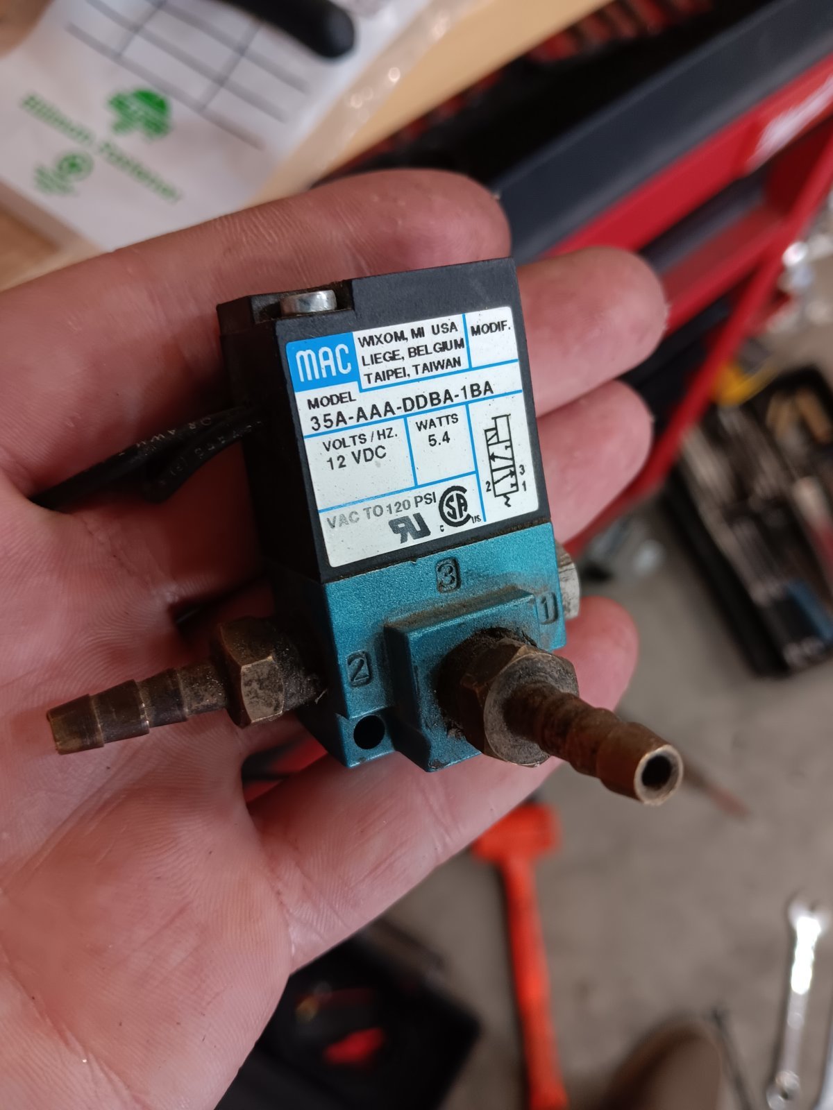

    :anonymous: what's PID?
    The boomslang harness came with a pair of wires labeled Boost Control even though I never mentioned having a turbo, hopefully they come in handy later on

    @unstpible
    Get yourself one of these ..
    unstpible likes this.

    I'm guessing they are only helpful with an electronic boost controller so I'll need to ditch the manual controller sooner than later which is fine, it's turned all the way down and not doing anything at the moment.

    :drool: it is done :spending:
