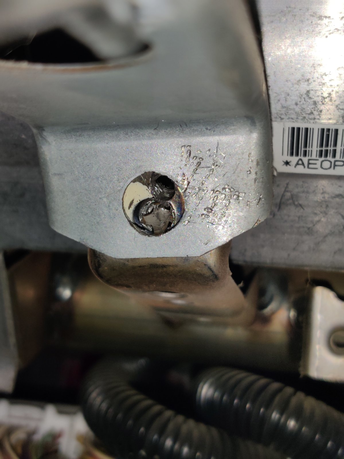

    You can tell it's never been touched.
    I guess that's why there was a random 7mm bolt in that spot

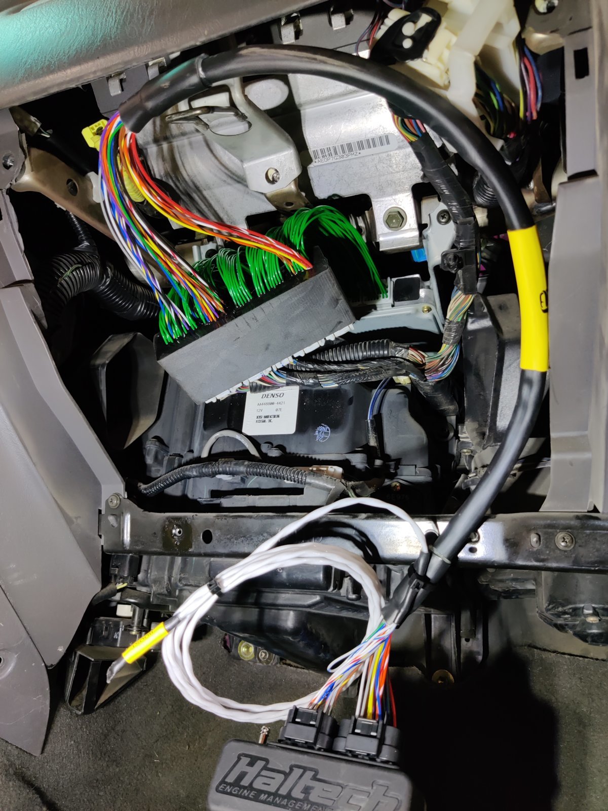

    Well I guess my dash clock is going to need reset...
    Battery is still disconnected.
    I'm liking the idea of a locking 4runner glove box to ad half a second worth of security in the future

    I got the 2500 directly from haltech. I did at least order SNP injectors.
    The only map I have is what Zane posted a while back for someone else and it's not quite what I need. There's a lot I don't understand so I don't want to make changes but I did power up the Haltech and open it up on NSP.
    It was 100°f and humid in the garage and my laptop got hot fast so I didn't stay out there long
    It's raining now so that should cool things off (and hopefully help the Cedar wildlife that started yesterday)

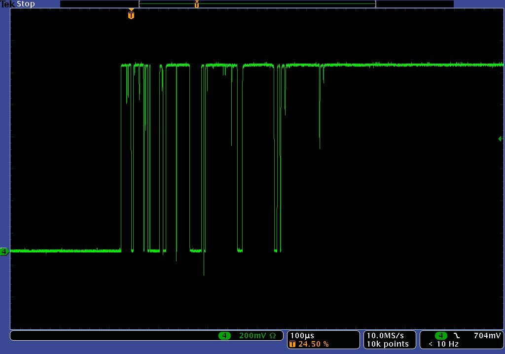

    Alright no speed sensor for now, the issue wasn't the sensor going high, it actually goes low but the switch is a reed switch and needs hardware debouncing. That's why it was picking up insane speeds it's the reeds bouncing on each other when making contact. Unfortunately there's no glitch filter for this channel built in.
    I'll make a simple debounce circuit but I have no capacitors on hand right now
